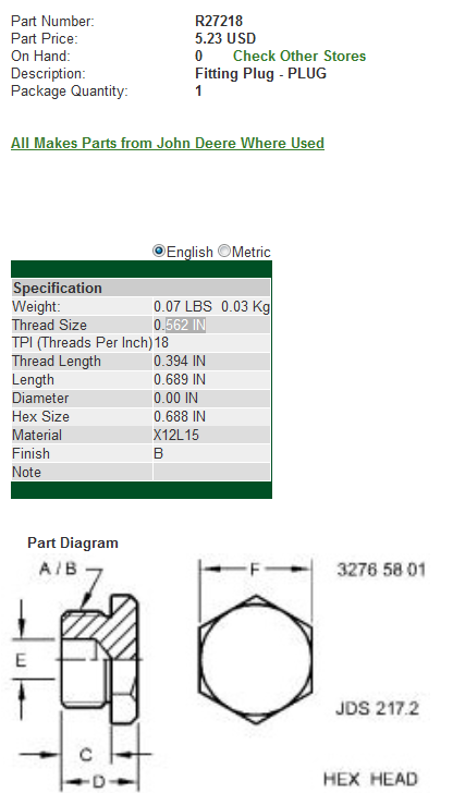

So I got the cover plate in but they didn't send a gasket so I made one out of an unused water pump gasket which worked no leaks. My challenge is coming in trying to find the right thread/size for the test hole. I bought about 15 different fittings to make sure I had the right one and I cannot get any of them to thread in without force. I took the plug to Lowes and I believe it's 3/8 20 but they don't sell 3/8 20 fittings. I had to use compression. I could get the plug to screw into the female side so I found a male to match but it will not thread in when I got it gone. Does anyone know the exact type and size fitting/thread.
   / Help, Jd 410 backhoe won't move fast #12
Are you referring to test ports on reverser control valve? If so the specs for plugs are listed below.

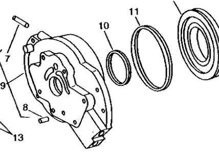

Where exactly on the reverser? It is not leaking on the outside so it would have to be on the inside of the reverser correct?
   / Help, Jd 410 backhoe won't move fast #17

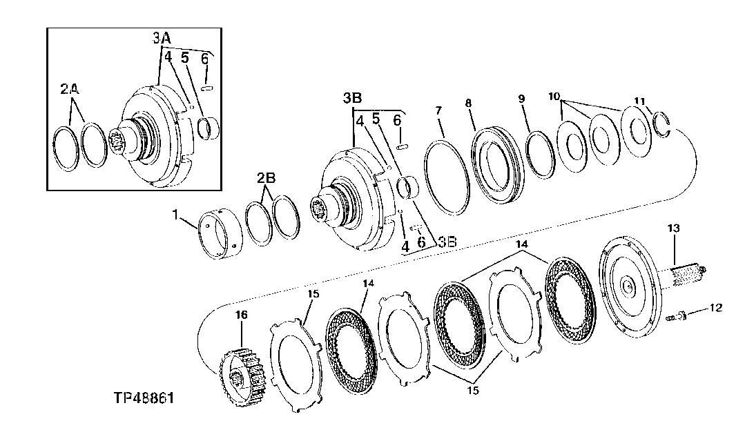

Hyd leaks will be internal. Reverser brake piston seals(parts key 10 & 11), Sealing rings on fwd clutch(parts keys 2A or 2B) depending on tractor serial number.
