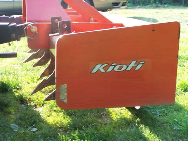

3 things: #1, the rocks you are hitting are TOO BIG. Just hit the smaller ones and you won't have this problem. /forums/images/graemlins/wink.gif
#2, I've not seen the "30 series" Midwest blades, could you post pictures here so we can see what you are talking about?
#3, could you also post pictures in the following thread? Box Blade Photo Comparison thread

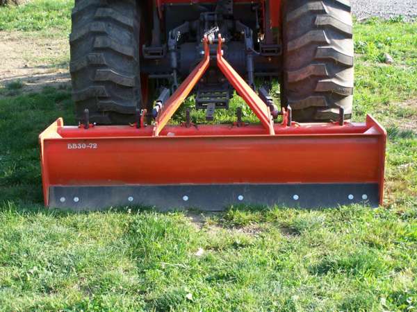

back
/ Help, I'm losing my teeth
Re: Help, I\'m losing my teeth
side with missing teeth

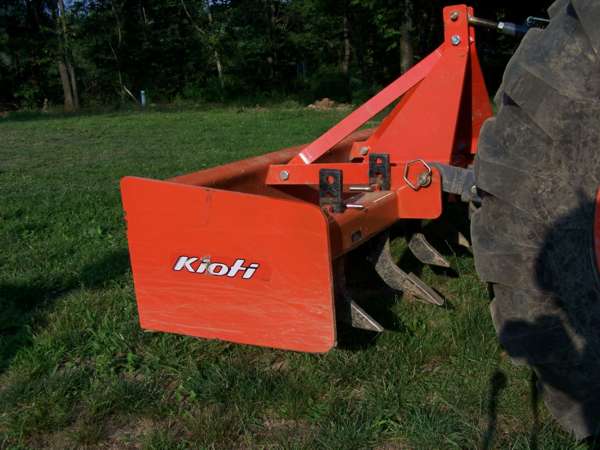

other side, fuller shot
