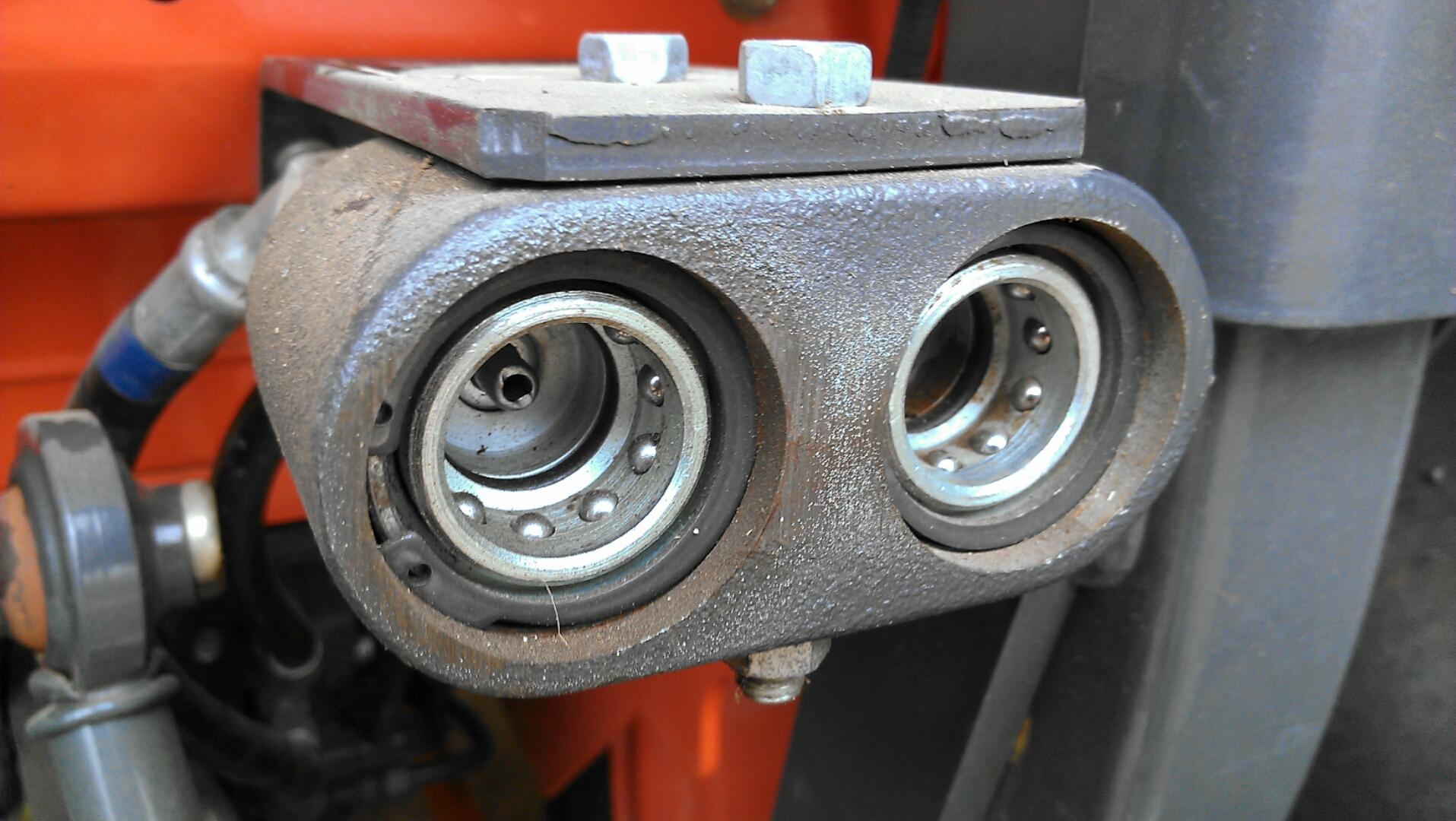

Can anyone tell me what 1/2" male quick connect I need for the remotes on a 2007 Kubota L4240? My Kubota dealer sold me the standard Pioneer nipple type connectors, but there is almost zero flow thu them. I don't think they know what I needed.

Thanks for the quick reply.. I bought the tractor used, so I'm not really sure, but they look factory installed - except for the unusual female quick connector. I've never seen one with the hollow 'pin' in the center. If I can't find the correct male side, I guess I could just remove the female couplers from the clamp and replace them with the standard Pioneer poppet type.

Get the poppet type male ends and you should be good to go. You have the factory Kubota outlets. ;)
/ Help identily male quick-connect #5
Looks just like the ones on our L3830 which takes 1/2" Pioneer couplings. Works with either ball or poppet style connectors.

I also thought the picture looks like the standard Pioneer Ag type to me. What are you connecting via these fittings? The listing below shows 12 GPM flow on every style. 12 GPM is plenty if you are are just activating cylinders. How many GPM does your pump have?

This is what they are...just the typical modern "universal" quick connects. Get 'em anywhere.

The OP did not say that his didn't work, just that they didn't flow very much. He has the ball type ends and if he would get the poppet type ends the flow would increase.

You might have a flow problem independent of the connector compatibility...either in the female connectors themselves (or one of them) or in the lines or other plumbing.

I think that with the inconsistency of the manufacturing (tolerances) that some work well, some work and some do not work. The ball type ends is what I use to sell with all my hose kits. Seemed like 10-15% of my Kubota customers would have some sort of problem. I went to the poppet type ends, no more problems. ;)

If you are worried about flow being marginal, just upsize the QD to prevent any restrictions.
Most charts will show that the poppet type QD will have a better flow rate, and less pressure drop.

Sometimes the stroke on the poppets/balls are not limited, so when connected, one will be way open, and the other nearly closed, and unfortunately, flow tends to shift that balance even further. So, sometimes it is helpful to get coupling halves from the same manufacturer so the spring force pressing on the poppets will better balance. If it is not possible to get them from the same manufacturer, just make sure when you press the poppets / balls by hand there is not a major mismatch in spring force.
Same issue with the ball style, I don't even stock them anymore. ISO A poppets is all we use for this connection. CJ
