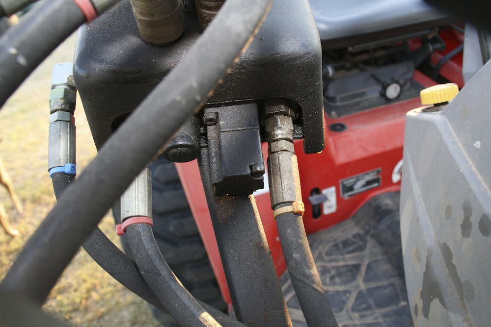

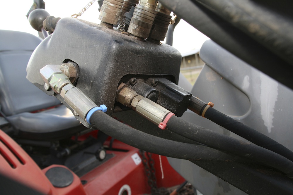

Hi,
I just mounted a hay bale grabber to my Massey Ferguson 1532. I'm trying to tap in to the hydraulics to add the grabbers hooks.
Can someone help me identify which of these is the hydraulic feed and which is the return.
My grabber control valve has an in and out, and I know it needs to be in series with my existing hydraulics.
Here is a pick with color coded ties on it

Hi Pony - Usually the return is the thickest hose - looking at your photos my guess would be the side hose (blue). However this is only a guess!
Do you have any more info - such as the make of the loader?

The red one is definately a return...
From the photo it appears that both the blue and yellow are seperate feeds (one per spool maybe?) - but I think you definately need the advice of someone who is better experienced than I am to be sure :laughing:
Keep your eye open for user JJ - he is great with Hydraulics...

I take it you added a "T" in the pressure feed line??......That won't work, the flow will take the path of least resistance and flow through the valve you are not using.....that's why the grappler will only work with the lift is operating.....this has to be in series to work on an open-center system
Do you have pix of your new valve
With the original question, the feed line on your FEL valve is on the same side as the pressure relief valve...(not shown in pix cuz of plastic cover).....

If you pull the cover off your old valve, I think you will find that the ports are identified by castings cast right into the body. I think yellow will be "in" and red will be "out" or "tank" and blue will be "power beyond". The "power beyond" is the only thing that will be changed on the old valve. It needs to go to the "in" on the new valve. And then the "power beyond" of the new valve needs to go to where the "power beyond" of the old valve used to go. And the "out" on the new valve can be T'd in with the "out" on the old valve.
The link you supplied for your new valve does not appear to have "power beyond" capabilities. And you will need a valve that does.

If the valve you installed is an open center valve with PB, then it should work.
Your FEL valve, with PB, will have 7 hoses if it is operational, to connect additional valves.
If you the connect the new valve ports correctly, they should work.
