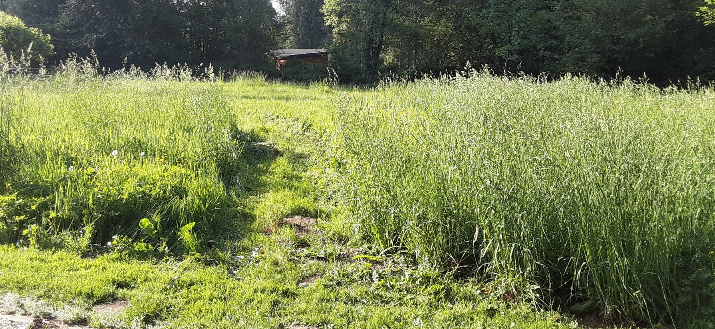

I replaced the bearing which was badly grinding and the new one is much better. After reinstallation I noticed the clutch sort of drags as it rotates so it's clearly not quite straight. Having it reassembled already, I decided to install and see whether it would keep the blades spinning or not be an issue. Prior to adding the deck, I used a calibrated stick to see if the clutch would stop with enough resistance (it did). With the deck on and the clutch disengaged the blades are stopped but the deck engages without issue. I noticed the mandrel brake pads are pretty worn so I may have to replace them at some point but right now I'm pretty happy with my free DLT!
I mowed along the street which only gets touched once a month or so and my 17hp LT1000 struggles. This one had no issue. I ramped it up to thicker grass and eventually took it out to my field that I normally run my 30hp NH compact tractor with rotary cutter on. The DLT ran through it like nothing even though the grass was 5' tall!
