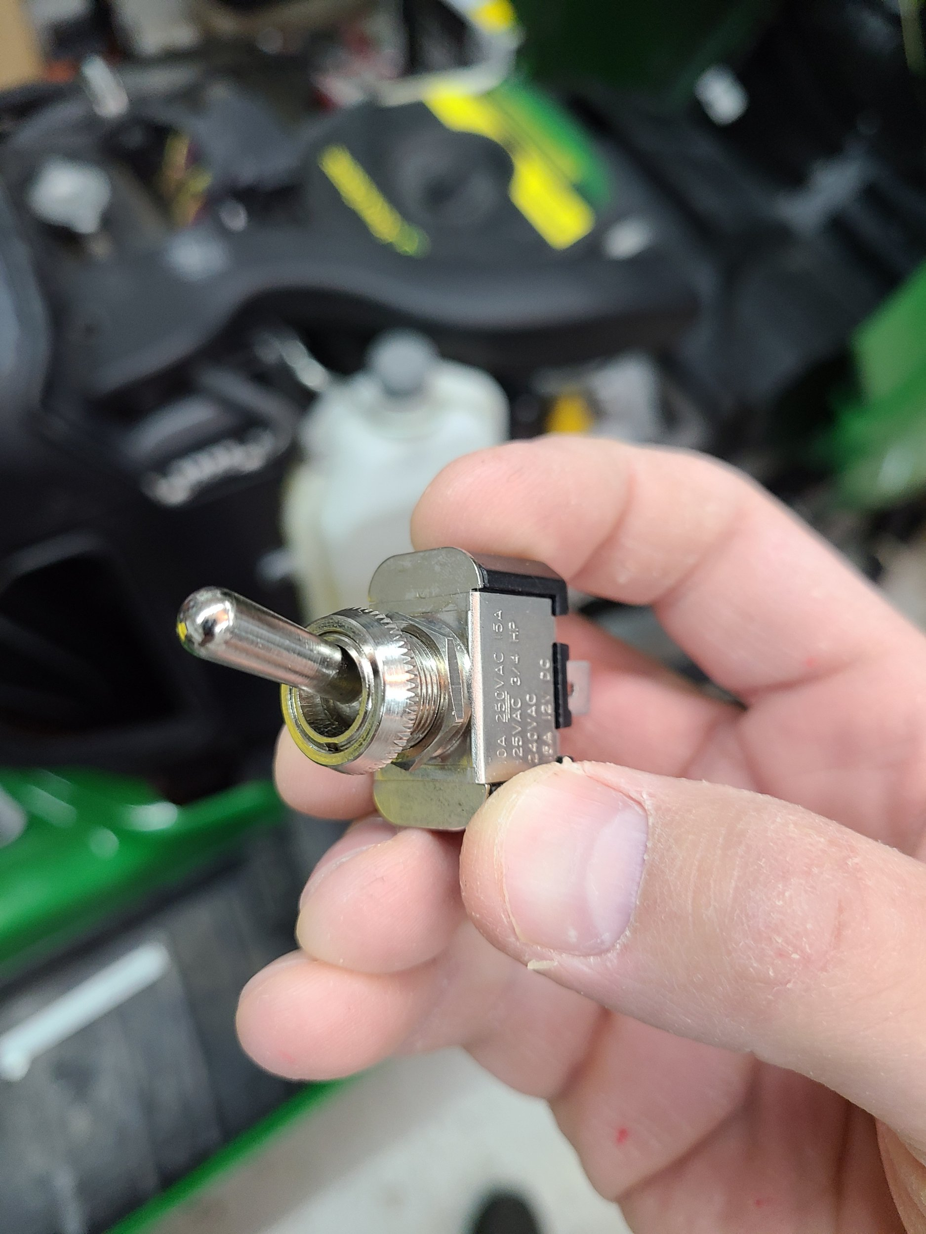

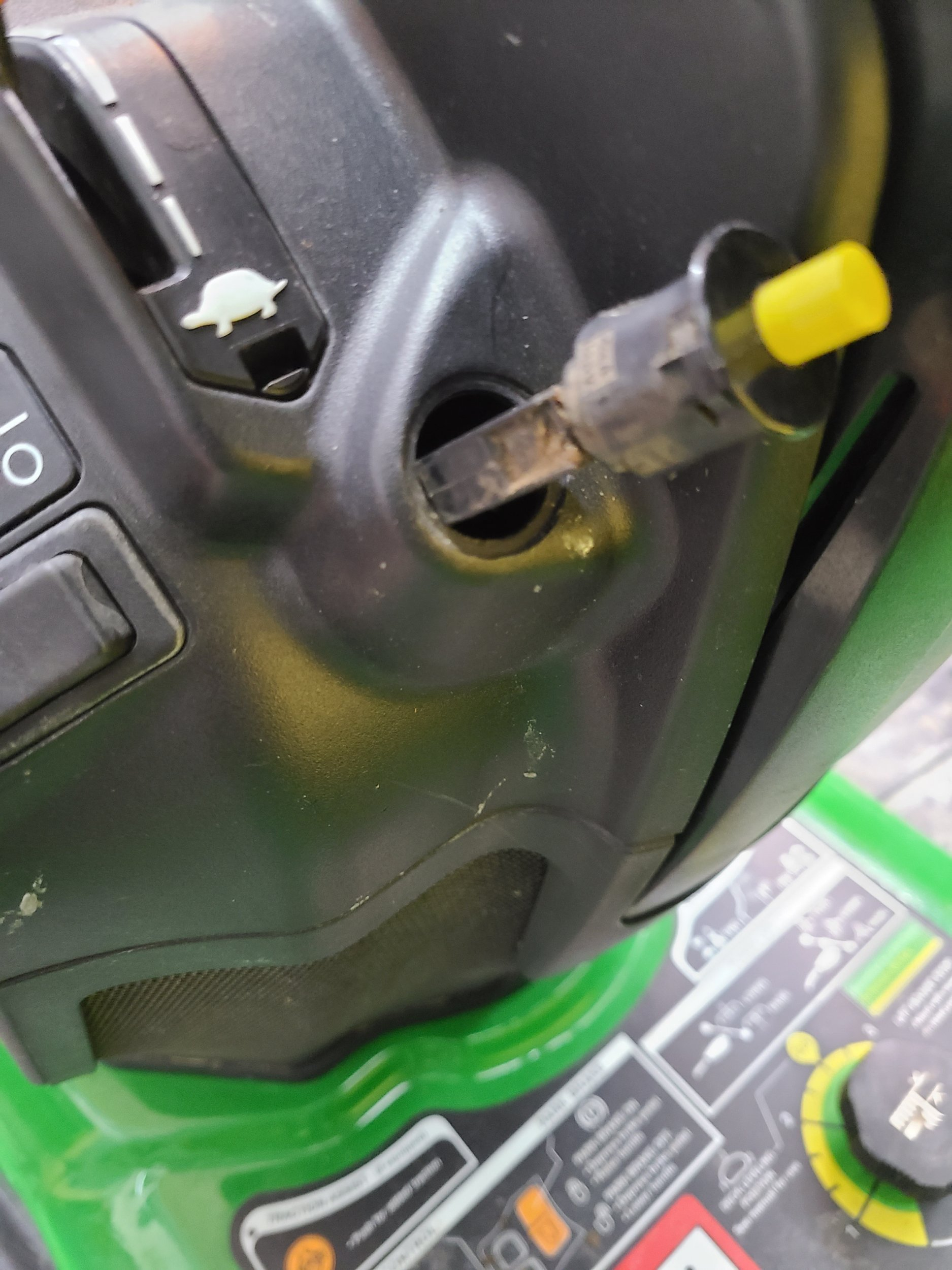

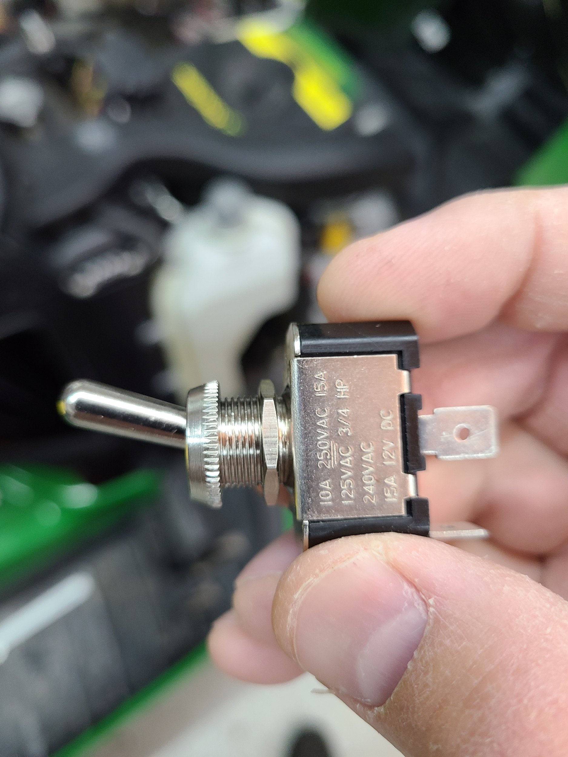

This is the switch I'm using. The threads are at 14mm, and the hole is 17mm. I don't have alot to make up. But I'm realizing I can't fit this. The clearance behind the hole is too small. I was hoping to get a marine grade switch, but my clearance inbthe back would very tough. Would I need a marine grade switch Thoughts? I snowblow and will use the machine in light rains. Thoughts?

Does your tractor have any blank holes where you can install a factory switch? My Case DX35 had some blanks where I could put a factory switch for an LED light bar.
/ Help Finding a Switch #12
I would not use that switch in a application like yours. You need a switch with the seal on the toggle lever. Moisture will get in there a ruion the switch in short order.
As someone else said, is there another place you can put the switch ? Or drill a new hole in the dash for your switch.
You will want on like this:
Cole Hersee 55021 Standard Heavy Duty Metal Toggle Switch w/ Sealing O-Ring, SPDT, 25A​
From here: Cole Hersee 55021 Standard Heavy Duty Metal Toggle Switch | Waytek
But there are lots of sources for these switches. Maybe even your local ACME surplus store.
