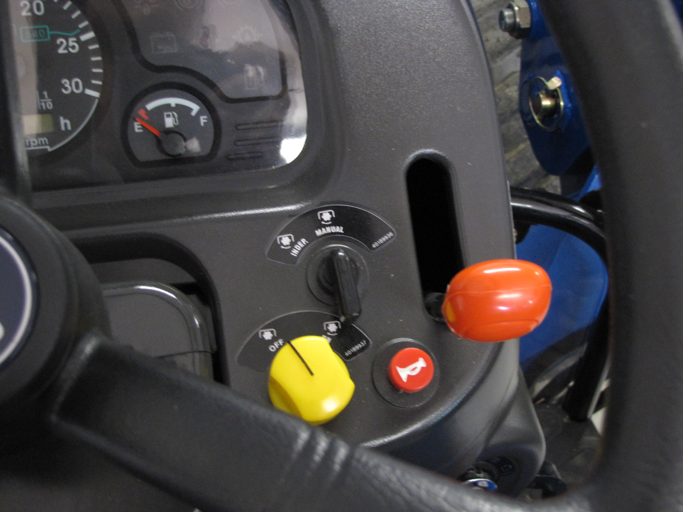

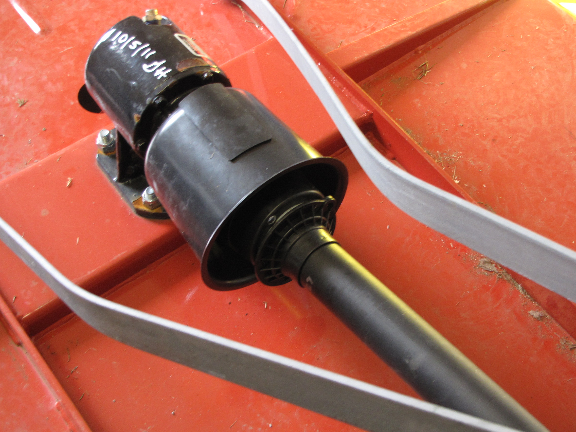

Well I replaced the shear bolt. What takes time is removing the shields, without the shields it would only take a few minutes. My tractor has a switch for independent or manual PTO. The PTO will not turn freely with either setting. So I had to disconect the shaft from the bush hog to line things up.
