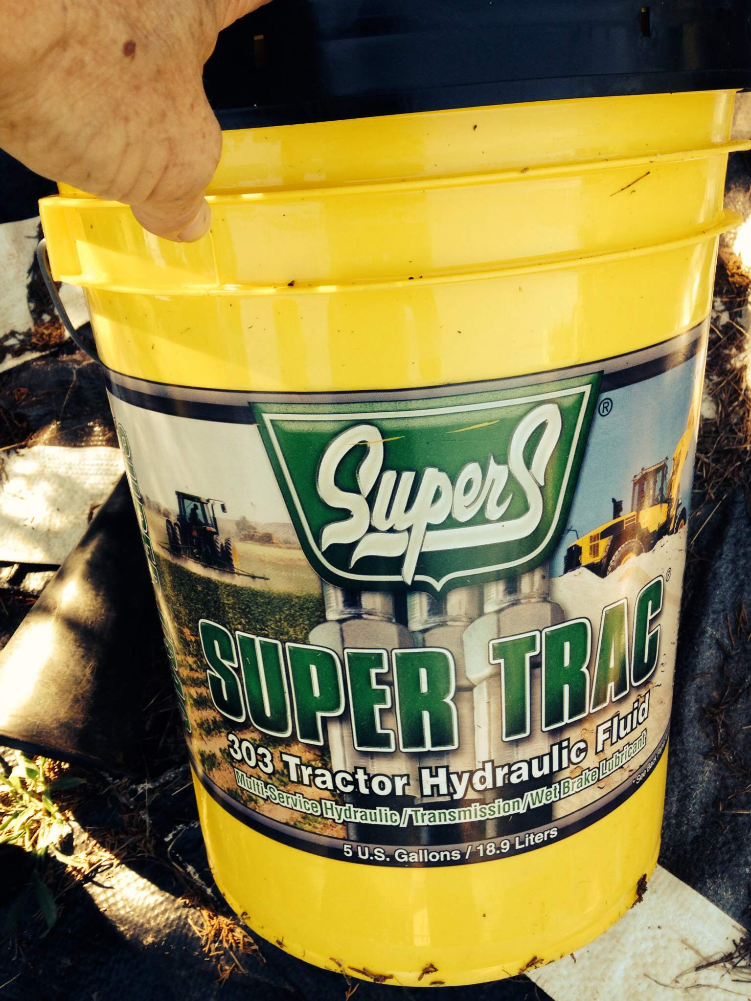

Do any of you know where to get a Manuel? If you overfill the hydraulic how do you drain some? What problems can it cause? Mine is making a strange noise when in gear but it doesn't seem to be causing anything yet but I don't know if that's normal or because I overfilled it.

I think you will find it calls for Trans-Hydraulic Fluid for Case/International Harvester.being overfull and wrong fluid might be cause of noise.I would drain it and start over.
