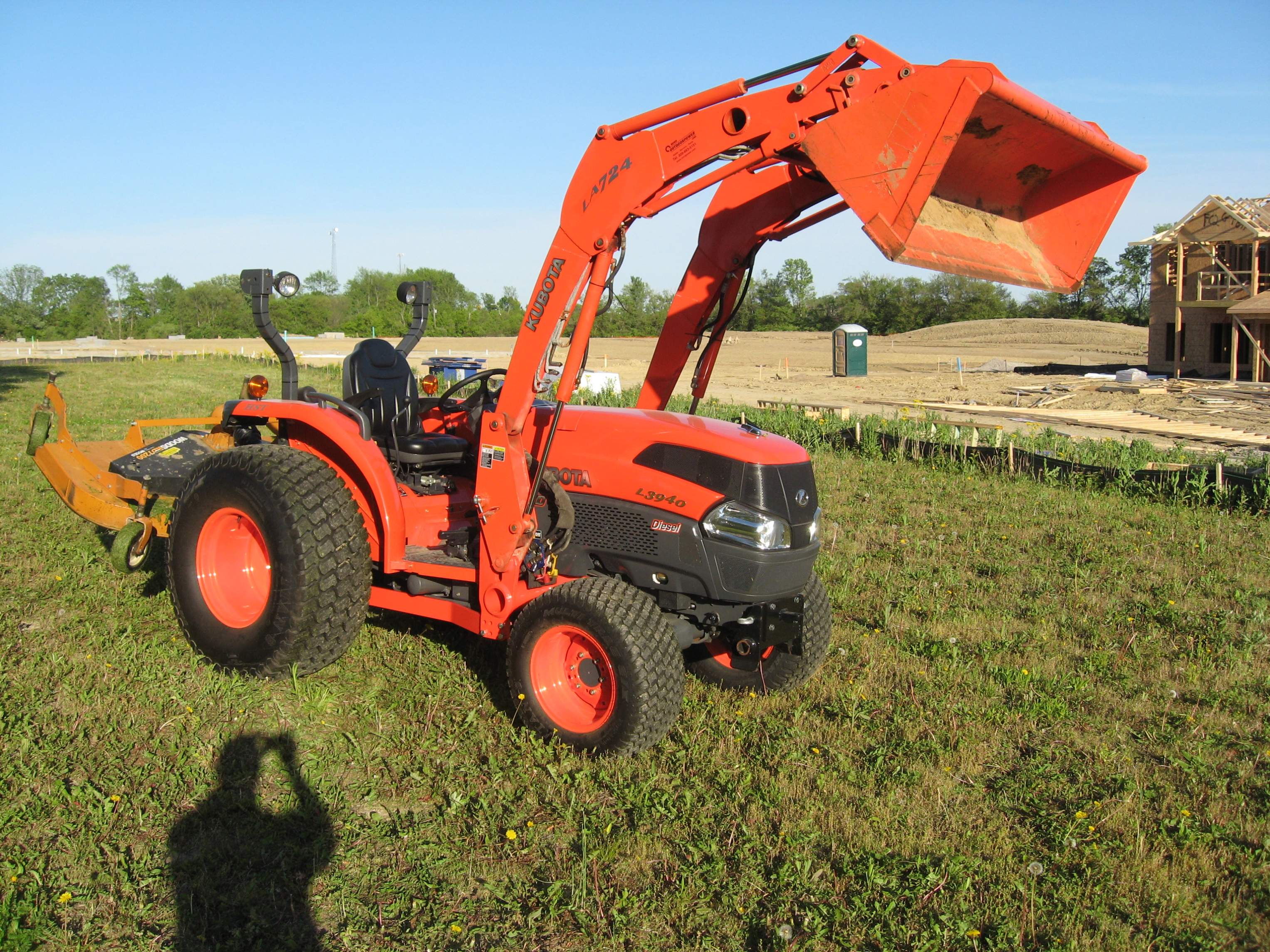

I bought my loader used and did not have a choice either. I got an LA724 for my L3940 with quick attach and heavy duty bucket. Heavy duty bucket is heavier, has same struck capacity, but has rounded back on the inside. Don't know if this rounded back is better or not. Check Barlow's, he has a few used loaders, that is where I got mine in great condidtion for about $1800 less than new, even came with all new brackets and grill guard. Philip.
