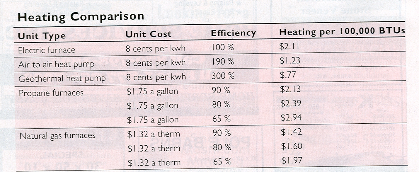

i hope i attached this right: it shows a comparison of heating cost for several different types of systems.

Must be the new math, but if I have 300% efficiency shouldn't I be getting 3 times more energy out of the system than I put in? That's even better than perpetual motion:confused:.

At 300% efficiency they should be paying you every time the heat is turned on.
There's also no mention of a fuel oil fired furnace. Oil has much higher heating value than propane or nat. gas.
Let's see if I can explain this. With a heat pump you actually do get over 100% efficiency because you are pumping heat from the outside to the inside, so you are only paying to pump, not generate the heat. They don't usually call it efficieny, it's called COP (Coefficient of Performance).
One kilowatt of electricty will make 3412 BTUs. You can get 2 or 3 times this number of BTU per kilowatt with a heat pump. The problem is that this number depends on the outside temperature and at low temperatures you switch to strip heating which is 100% efficiency minus the duct loses. If your ducts are in unheated space this can be very significant and even in heated spaces the duct loss heat is going where you don't really need it. This was why the space heater are so good. You put them in the center of the room and they put the heat only where you are with a real 100% efficiency. The big negative of heat pumps is the life. They average about 12 years. I replaced mine at seven years and have spend far more on the initial cost and the annual mantenace than energy. I have an insulated concrete form house and so it is very well insulated. The heat pump was a new design and pulled off of the market by the supplier because of reliabilty. They gave me a new unit at seven yeras and I just paid for installation ($4000, not trivial) I think gas furnaces will last 30 years. A gas furnace with heat pump gives you the option of using the heat pump above 40 degress where it is effiicient and not stressed and the gas furnace below 40. You can change this temperature depending on how the prices of these energy sources change.
