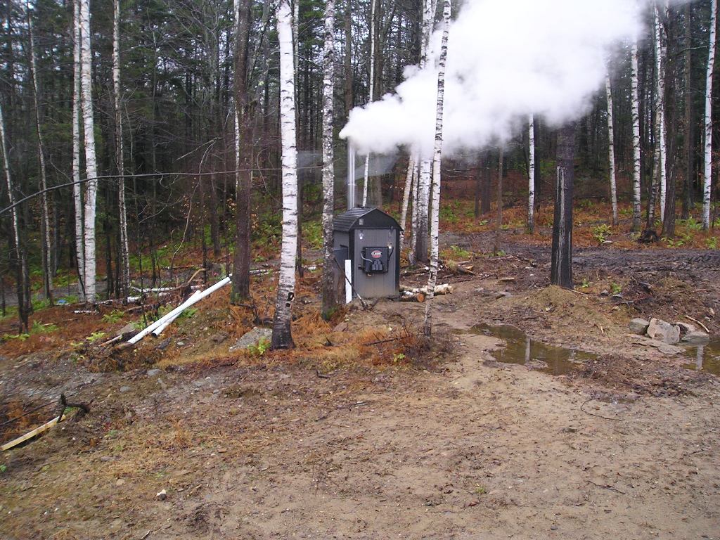

I'm using a outdoor furnace for my heating in the new house i'm building.My net cost is going to be $0.00 in less than 1 year.The furnace cost $5000. the cost of burning/getting rid of cleared trees was $5/6000 so the wood goes into the furnace net cost $0.00 . Next year fuel cost $0.00 ect :D

Does it every stop smoking?
Our wood stove only smokes a bit during startup after its running good, only a few minutes, its hard to tell it burning.

That smoking is a big reason that these outdoor woodburning furnaces are illegal in many areas. Cold stinky smoke in response to an on/off type thermostat.
5000$ to boot? No thanks, sell me a woodstove instead.
For some reason though, there is a pretty dedicated following for these smoke shacks.
