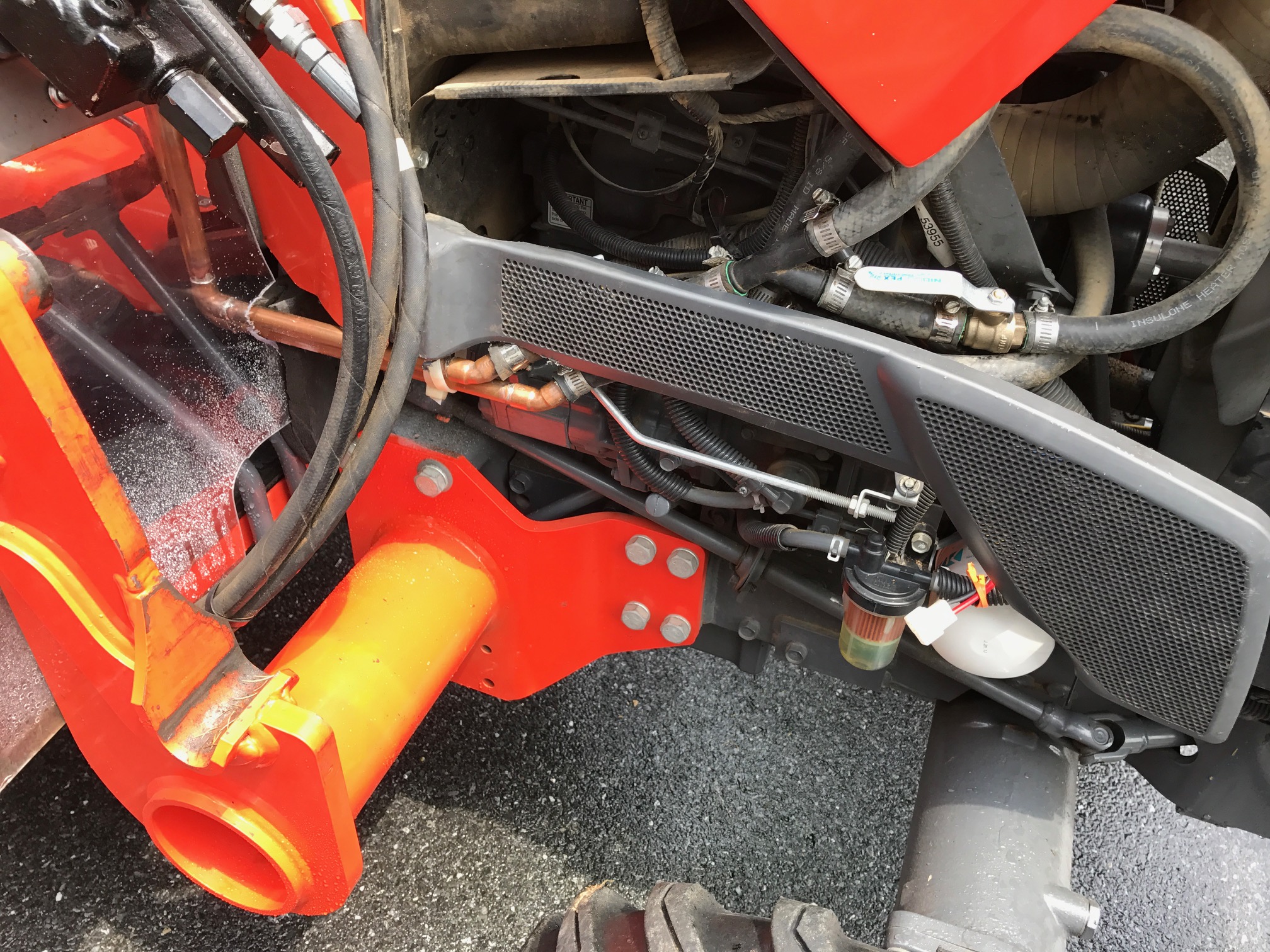

Thanks everyone - a friend works at the local (30 mins away) kubota dealer and had a L48 in their shop for service which the tractor did have a cab heater.
Supply to cab heater core is actually the thermostat housing. Right above the temperature sensor which points to the left wheel there is a threaded 3/8" npt fitting which is removed with a number 8 Allen. This is the supply. The threaded plug points to the left rear tractor tire
For the return, I used the threaded plug by the water pump which points straight to the right front tire. Once again it is a 3/8" npt fitting.
Heater works great - lots of heat! Almost too much
I used a maradyne heater I bought off of ebay or amazon. Only mod I did was to change the copper pipes to point straight down vs 90 as built. This made it better for my hose routing

I would never run anything but metal pipe carrying engine coolant inside the cab of any vehicle.
This is not an efficiency issue, it is a safety issue. If you have ever seen a heater hose let go under the hood of a car, the entire engine compartment is sprayed with boiling hot coolant and steam. If this were to happen inside the cab, the very best outcome would be incredible scalds and years of skin grafts.
If the vehicle were moving at the time, or if you were performing some critical maneuver with the tractor, the chances of a serious vehicle accident in addition to the scalds would be very high.
Curly Dave, Want you to know that I read this post a while back and it prompted me to think about my setup. My heater core sprung a small leak, so I replaced it yesterday. The original core was aluminum and now the same model / same replacement part# comes in copper. This was a great time to revise the hookup and take hard copper outside of the cab for the hose connection. It ended up being a cleaner installation as a side benefit. The white dusty-looking stuff is crumbs from grinding a bit on the Lexan. You may have kept me from getting scorched. Thank you.

Would you more being more specific. You are saying the l48 application worked on your stat and WP? I ma trying to look at a schematic to install the 3/8npt on my l3901. This would be a huge help to me to figure out.
Good thinking on changing to straight down. That clears up the clutter and sends the line down behind the seat to the outside in an easier fashion.

My kubota engine ( l39 )threads were 3/8 bsp not npt. Can you get more than 1 1/2 turns? I got fittings from mcmaster carr.
