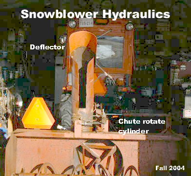

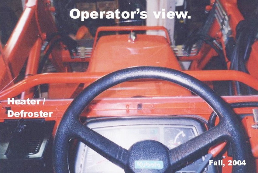

/ Heater core for cab #24
brunswick000....When I built my cab I used a heater I had bought years before for another tractor. It is mounted below the windshield to the left of the steering wheel, with airflow directed up towards the windshield. I also installed one of those computer fans in the upper right rear corner of the cab that draws the air across the back window and pushes it out through louvers above the window. (The louvers are below the "y" in "hydraulics" in the second picture.)
Once the tractor engine gets warmed up, I never have frosted windows.

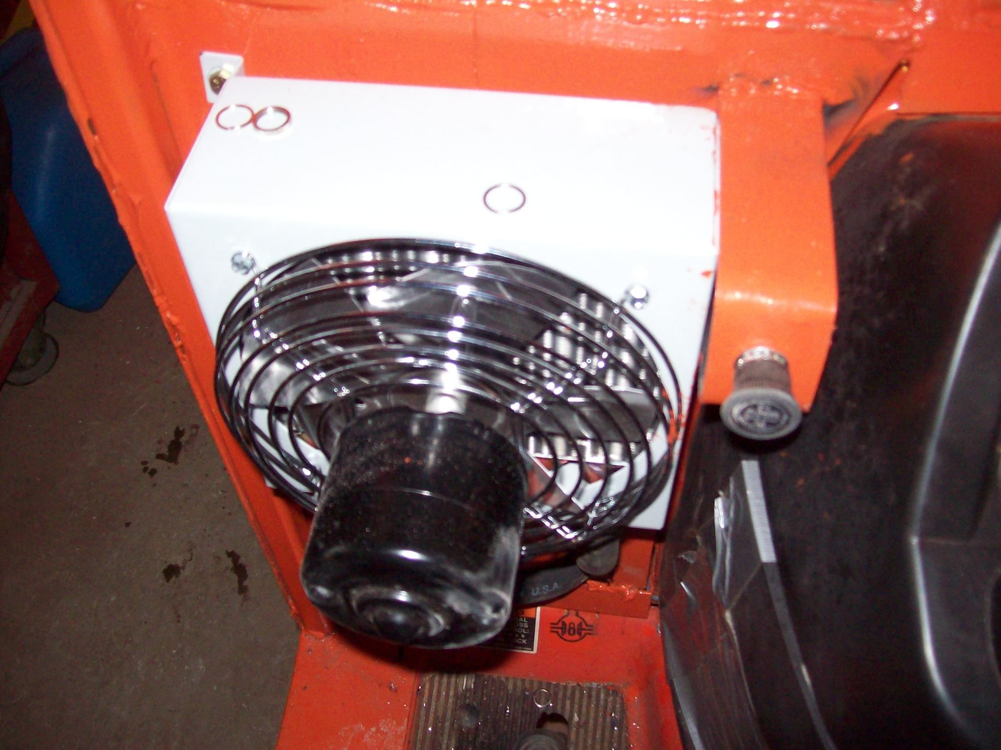

/ Heater core for cab #25
from a step van catalog works excellent

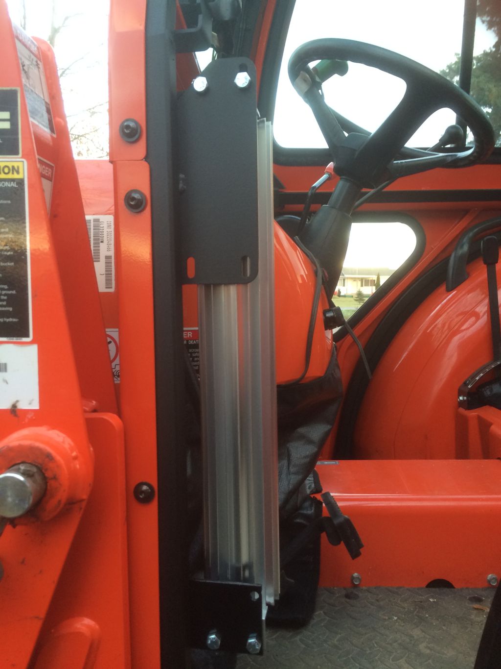

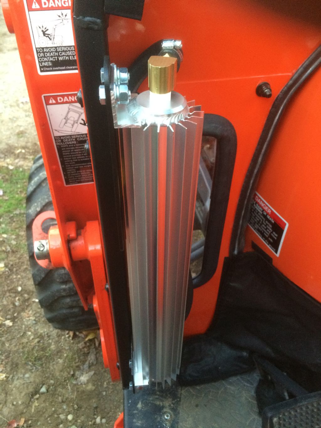

/ Heater core for cab #27

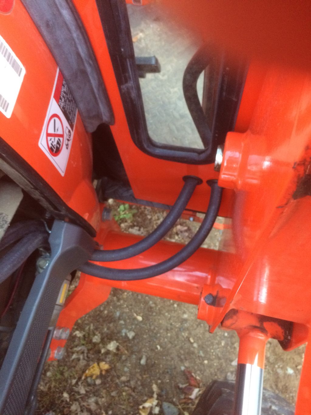

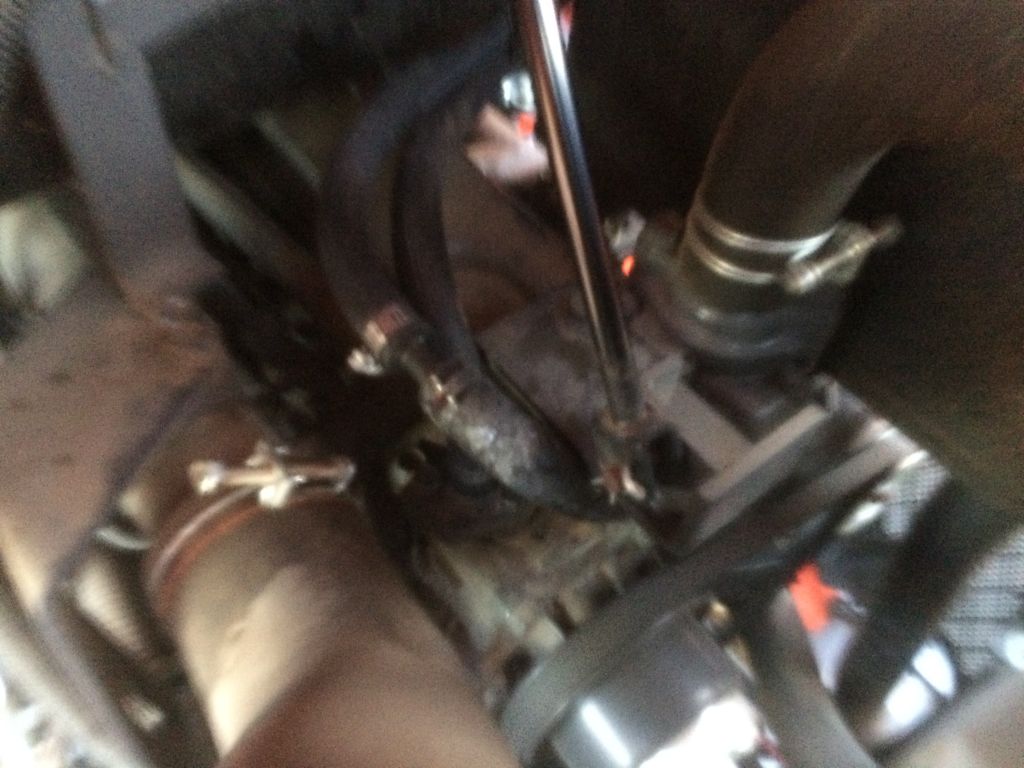

Thought I'd add my setup on a Kubota L3200, purchased an inline trans cooler from ebay for 38 bucks, hoses and fittings another 40 bucks,
attached cooler (or heater in my case) to bracket in Curtis cab, plumbed through engine to water pump bypass with 1/2 inch fittings
and hose, added a simi style 6" 12v fan to blow across it, it works great and looks good...
