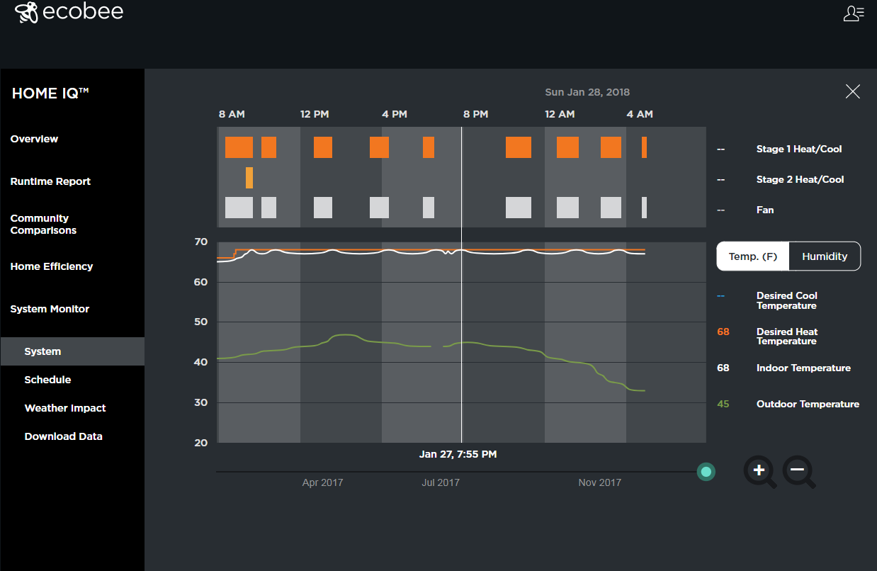

But If you had an ecobee....I am sure the chart will tell you when strips are running. Wattage of the strips vs how long they are on gives you all you need to compute cost.

What I'm saying is I don't think it can do that, at least not completely. From what I can tell... There isn't a standard input on the thermostat that listens for a 'the heat strips are running' signal. If the thermostat is what tells the heat strips to come on, then yes, it could report on that (but it would just be assuming the heat strips are running). A defrost cycle doesn't involve the thermostat - it is triggered by the control board in the outside unit. For me, each defrost cycle can chew through about 2kw and can happen every 30 minutes or so.
