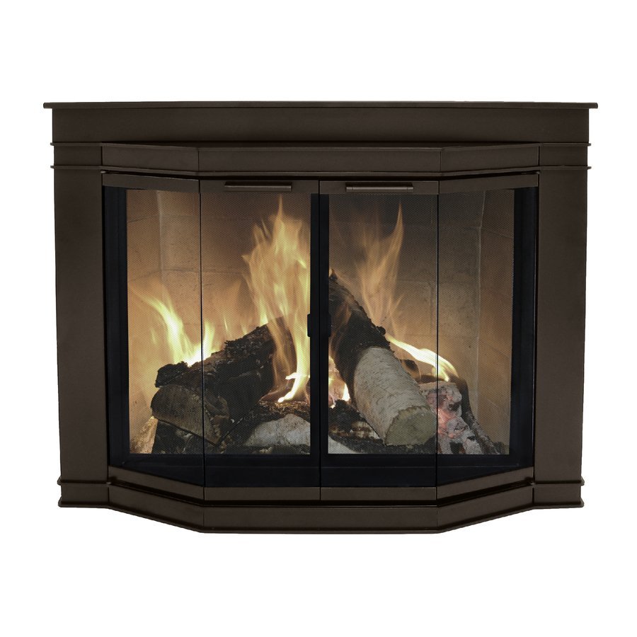

Also while I can't argue of the convenience of gas. I really enjoy a real fire. Different view each time you burn, the sounds of the wood crackling, and ability to control the heat from a little to intense is hard to beat. Ours is cranked up as I type.
Beautiful fireplace there JK... thinking your house must be quite beautiful and grand as well. :thumbsup:
