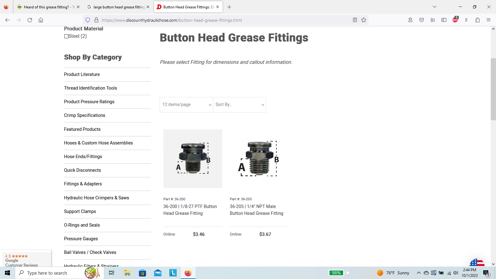

It called a Gaint button head fitting. It’s supposed to grease top roller on a tract style tractor. I guess it’s the only way to “lube” them. Some use heavy oil some use grease
I'm assuming this is what you are referring to;
using this fitting on a grease gun;

That’s it! I thought it might help somebody because I looked a while before I found it. I even ask the Cat dealer here and the young person who I was talking to did not have a clue as to what I was needing. On my Cat tractor I just have them on the big top rollers I think on both ends. My U series rollers don’t take anymore grease there are no fittings on them. Thanks for the reply

OK now where do I buy double ought grease? And does it come in tubes. The person I saw had a little jug with a pump lever on it. I think it’s a lock and lube product
   / Heard of this grease fitting? #6
Corn Head Spindle grease. Napa, Deere and Tractor Supply can get it, but only in liquid.
Button zerk used on older field discs too.
I have the pump can and button head coupler still
