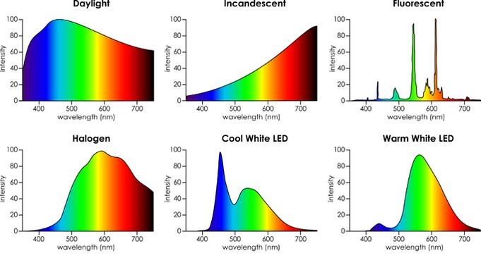

Aaron,
Yes, and the above you had snipped stated;
"LEDs, even though LEDs that emit white light do not contain significantly more blue than any other source at the same color temperature."
White light is at one end of the spectrum. That's what the industry calls the COOL lighting. If you know how to read the article and sense the wording, you'll understand they had basically ignored the WARM part of the spectrum. SURE, all of the WHITE will have a relative amount of BLUE in the COOL light part of the spectrum. That's their discussion part of the article.
For WARM lighting, the blue is soooo small it almost doesn't even register. If the article would have compared COOL to WARM, then the understanding would have been crystal clear.
In the spectrum chart below, the incandescent, halogen and the WARM LED, all tend to favor the safer part of the light spectrum.

Aaron,
Again I quote "According to current international standards, no light source that emits white light and is used in general lighting applications is considered hazardous to the retina for healthy adults."
The danger that the AMA is worried about with 5000k lights is messing with your circadian rhythms due to using "bluer" lights (for example 5000k lights) around bedtime which can fool the body into not producing melatonin.
There is no danger to your retinas from using any of the commonly available lights in any color temperature.
They also addressed light charts like the one you show which use a percentage of light emitted rather than the intensity of light, they show that that can show a misleading spike in the blue color temperature section of the chart.
Aaron Z
