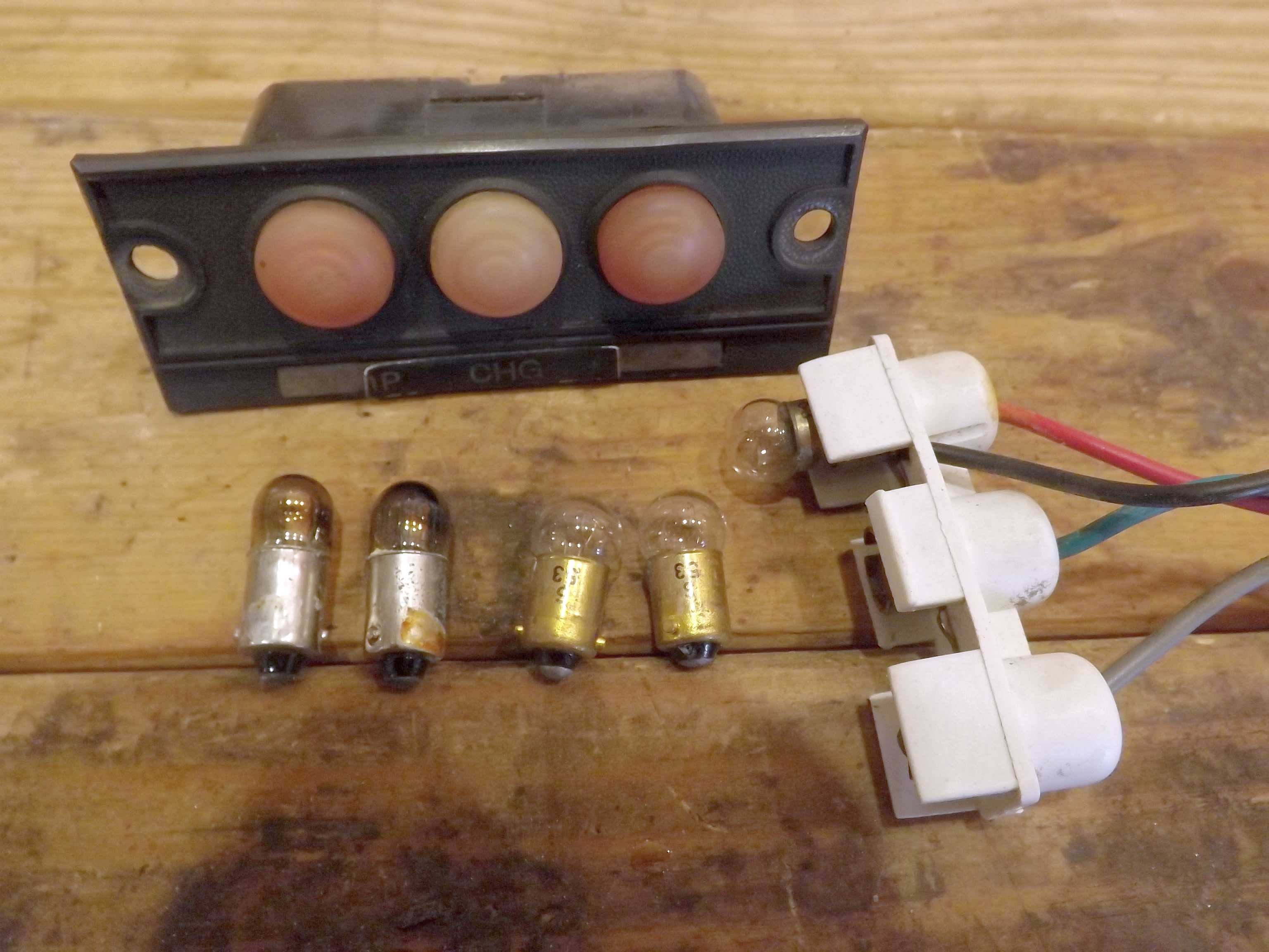

194151-55820 - Yanmar, Bulb, 12V3.4W (inscribed markings NSN 12V3.4W)
Also known as: HONDA OEM BULB 12V 3.4W) | 34902-259-003
With a BA9S base. The apparent LED equivalent is a 1157 LED Bulb.
Has anyone found a replacement LED version of this bulb that they like and works well for them?

If you have the bulb, have you tried searching / cross checking the number stamped into the bulb?

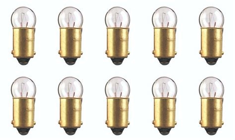

Are they the 53 bulbs found in the lamp gauge?
Then yes, you can go LED,
53, 182, 363, 1445​
LED Replacement Indicator Bulb 12VDC​

Thanks Peter, I’ve edited the question to be a bit more clear on my asking for the LED Bulb. I do have the markings and I’ve researched the bulb a bit, and the LED options look like crap. They don’t seem like they would fit in the rubber push-in’s on my Dash. I’m not looking for super bright Dome lights that are not needed, but are often the replacement LED version. I was hoping someone has used a bulb they like and could recommend that bulb, vs the junk I’m seeing out there.

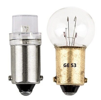

I edited the Question, but the bulbs say NSN 12V 3.4W,
The Honda bulb with part number 34902-259-003 is a 12-volt, 3.4-watt bulb featuring a BA9S base. The GE 53 bulb is a 14.4-volt, 1.73-watt bulb with the same BA9S base.

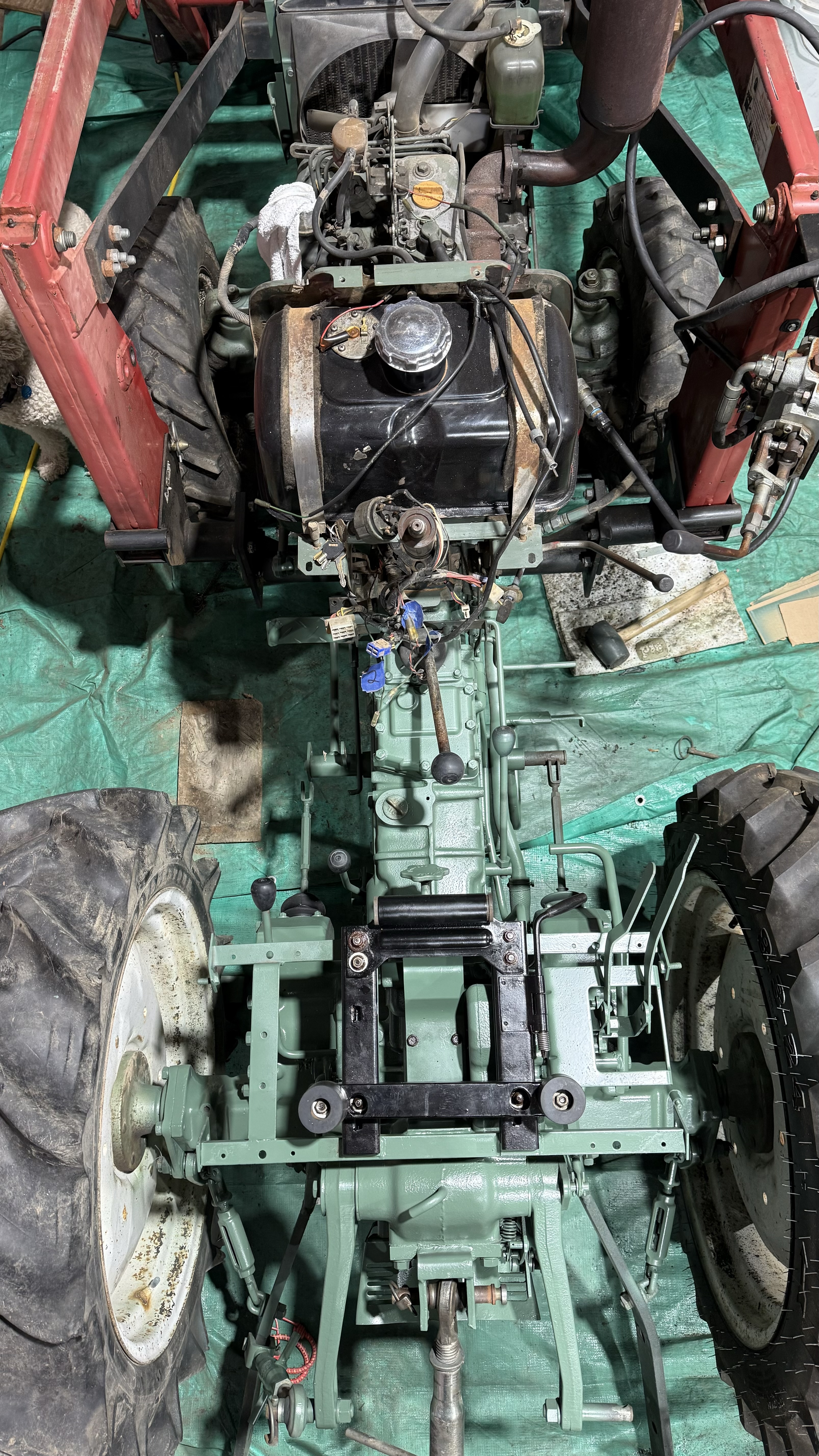

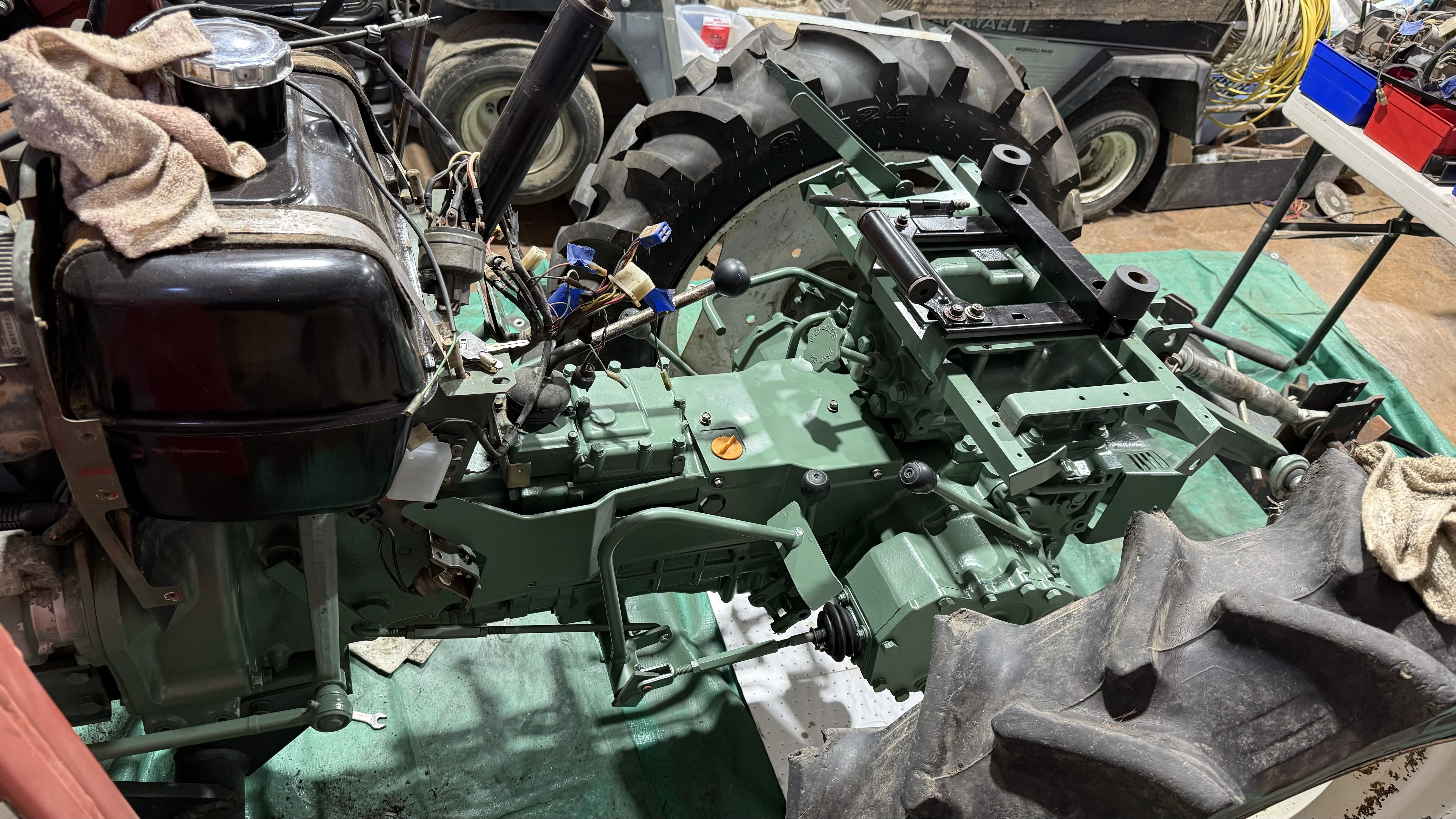

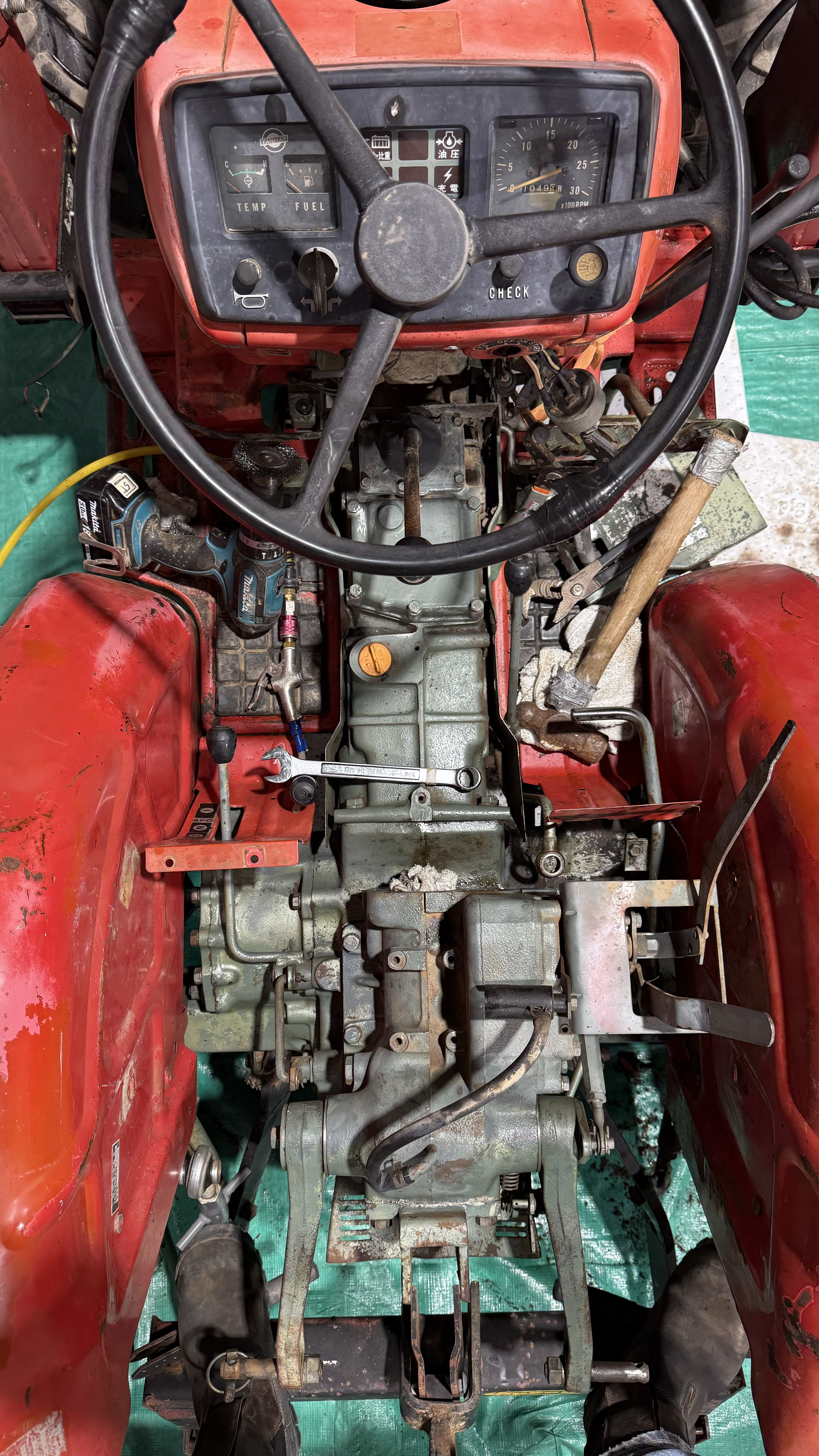

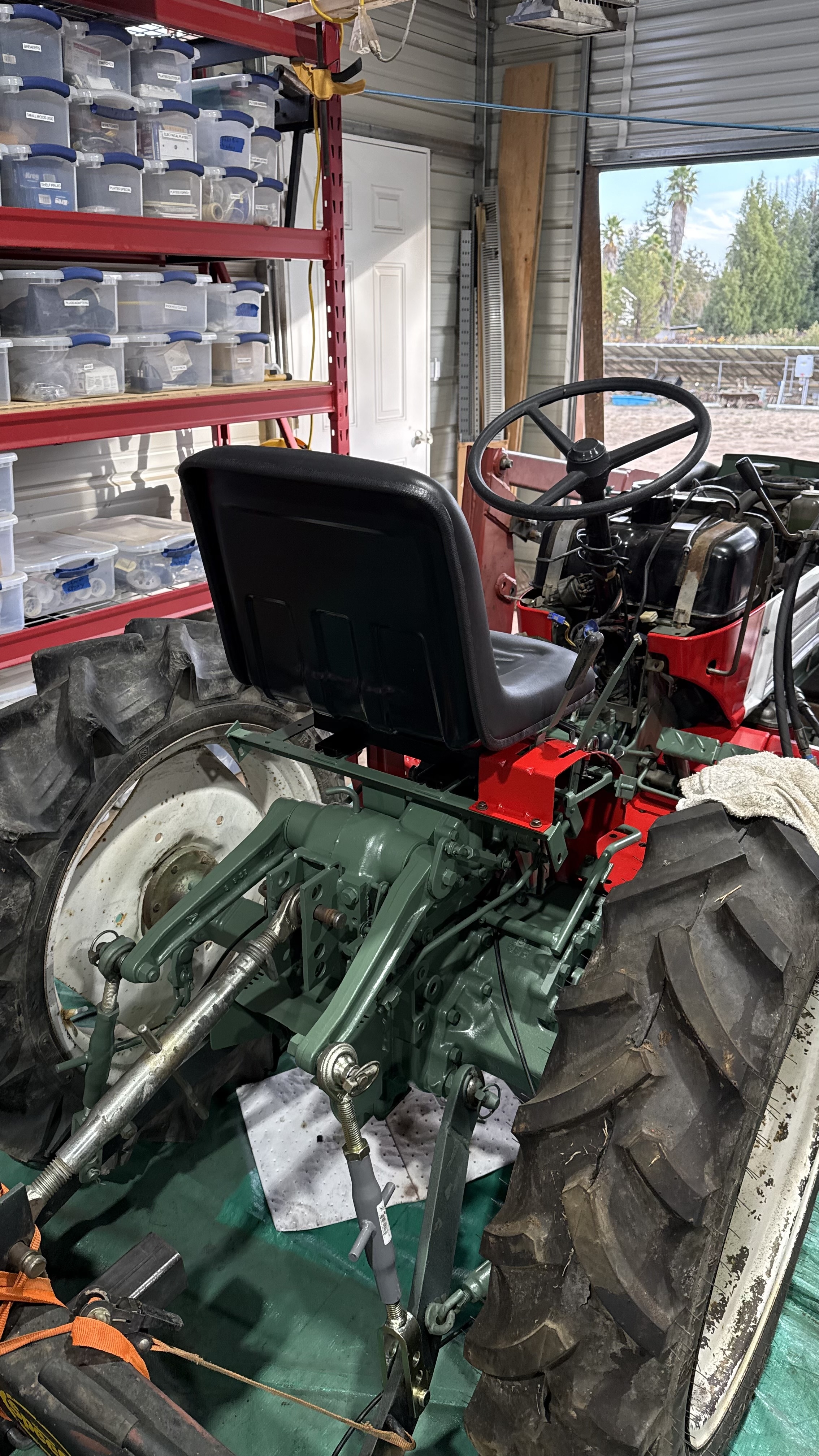

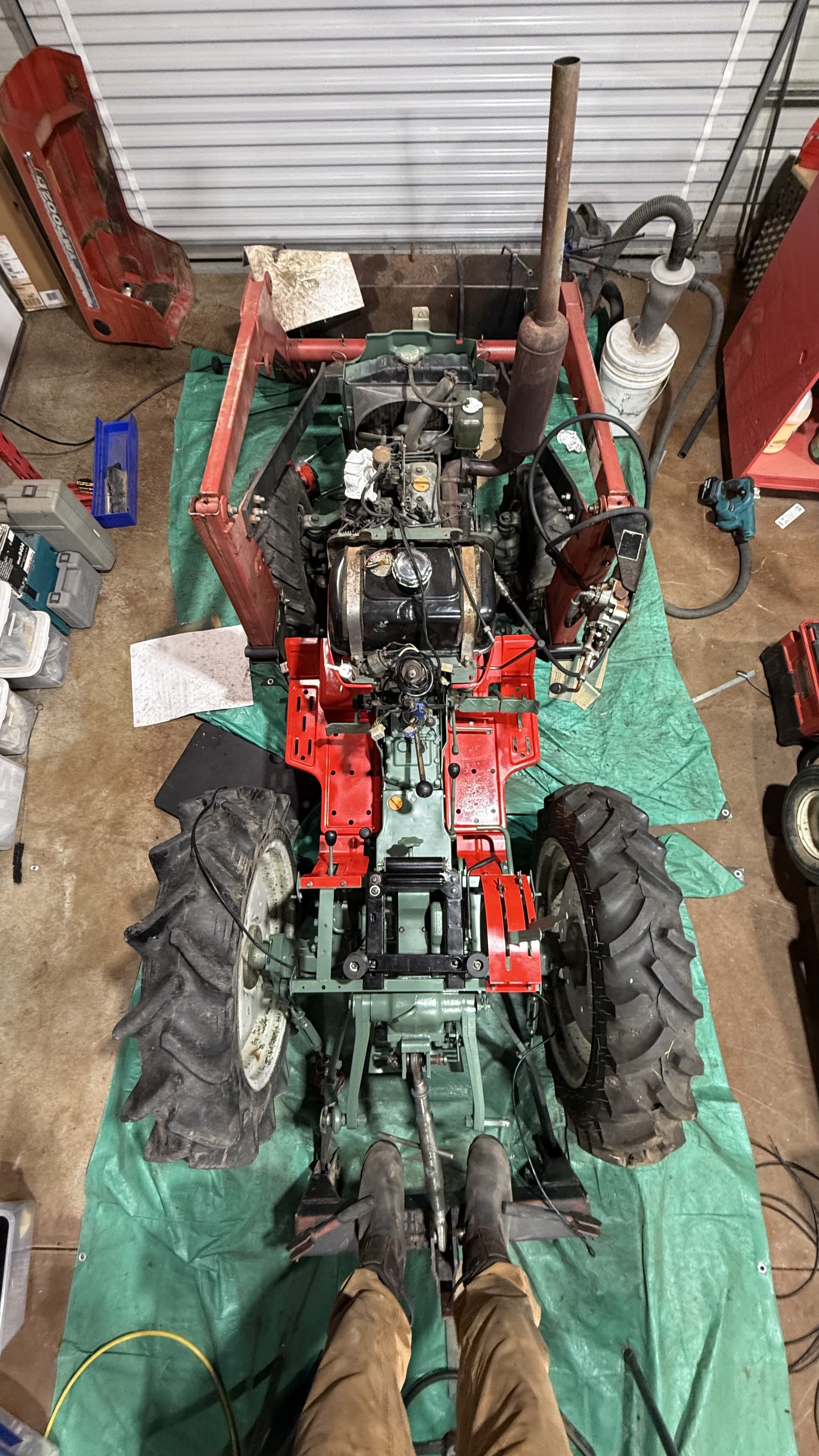

No, it’s not new. I think I got it in 2006? I’ve not been kind to it, so now I’m trying to go though some things and get her cleaned up.

Oh, now I see why you need a new horn button. I love the dash and controls your machine has.

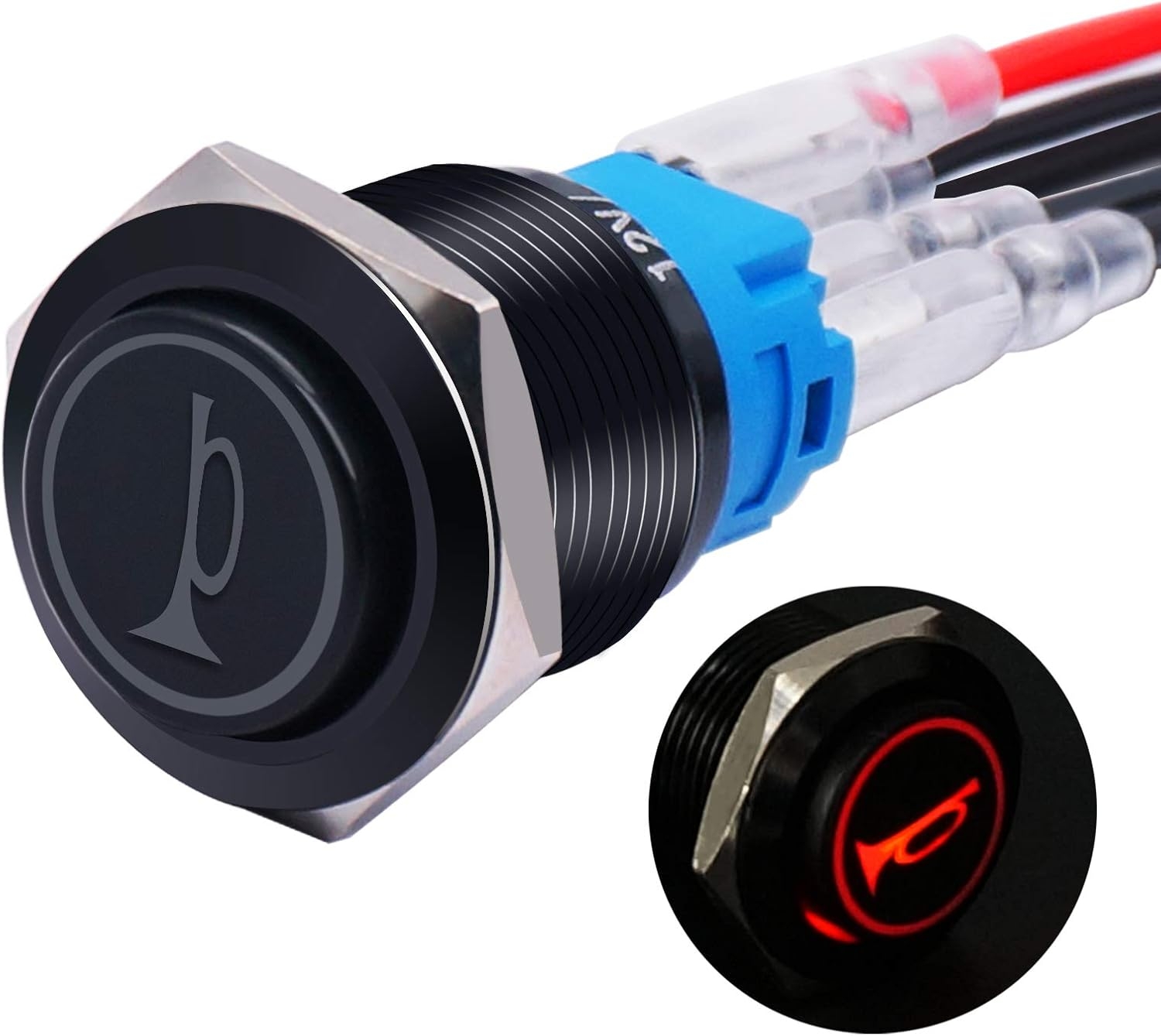

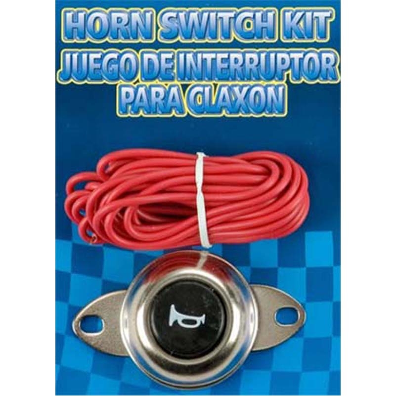

Though I looked the Hole for the Horn button is about 7-8mm. That Horn button on Amazon was 16MM. I’d have to carve out the holes for the 16mm version. I’ve seen a 12MM button. Will have to get some coming to see how they feel.
