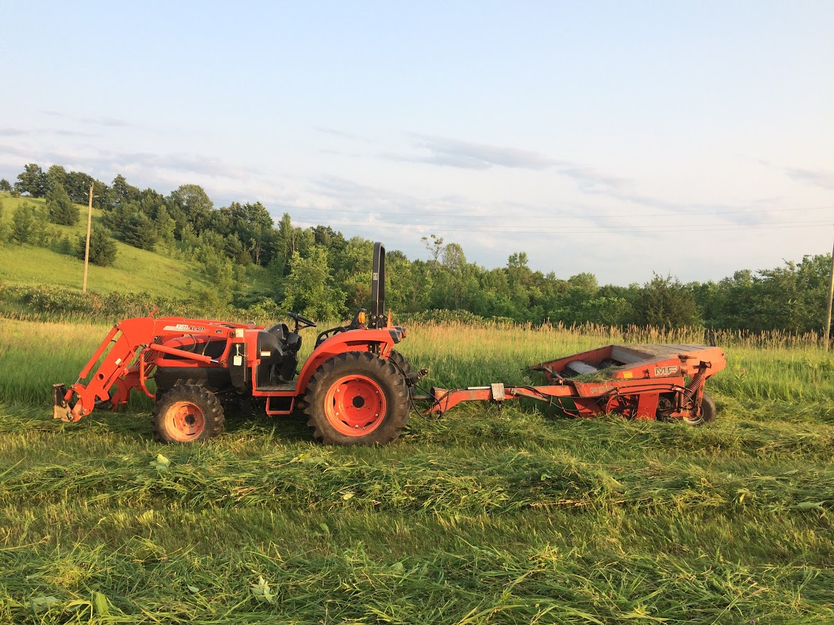

I’d be looking at a small disc mower or a drum mower that runs on low HP. A trailed type would be nice since it doesn‘t hang off or weigh down one side of your tractor.

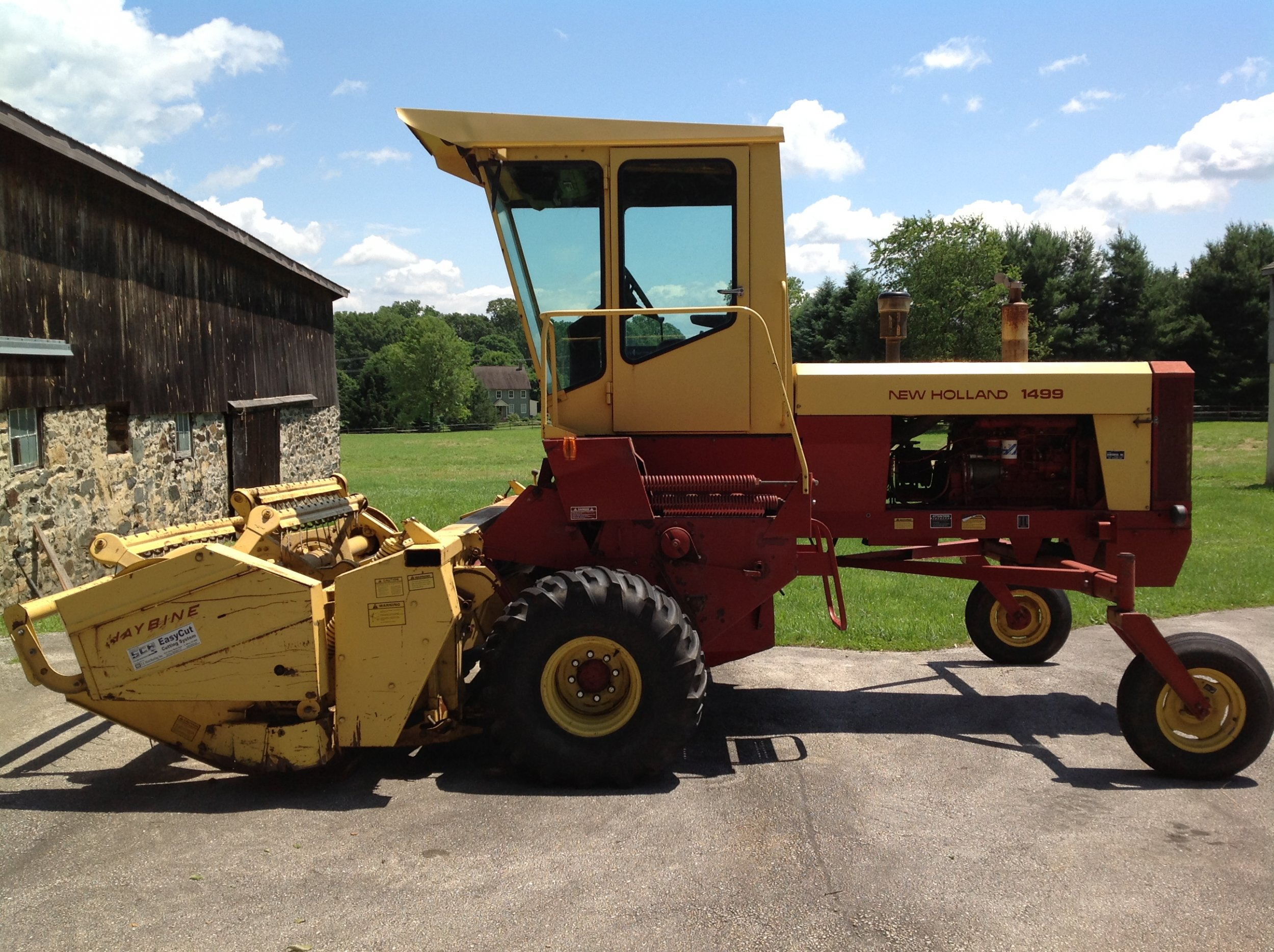

When I started, I had a small tractor and purchased this self propelled haybine for $4,000. It has an air conditioned cab and simple diesel engine. Great little machine.
All my tractor had to do was ted, rake & bale. I ran 2 small square balers, a JD336 and a NH318. Made 10,000-11,000 square bales per year that way and then began round baling.

Cutting and raking seems to be easy with not much hp, this is a 9' haybine and I can zip along in mid range as fast as the field allows, with either roughness or volume of hay plugging up the crimper.

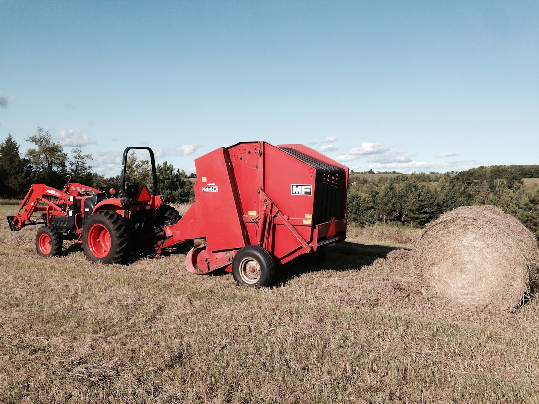

Baling is a different story, I could make 5' when it was really to dry to bale, but as the evening went on and the humidity crept up, I got down to about 4' bales was all the tractor could spin in there.... I don't bale anymore, its running the tractor right at max output for too long.

I notice you leave a pretty high stubble.
   / Haying with a Mahindra 4110. Enough horsepower? #19
Certainly is... Think I'd drop that head down at least another 2-3 inches. He's leaving a huge amount of forage in the field.
Had the same issue with my long gone Kubota 5030 (my screen name). Bailing wheat straw. It was fine during the heat of the day but as evening came along and the straw retained some moisture (dew), the tractor was struggling to roll a 5 foot bale. Got to the point where I had the throttle wide open to hold 54 pto.
You might want to see if you can buy a set of infeed discs that go in the bale chamber right above the sledge roll. They keep the formed bale from rubbing the side sheets excessively. The friction of the bale on the side sheets is what causes your issue. Where all the power loss is.
   / Haying with a Mahindra 4110. Enough horsepower? #20
Installing in feed discs reduces the input power to form a 5 foot bale appreciably. Both my sold NH and my new Kubota round baler came with them new but you can buy them aftermarket and install them yourself.
