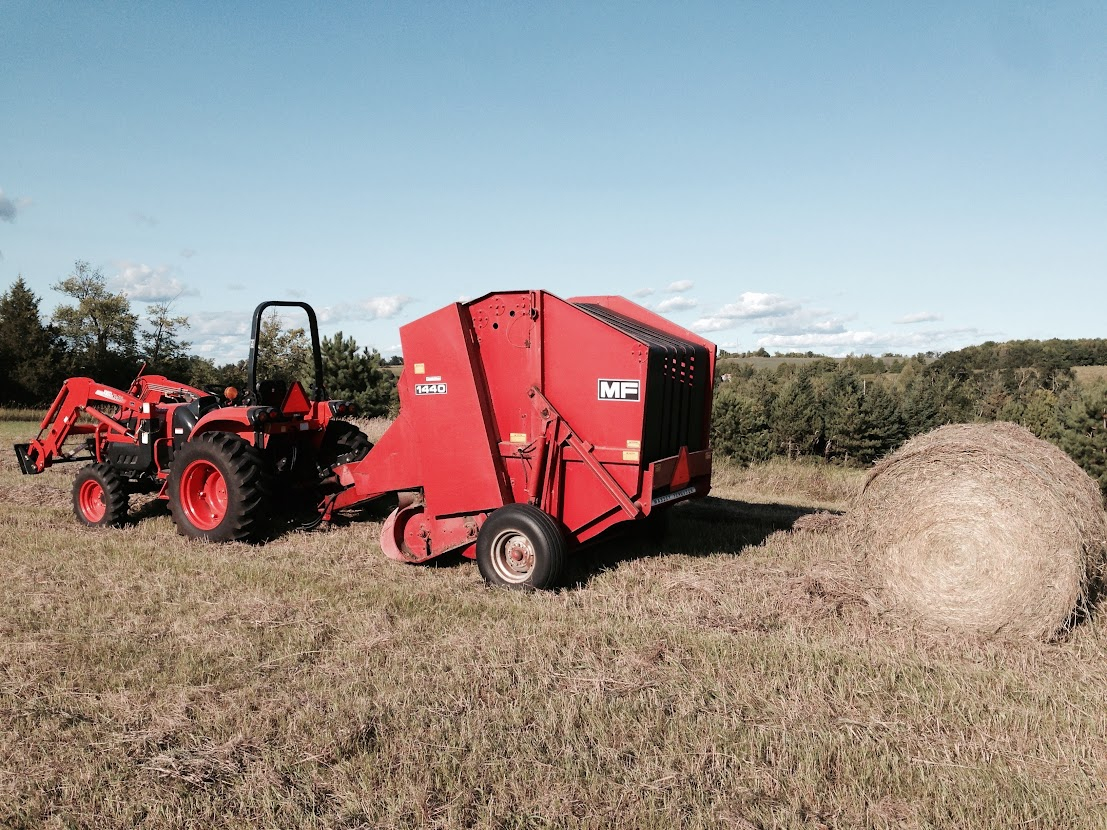

Understand, if you want to round bale, the game changes appreciably. You need a pretty substantial tractor to run a round baler, I think (could be wrong) but the minimum power requirements for a typical New Holland round baler equipped with infeed discs is 40 pto horses and the tractor has to weigh a good bit or the round baler will drive you.
My new Kubota round baler I just purchased the minimum required pto power is 60 to roll a 4x5 round bale and wrap it.

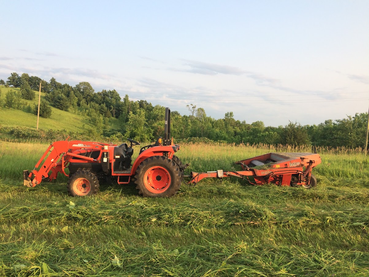

I understand the hesitation with bailing especially round bales, but what about cutting? What should I be looking for in a mower?
Pardon my ignorance but haying is new to me.
   / Haying with a Mahindra 4110. Enough horsepower? #10
Sickle bar hay bine with conditioning rolls or a side mount sickle bar. Lots of older NH and JD MoCo's on Tractor House for sale. You don't have enough pto power for pull type disc mower with conditioning rolls and you would need at least 2 sets of remotes as well. One set for the table and one set for the tongue swing. ASC sells a nice side mount disc machine that goes on a 3ph but has no conditioning rolls. They also sell a nice tedder and rotary rake. For low pto power, a side delivery is nice like I said but you have enough pto power to run a single head rotary rake as well.
