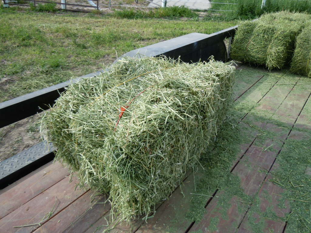

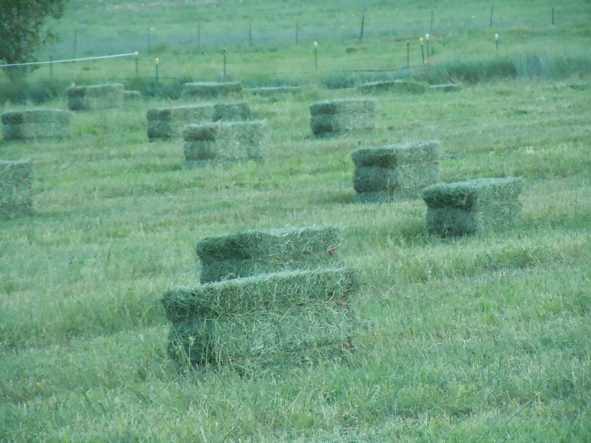

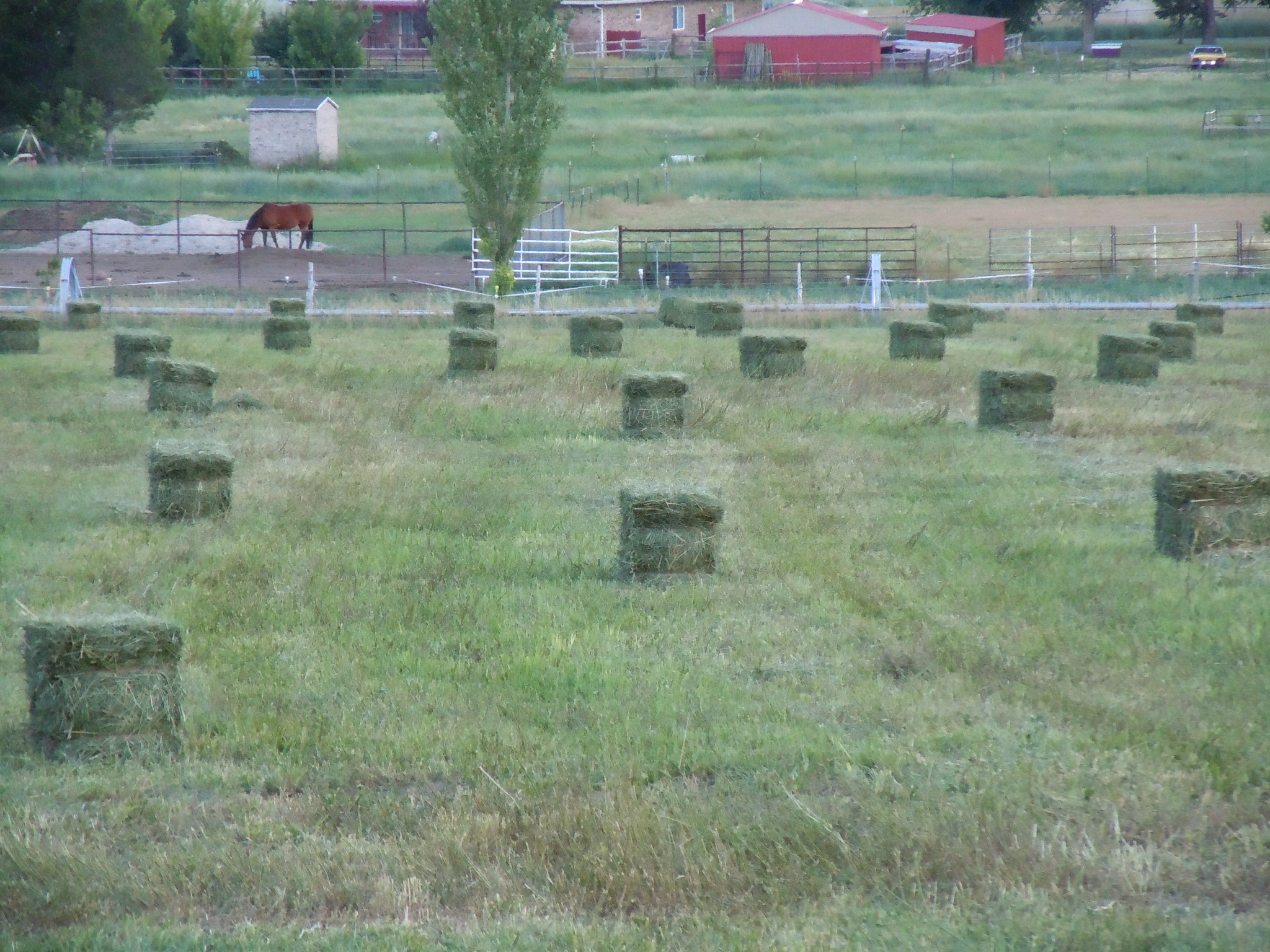

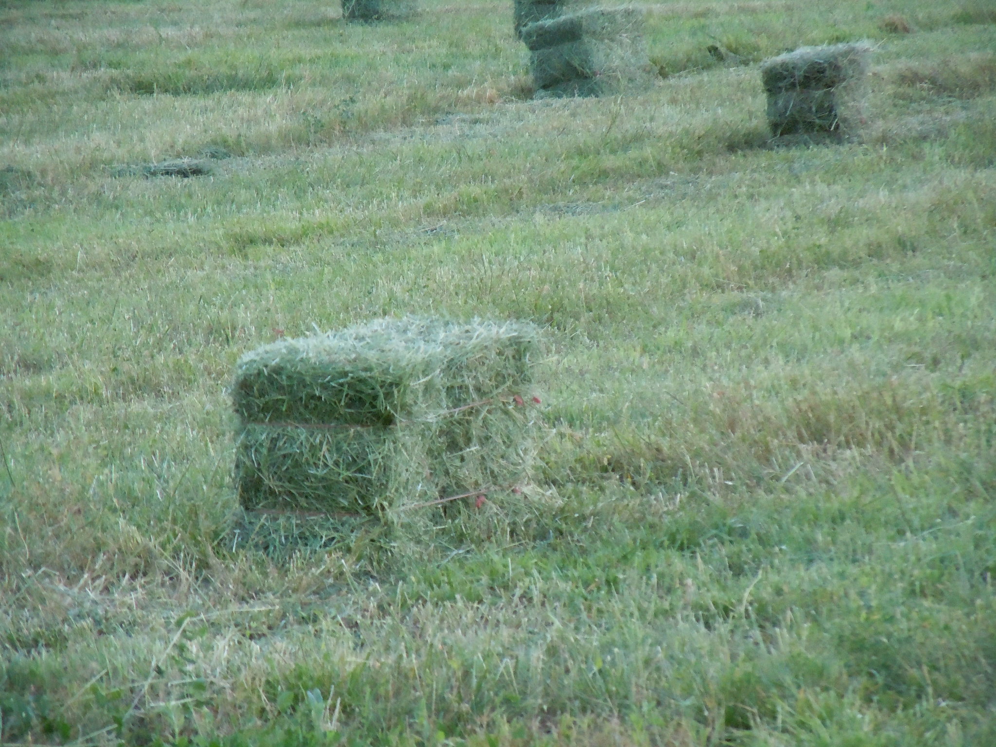

After reading this post I am convinced not to do my own haying for my three horses even though I have enough land to obtain more hay than I need. But I must comment on CAT FEVER's pictures on this first post on this thread......That second picture gave me EQUIPMENT, OUT BUILDING AND FENCE ENVY in a MAJOR way. :licking: That is some of the nicest fencing I have ever seen.:thumbsup: Your "first bale" post made me smile. Thanks to all who contributed to this most interesting thread and saved me from doing myself in.
