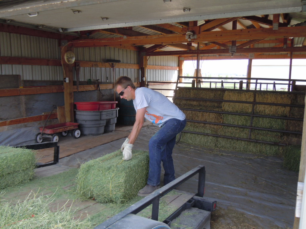

Keep it in this barn on a tarp. If I need more space I have a bigger barn. I realize many TBNers need much more storage space than this little barn. (21X36) But it works for me at this point. The big barn pictured in my avatar has much more space, but it's not needed yet.
