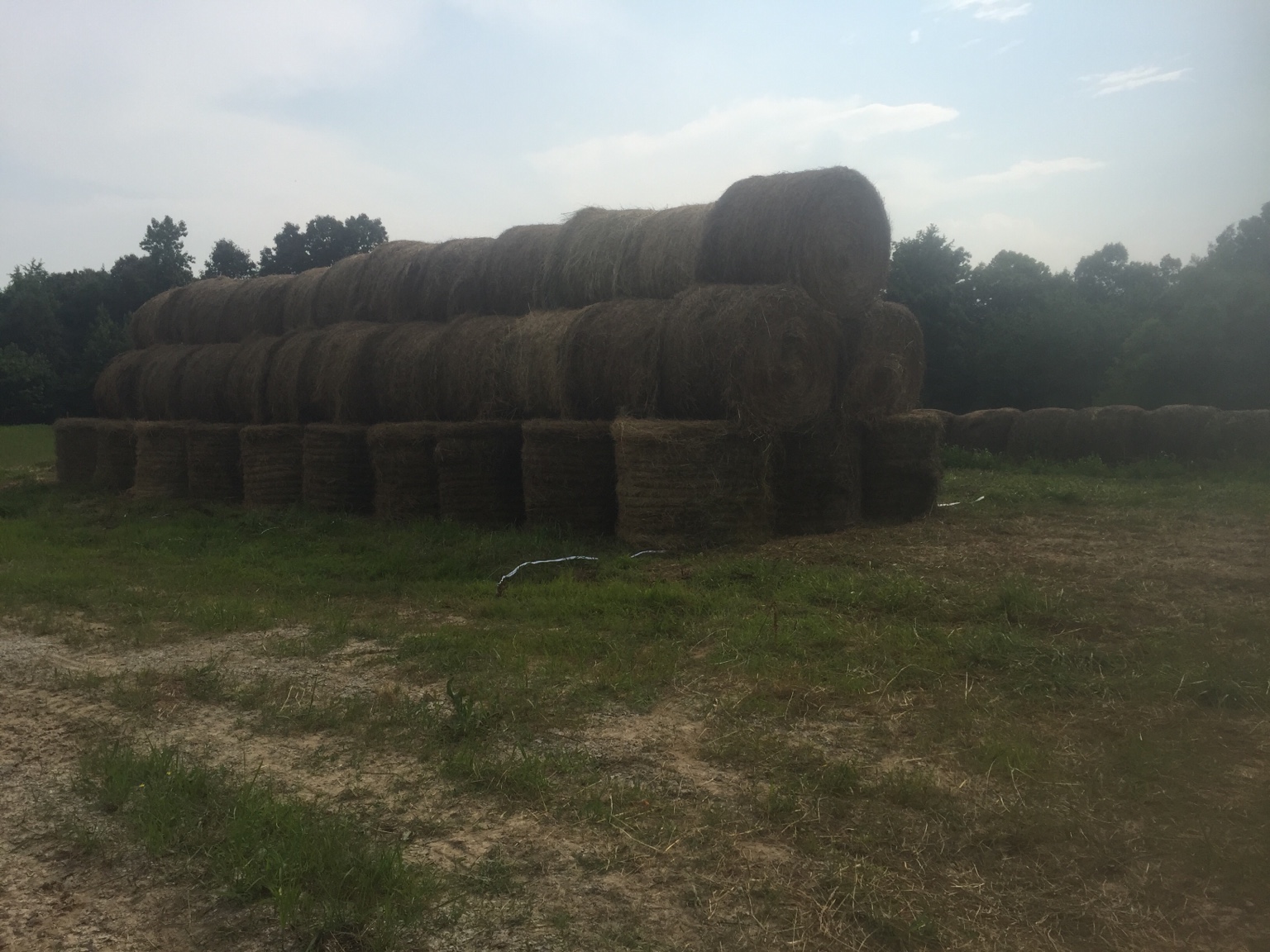

Small squares- First layer straw then stack so the bales interlock and tie stack together. On top lay a row of bales in the center of the stack and put the tarp on and secure it snugly. That allows the top to shed water and snow. If you live in windy areas, invest in a real hay tarp because a blue tarp won't cut it.
Rounds with twine tie - Stack the first one vertically and then the next row horizontally. I've seen people go two vertical and then one horizontal. I don't.
Rounds with net wrap- stack on the ground butted together with each row separated by thee feet. The first year I had net wrap I stacked them like I do twine and the water ran off the net wrap into the lower bale and I had frozen moldy hay in verticle stripes on each side of the bottom bale. Never did that again! My theory is the net wrap allows water running off the top bale to stay attached to the top bale beyond the mid line of the horizontal bale and then drip into the bottom bale. On a twine bale, the rough outside lets very little water beyond the mid line.

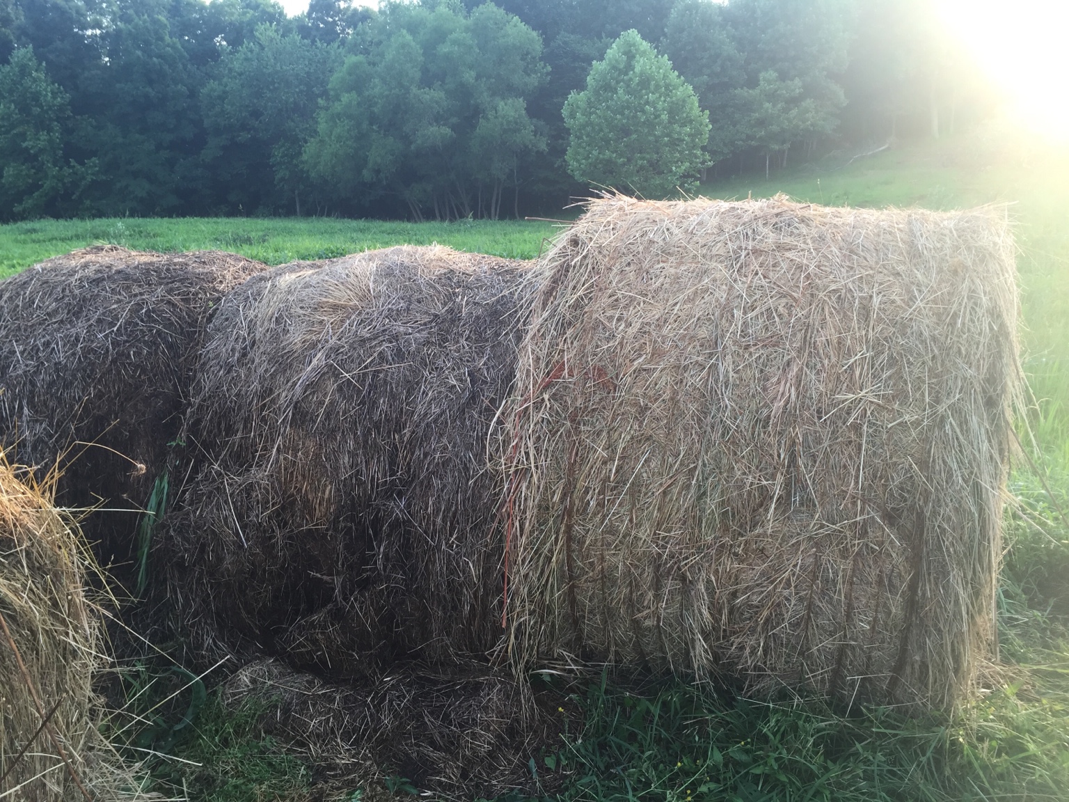

4x5 twine tied round bales.

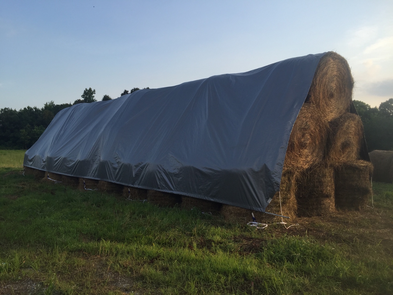

Currently my hay is stacked outside on the ground unprotected. So my thoughts are I'm loosing 25% or more to weather. (Some research suggests losses as high as 50%). If I can stack and cover and get that number down to 10% or less I'm already way ahead. While I'm not disputing that it's better to have the hay up off the ground, I know pallets won't work for me. I might be able to get a load of #4's in and spread before I start stacking.
Currently I'm looking at a 25'x54' tarp. Using a tie down system that uses bale anchoring tie downs. So the hay holds the tarp on. Cost seems to be about $400. Tarp uses grommets with webbing not loops to tie down. Haven't seen any with loops. Although I think they would be best.

Stored it outside for years unprotected. You lose a lot more than u realize. Decided to try something different. Went with tarps. Lost some on bottom and very little on top to moisture/mold. Significant decrease in rotten hay lying on ground compared to no cover. I had to be very economical about the tie down so I used whatever was laying around( I'm sure no one else has junk laying around the farm). Went with old tires and concrete blocks(cinder blocks). Now use both on bottom, but use blocks to anchor tarp. This also allows me to peel back tarp like a banana without having to remove and reanchor. Tarp stays secure and next roles are easy to access. Tarps are difficult to manage alone(do-able but difficult). Blocks will freeze to ground but easy to move with a bump from FEL, tires no problem. A lot less hay lost I must say, and with good care, tarps finished 6th year and will be used a 7th. Fortunately I have some barn storage, and tarped hay is always fed out first. 250 rolls per year very few squares. Would like to try a tarp barn, but my experience with way I try to cram every bit in to pole barn says I'd probably have a hole in tarp barn real soon. Those who store inside know what I'm talking about. Bought biggest tarp available at that time without going for a custom make and now store 50-60 rolls under each. Can't remember exact size, probably around 30x60.
