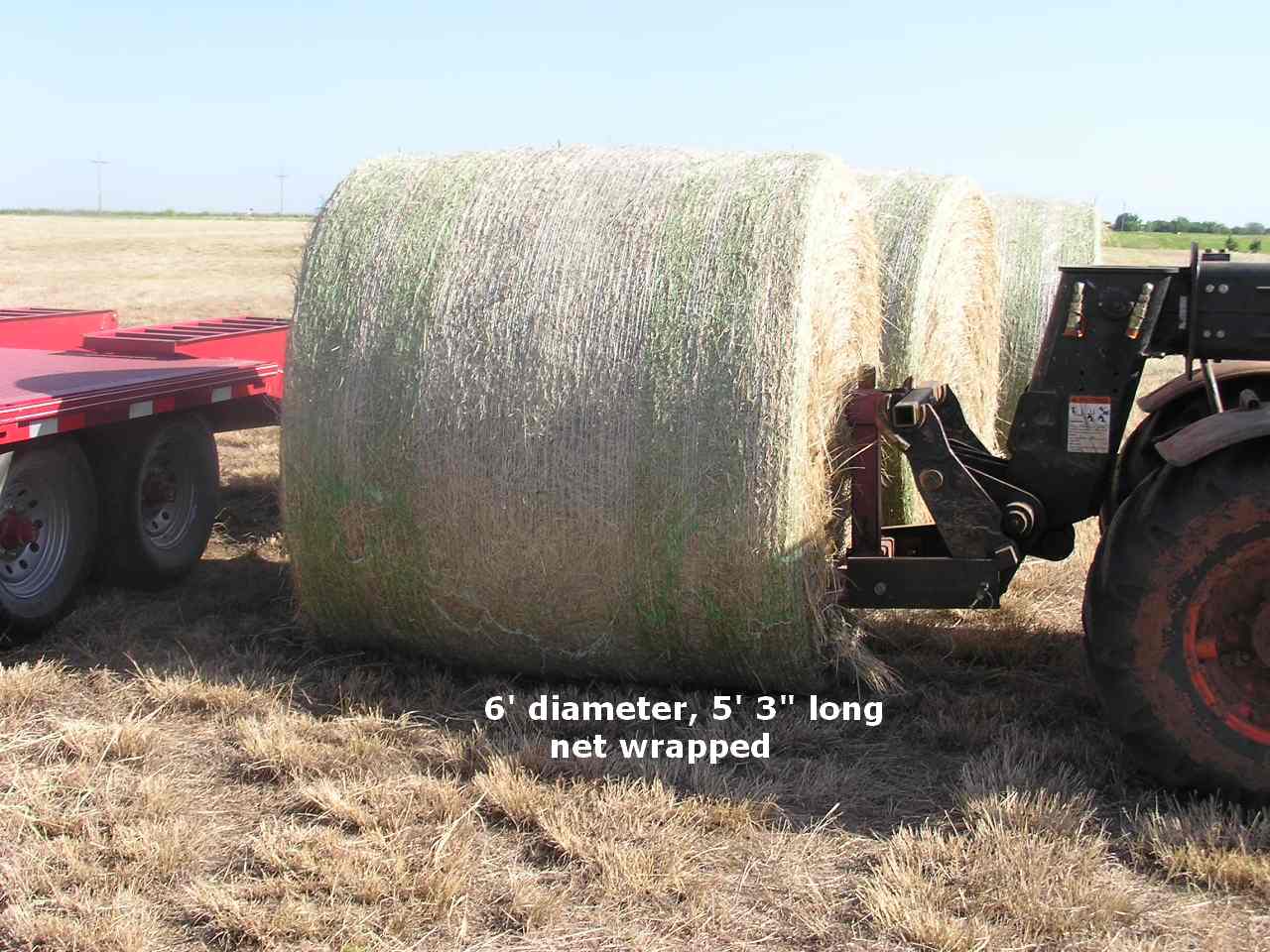

We use round bales and like the fellas said you need at least 2 spears, although one of them can be short as all the 2nd one does is stop the bale from rotating. I bought one at TSC but it was poor quality steel and bent. Make sure you get a better quality one than the "discount" brands. I have a few, got them at auction sales quite cheaply.
   / Hay Spears #12

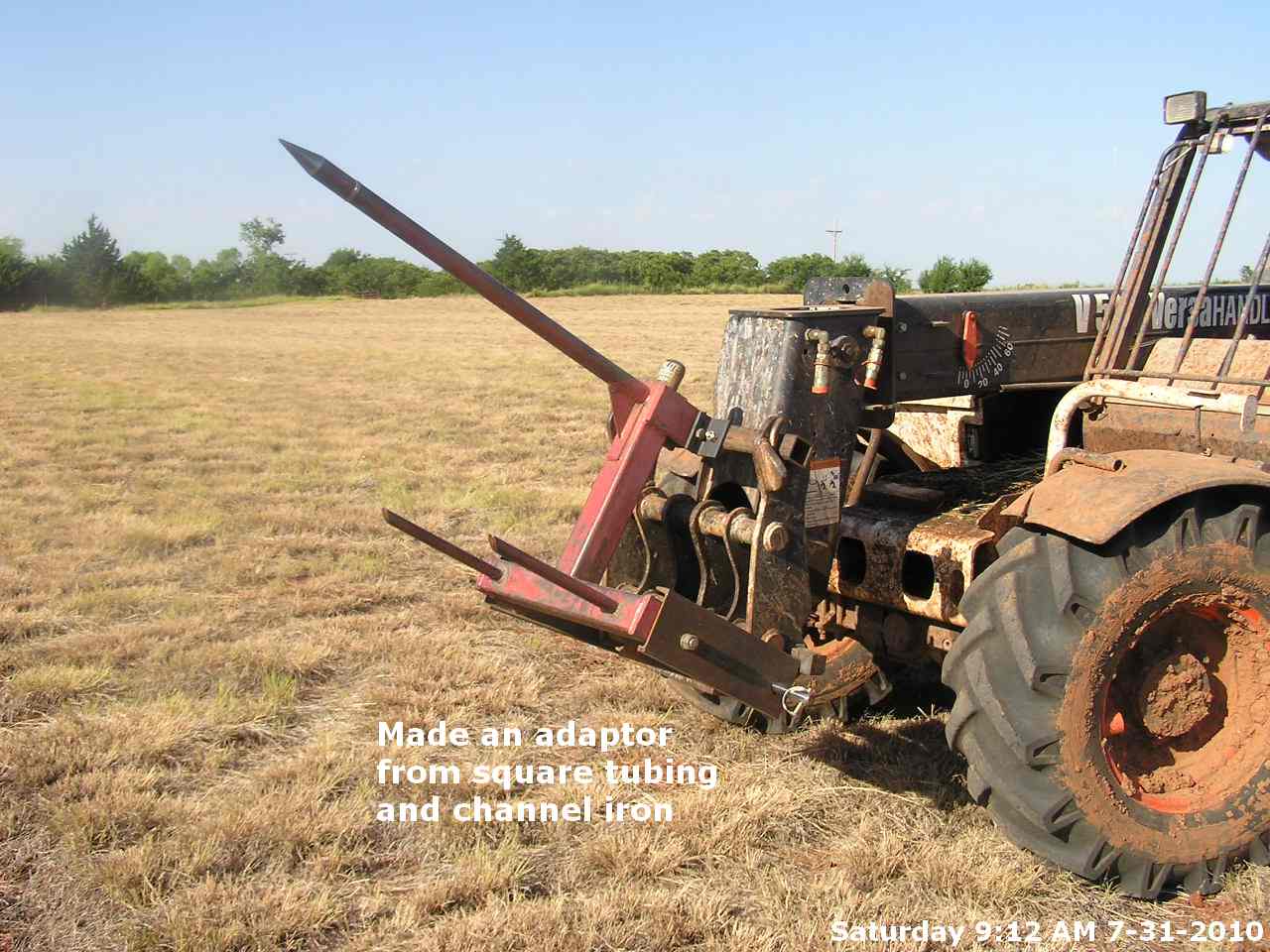

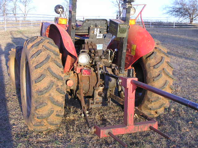

2 spears, both titian.
Front are pallet forks with spear + side stabelizers
Rear is receiver hitch/gooseneck mover with hay spear + side stabelizers.
Both attachments are multi use.
   / Hay Spears #13
Maybe look at a haying grapple. Yours looks to be more of a brush grapple. You can get them with enough reach to grab both sides of the bale.

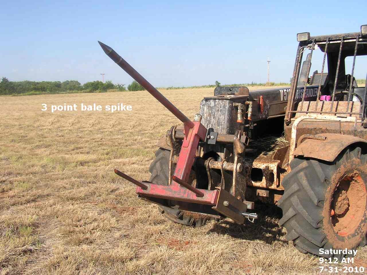

With a backhoe I'd only get the front spear. Either a double spear design or a 3 prong design. With the 3 prong design the vertical distance from the long spear to the short ones is important. It its really close they don't stabilize the bales and the will rotate. To far apart and when you spear the center the short prongs are on the ground. Still same problem. I don't like the county line ones. I think they're too close.

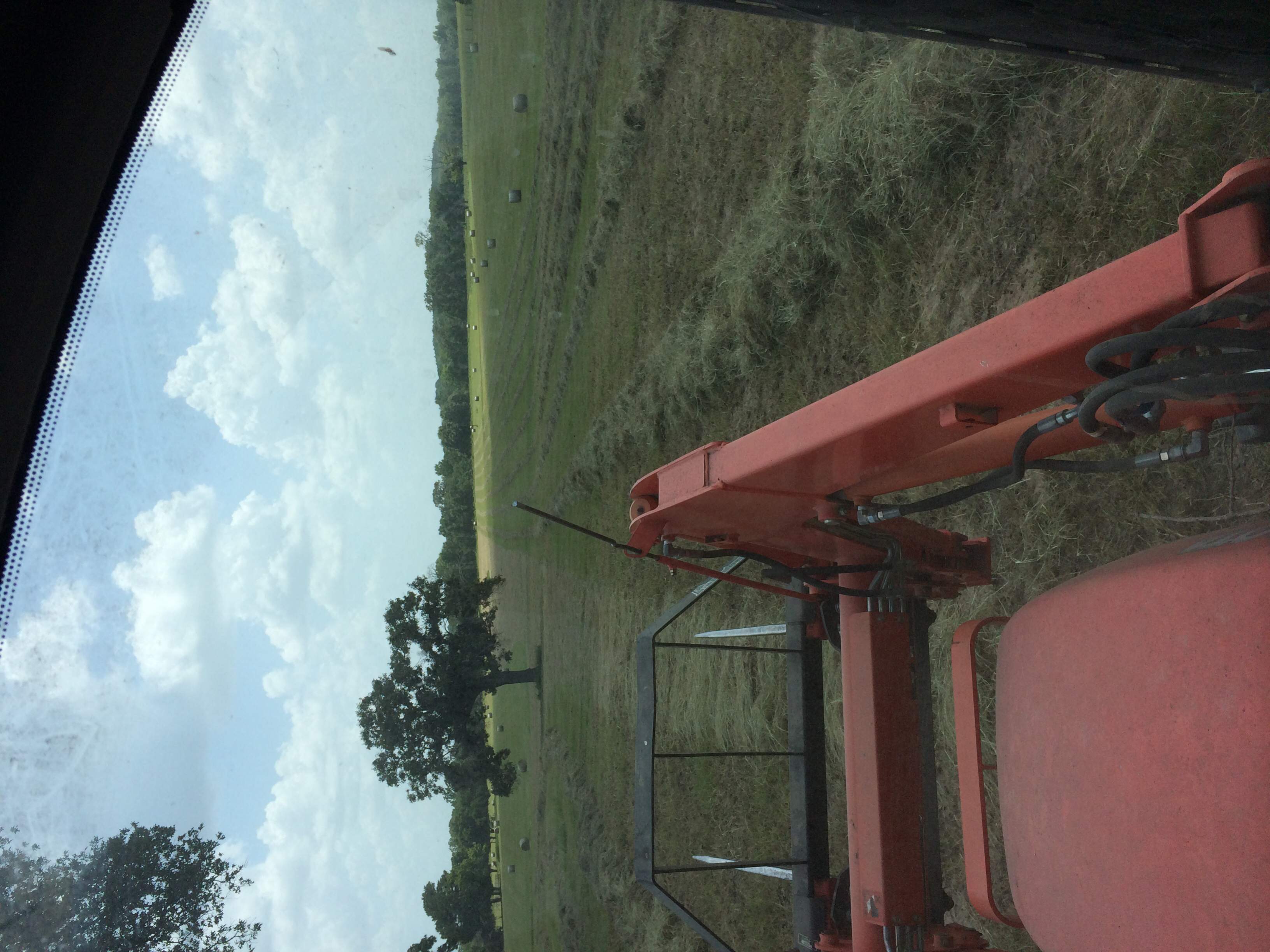

I like a 4 ft spear on the FEL, enables me to unload two 5 ft bales from the same side of trailer.
