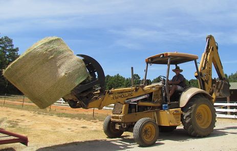

We're making that transition from square bales to round bales. Before every trying it, I thought I could pick up a round bale with my grapple. I could, but then it would start to squish together, then fall apart on me. By the time I got it from the trailer to the hay ring, it was a mess with more on the ground then in my grapple.

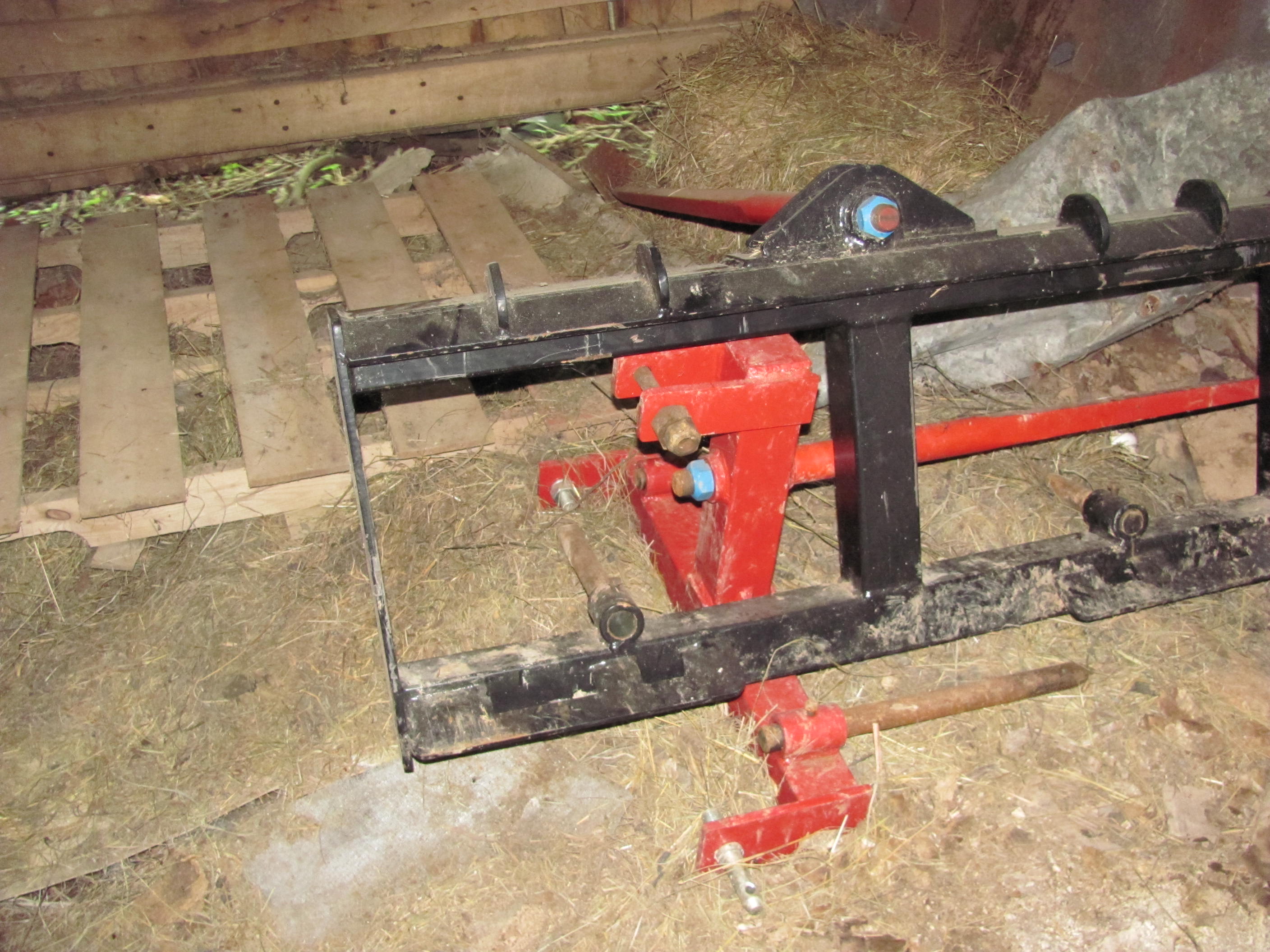

G'day Eddie... that grapple sure made a mess of the round. I wonder how you got the netting off of it.
Anyway, this is what I've got. The spears are replaceable and you'll notice that the spear assembly is detachable via the 'silvery' horizontal slides. That's because it came with forks that I can swap to... bloody heavy things but 'proper tool for the proper job', eh? I've seen a few bent spikes due to people thinking, "The spikes can handle that, why bother changing them out" = replacing a bent spike. ;)
