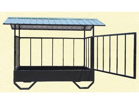

/ Hay feeder for large stock
Wife wants it on legs and a roof on it now.
"So I was thinking combine the design of these two things, possibly using pallets? The idea is to keep it off the ground, but also give the hay air to breathe, and keep it covered so that the sun/wind/rain doesn't bleach it/blow it away/turn it sour.
If you make one for us, I'll bet the neighbors will want one. I already know Diane wants one."
http://www.barnworld.com/cattle-guards/Horse-hay-feeder-from-poly-panels/

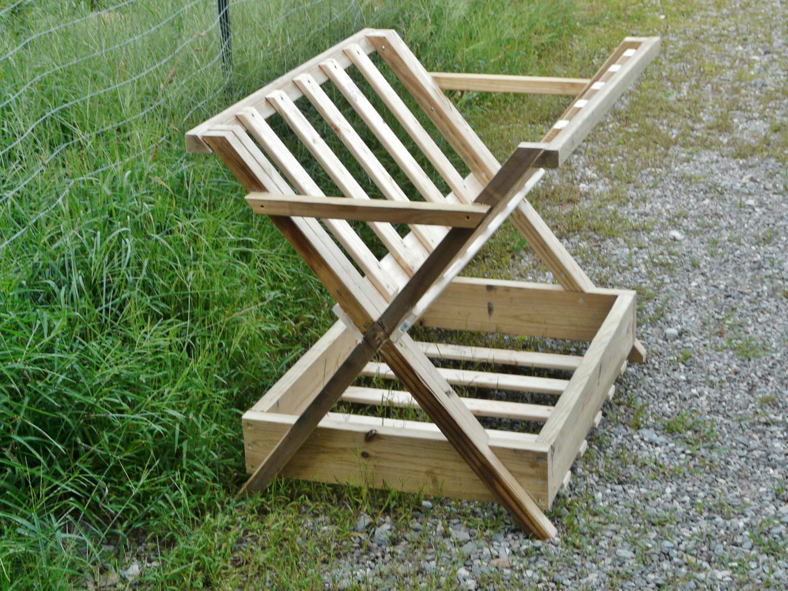

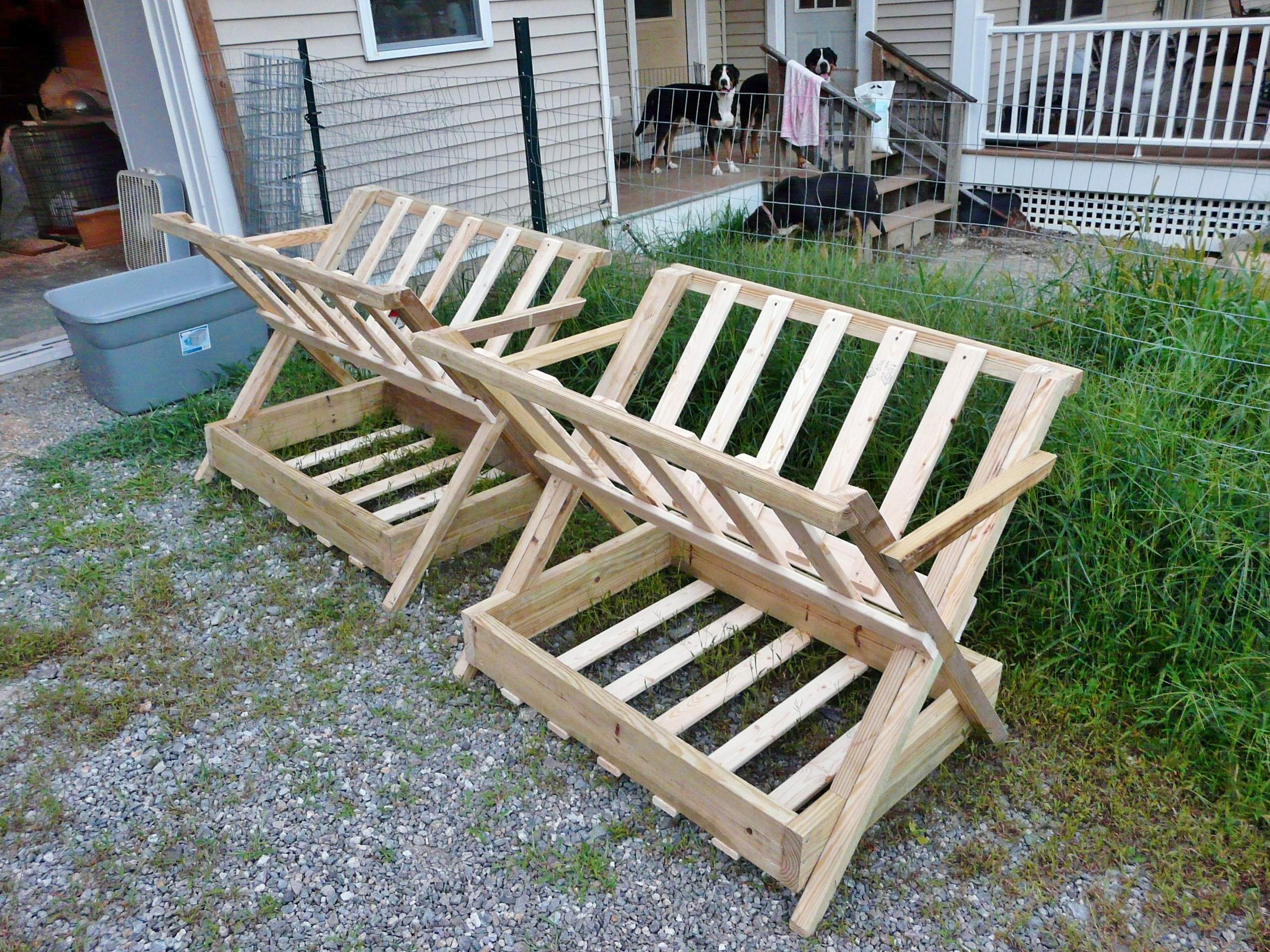

#12
Re: Hay feeder for large stock, What I built. (Photo's)
2 done two more to go.
$35.00 ea. in material.
The last two should take about 2-1/2 hours to build each. I'm going to rim the top with 1x3 pine straping so the horses do not nibble on the PT lumber.
Wonder how they will work with the cows?

/ Hay feeder for large stock #13
I don't think they will last long with cows,just my opinion.
