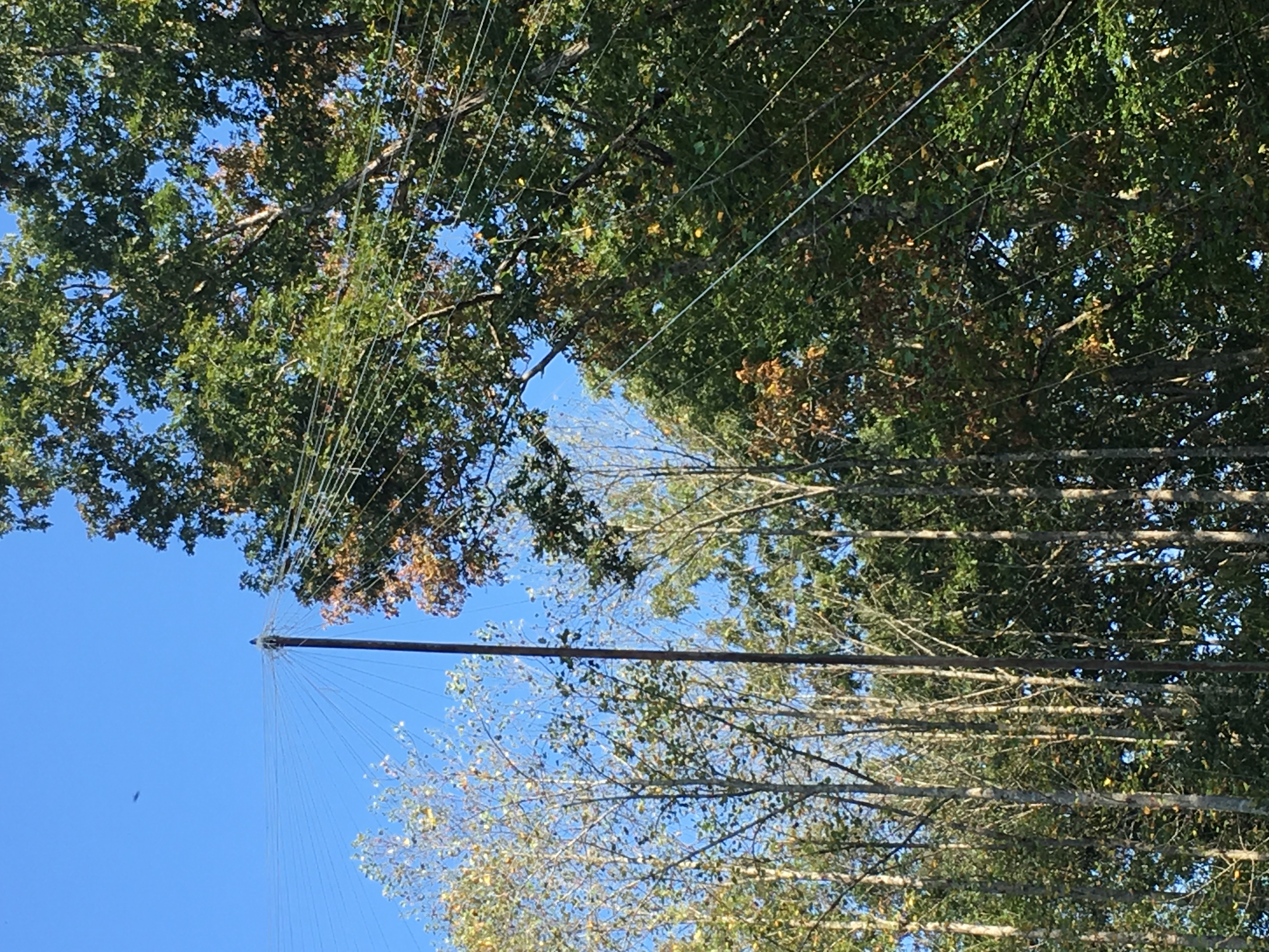

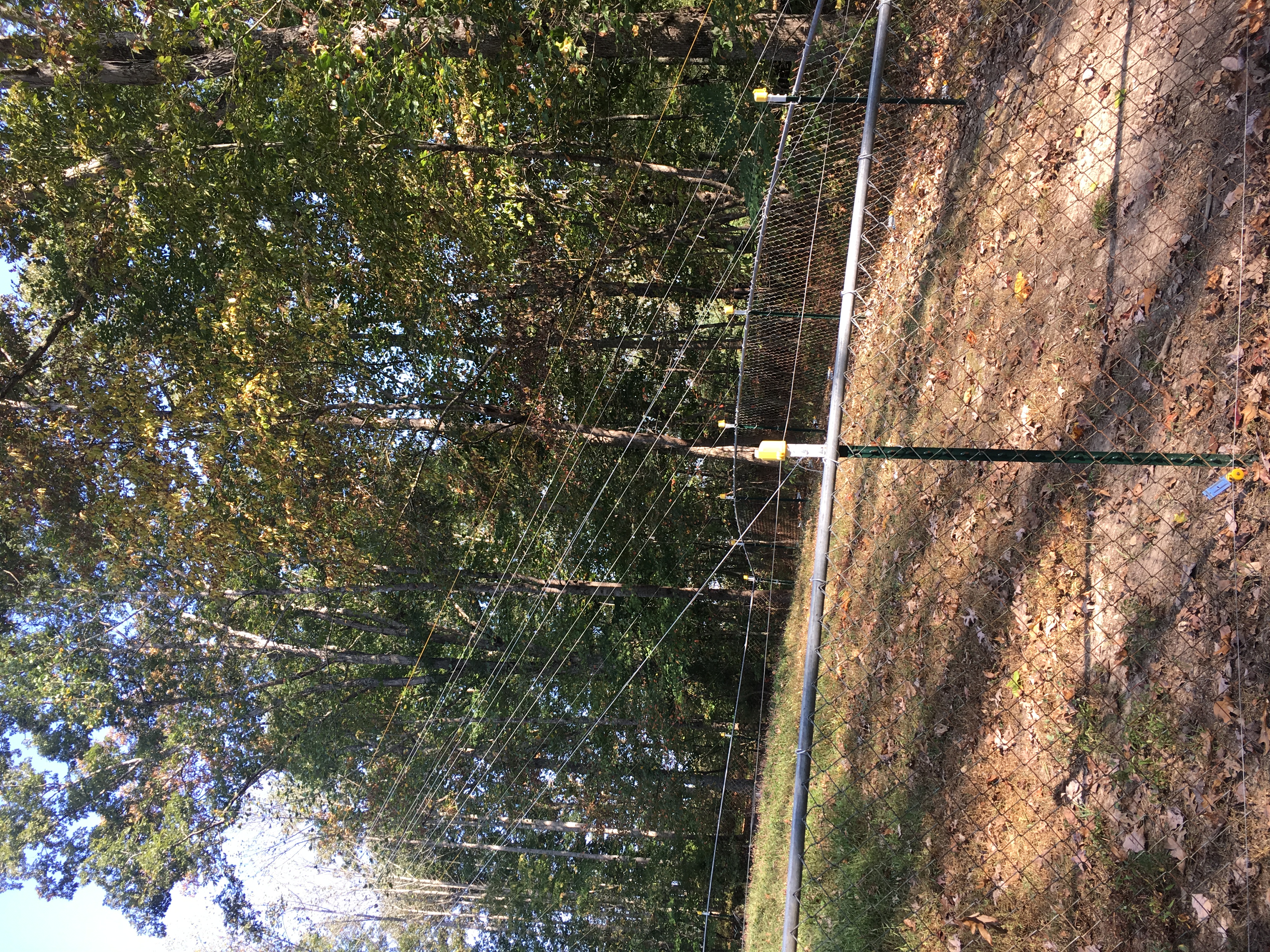

View attachment 628436View attachment 628437
After losing my rooster to a red tailed hawk I decided to try and come up with a solution. Admittedly the easiest would have been lead. I needed something that would work without me being there. I remembered seeing this from someplace before. I simply drove a short piece of chainlink top rail into the ground then inserted a full length piece into it. I pop riveted a post cap to the top to tie off to. Ran white nylon twine to each post and between. Since doing this I have seen a hawk try to get the chickens twice but flare off when he got close to the twine. Fairly cheap and so far effective.
That's smart. I have ducks. Hawks and falcons don't go after the adults but will after ducklings. In the summer I lost 3 ducklings at once to a falcon, and then had to put a 4th down from injuries I was hoping he'd heal from. That falcon was a jerkface about it too, he came back a couple times after, looking for more ducklings, but I kept them protected.

But they stay clear of the strings.
They will sit in the trees next to the run and never even try to go after the chickens now.
