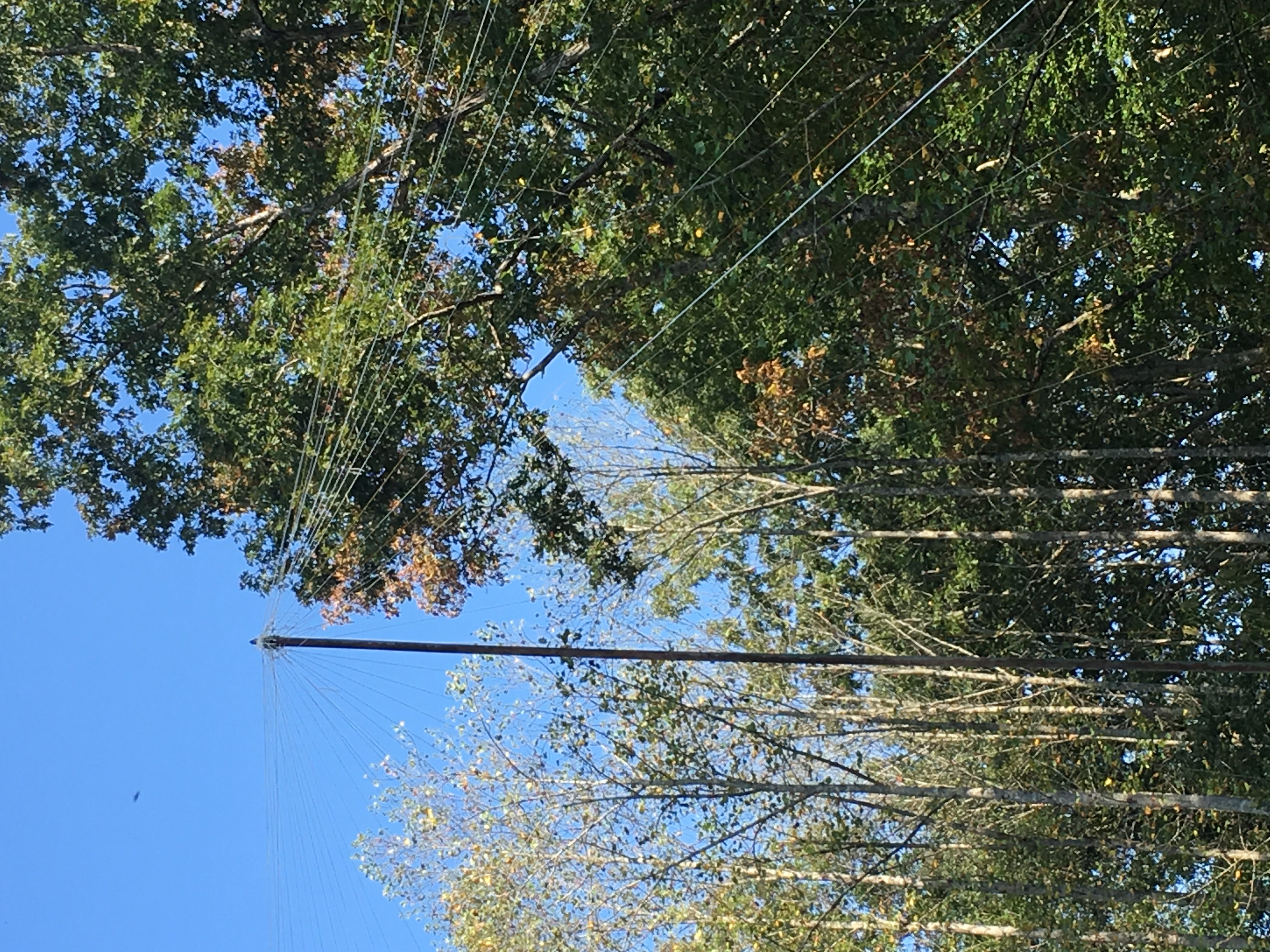

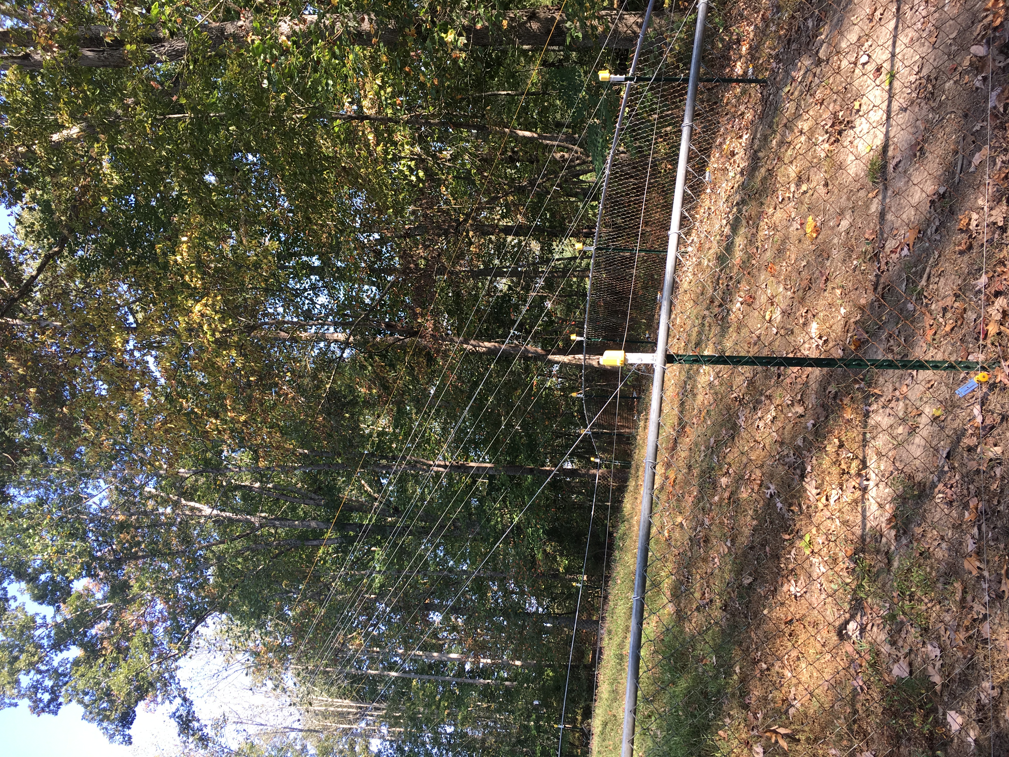

After losing my rooster to a red tailed hawk I decided to try and come up with a solution. Admittedly the easiest would have been lead. I needed something that would work without me being there. I remembered seeing this from someplace before. I simply drove a short piece of chainlink top rail into the ground then inserted a full length piece into it. I pop riveted a post cap to the top to tie off to. Ran white nylon twine to each post and between. Since doing this I have seen a hawk try to get the chickens twice but flare off when he got close to the twine. Fairly cheap and so far effective.

Very ingenious idea!

That looks a lot simpler than the mesh netting we used to use over the chicken, wild turkey and ring-necked pheasant pens my parents had when I was growing up .....granted that mesh netting was also needed as part of the "fencing" to keep the animals in the pen.

I did something similar three years ago. I tied a long rope in between two large trees on either side of my run area and then zig zagged masons line over the top. Seems to work well. Consider something UV resistant, I found the masons line lasts about two years in the sun.

I ate at a restaurant on the water one time. They combined what the OP said and what Farmer Phillip mentioned. They had several strands of film from the old VHS tapes crisscrossing over the tables. They didn't have nearly the number the OP shows, but they had them crisscrossing. They would twist and did an excellent job keeping the birds away.
