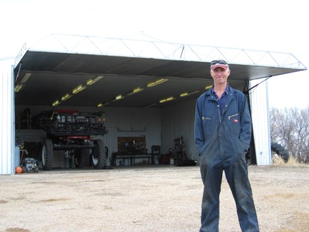

If your going to have sliding doors put them on the inside instead of the outside of the wall.
This keeps them out of the wind and snow.

I cant say I have ever seen sliding doors on the inside. :confused: Sounds good if you have the building width......do you have a pic? How do you seal up at the floor if you have concrete?

I will get some pics.
As far as sealing it really isn't much different from being on the outside, neither will seal very good.
To the OP I would pour a floating slab and put the building on top instead of having posts in the ground to rot off. We have done several like this and it works very well.
Which would mean keeping that portion of the inside wall clear of stuff ?
Or like a pocket door ?
Don't the rain blow in or is there a large overlap ?
Yes, pics please. :)

The advantage may not be as great for a shop with a concrete floor.
I was thinking from a machine shed point of view where the doors are open as much as they are closed. With the doors on the inside the wind doesn't beat them up and you don't have to fight pushing them through snow on the outside.
