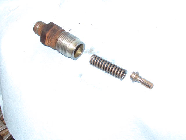

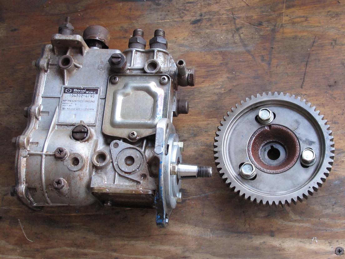

Well I am not sure of your injector pump but, on my 1700, I had to remove the fuel line from the pump that feeds the cylinder. Then remove the fitting, spring and plunger where the fuel line connected. I turned over the engine by hand and at the right point fuel flowed freely. I re-attached all fuel lines and removed the glow plugs. With glow plugs removed I used the starter until I could see fuel mist coming out the glow plug port. Replaced glow plugs and she fired right up. This was on a engine rebuild.
