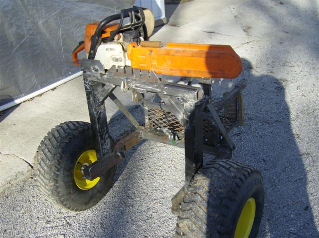

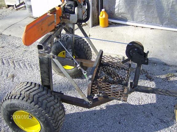

Make yourself a log arch! You'll want it a little bigger than mine, but they work great. ~~ grnspot
Do you have more detailed pics or build details. Have a BX 23 and using backhoe drag method is not very efficient.:laughing:
I made it from parts & scrap I had on hand, including rear wheels from a parted out lawn mower. Cart behind holds up back of the log, just make sure you can stop it! ~~ grnspot
