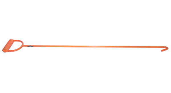

I was going to say it helps a lot to put a slight bend in the leader pin (or whatever it might be called) so that when you push it under a log, it wants to curl up on the other side vs diving into the ground.
I'm also going to suggest you stay away from 1/2" chain and stick with 3/8" Even 3/8" is flippin heavy. 1/2" is insanely heavy

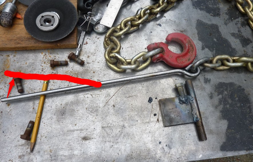

For my chain chokers I'm using 9/32 G100 chain. It's rated for 4300lbs overhead lifting, proof tested to twice that and ultimate strength is four times the overhead rating. My winch is rated to pull at 7700 lbs.
It cost a little more than cheaper grades but it's lighter.
The place I bought it from got bought and no longer carries it. Mine came with the slip hooks installed and I made my own pull rods out of the scrap box.

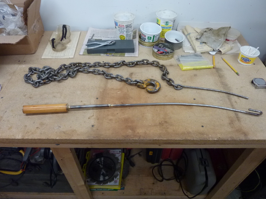

I actually got a couple of 1/4" chains for longer chain work because having something lighter was looking real convenient after hoofing around some 3/8" for a few hah. 3/8" chains are indeed heavy as hell.
I bought four 5/16 chokers under the theory I was unlikely to actually use the full capacity on any single log. I could see having one or two 3/8" as maybe being useful but if I'm pulling out one log over 4000lbs .. things have already gotten fairly serious.

It's been while, but I think I actually have a mix of 3/8" and 5/16" now that you mention it.
Adding the bend in the rod has a major impact on ease of threading the chokers under the log, IMO. This work is physically hard enough as it is. One less thing to fight...
