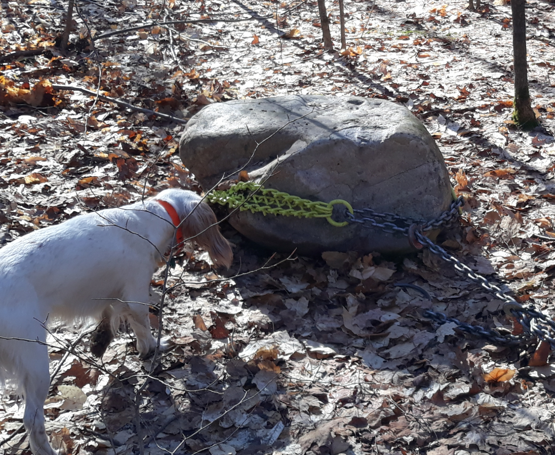

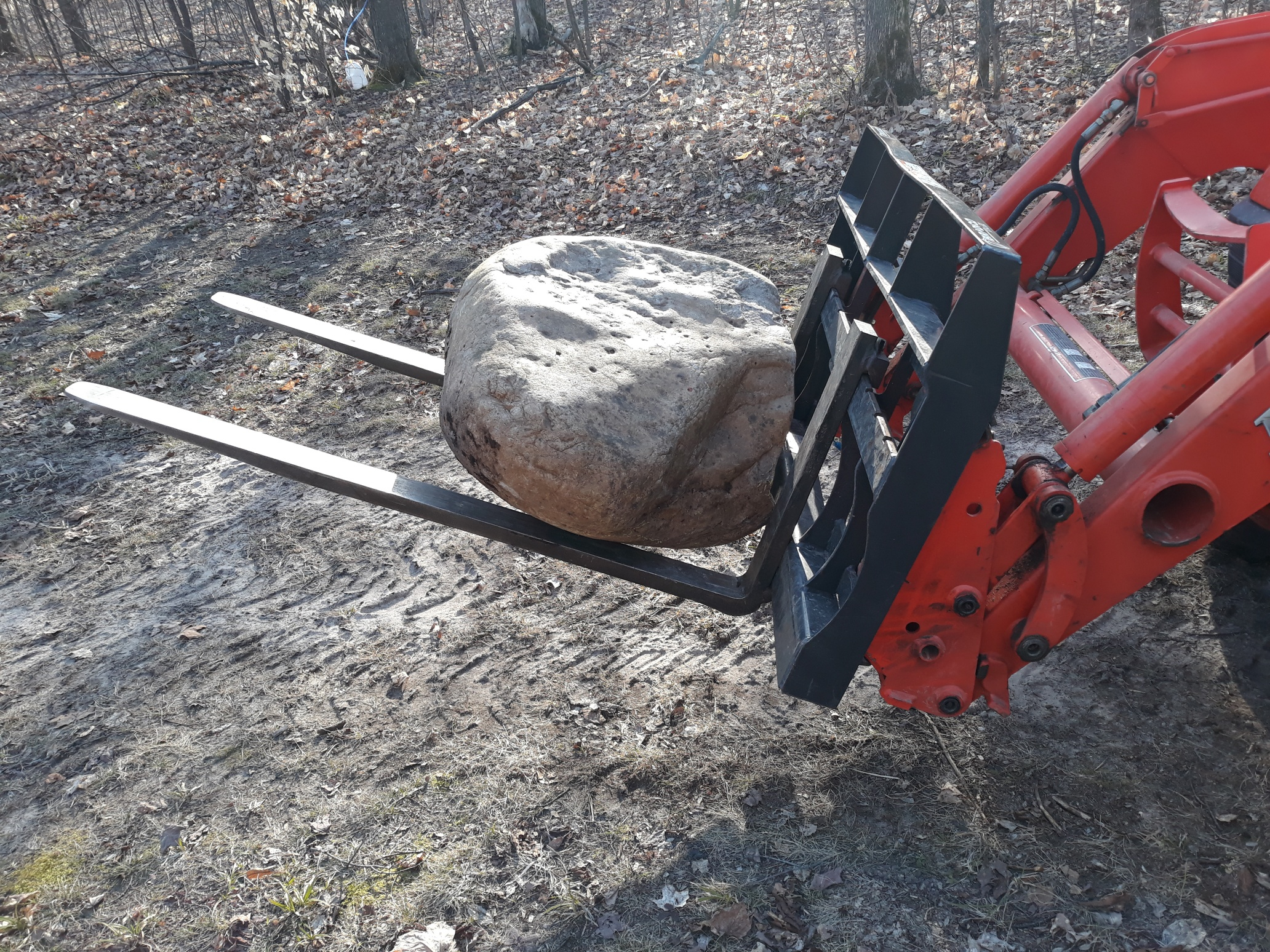

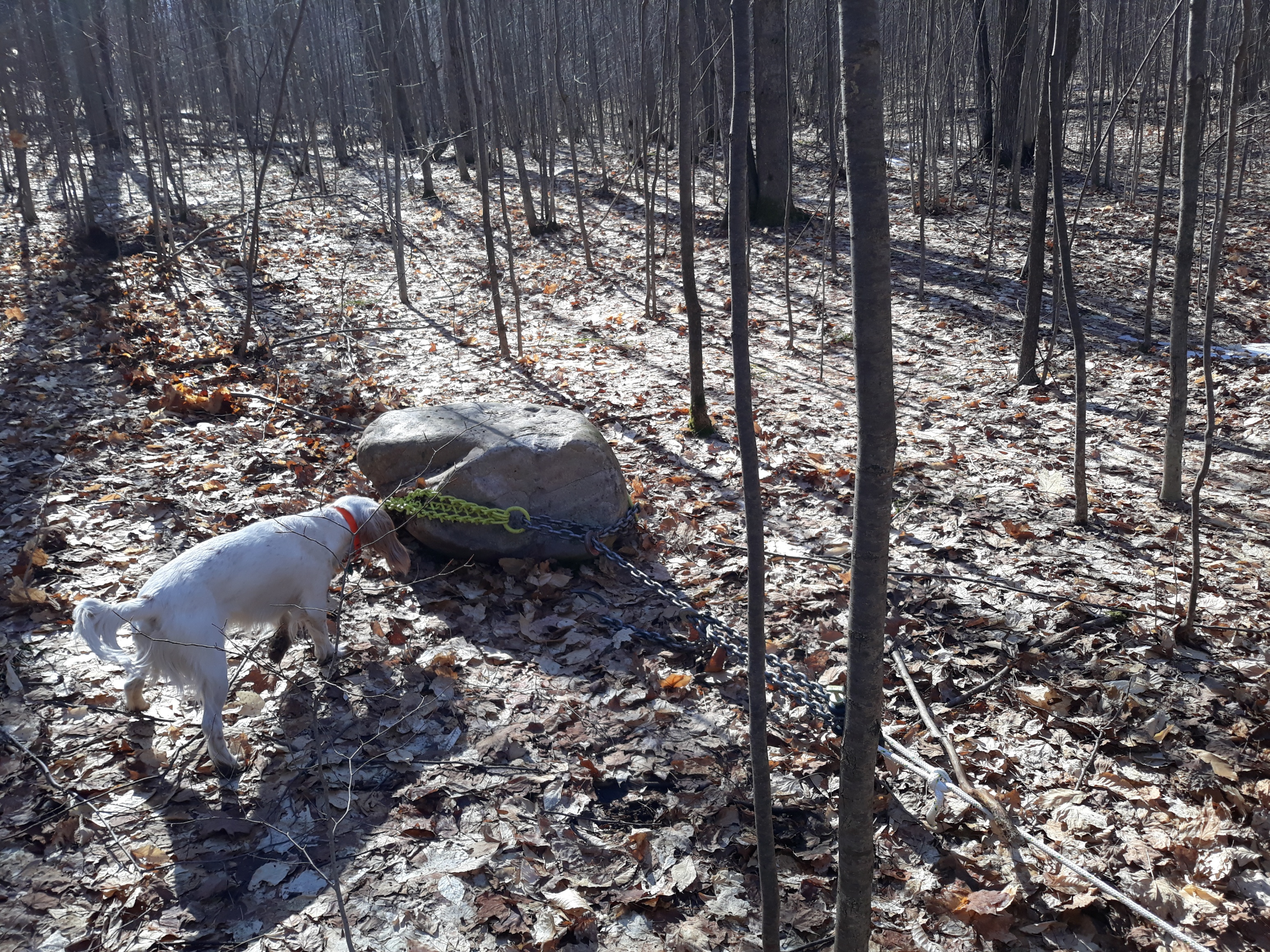

I got oil into the PowerWinch today and let idle for 5 minutes like manual says. Loaded up some stuff and headed to the woods. Idea was to try winch out on a pudding stone rock that the wife wants around the house. Got the B26TLB as close as possible, but not able to use it to pull the rock out. Using the PowerWinch tied to a clump of small maples, and a grub style chain around the rock. Grub chain has three strands and a ring at each end. Another short chain to connect grub chain to the 1/2" pulling rope. Used an extra pulley to change direction. Had to relocate winch a couple of times. Tried to carry the rock in the backhoe bucket. Just could not get it to stay there. So had to back to the house and get the forks.
PowerWinch has a low oil alert which I tested to when pullint this rock. Winch twisted to its side on the strap to the clump. When pulling, the winch is suspended in midair.
Will try it on logs/trees in the near future. Jon

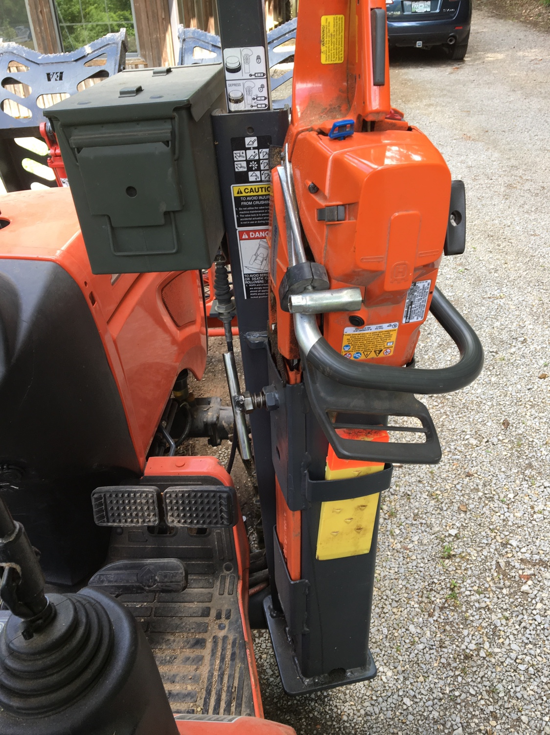

chainsaw, chain box for B26.

Smokeyddog, I like to use the B26TLB back hoe or loader bucket when possible. The above rock was about 75ft from a trail with a bunch of saplings we didn't want to cut down. Once by the tractor, I still could not get the rock captured with the backhoe bucket and hydraulic thumb. Sometimes I can get the rock against the hoe's lower arm with the bucket getting off the ground. Rock would not cooperate though. Found an even larger one the the saplings will have to be cut to use the backhoe to dig around it to see the size. Jon

Rocks traditionally do not like to be moved by tractors, I spend more time "capturing" rock than it take to actually move it.... Been thinking it might be nice to get some old snow chains and make up a sort of basket to capture rock....

The tire chain idea is what got me started thinking of how to creat a basket. The I remembered I had the grab style pulling chain for pulling out small saplings. It has three strands of chains to wrap around the rock, but reaaly need some cross chains to keep them from spreading to far apart. Jon
