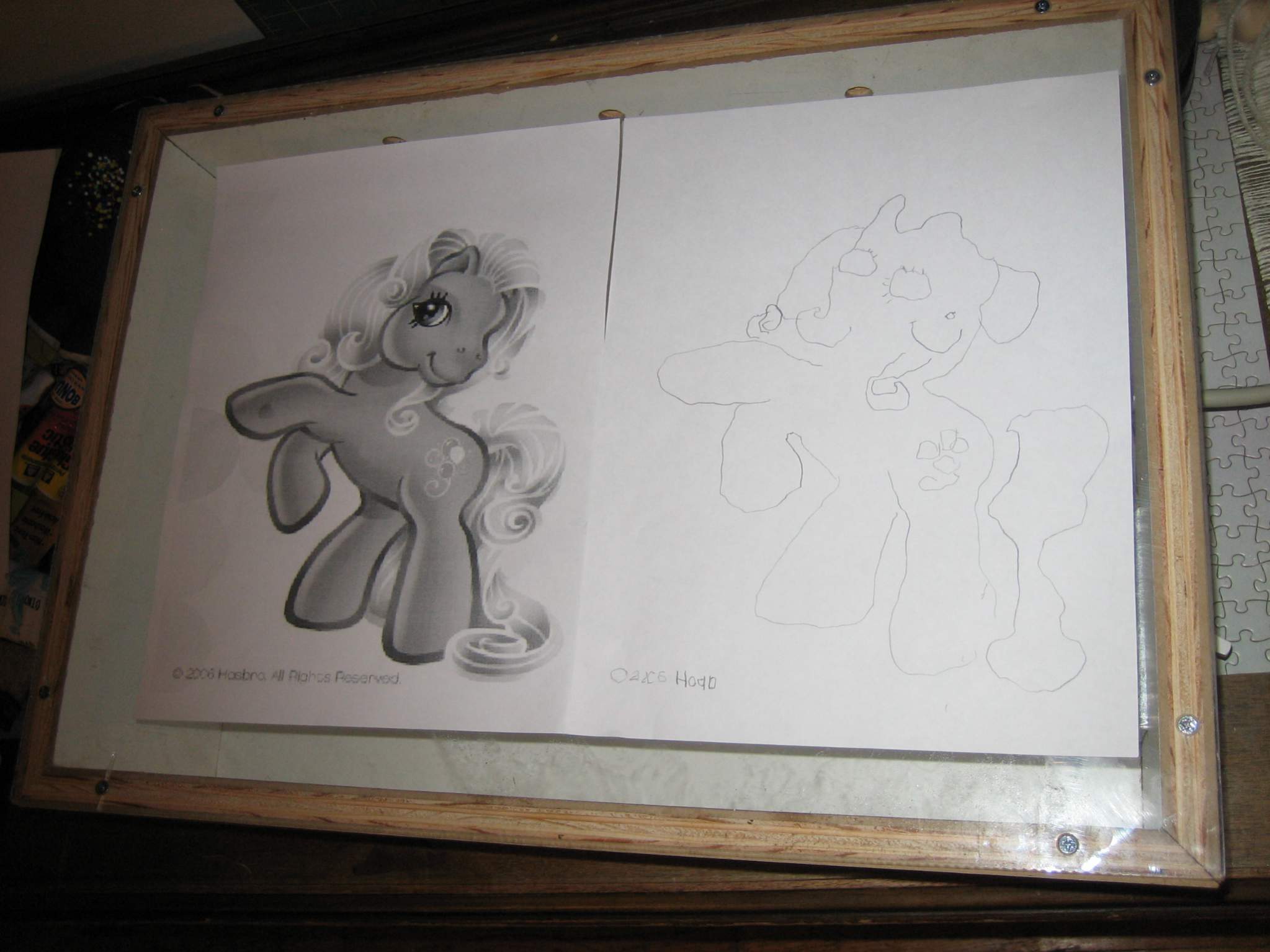

Here's the finished product. I decided to leave the glass clear and see if it works.
I tried to center the light in the middle of the box, but it looks like that may not have been the best bet. This particular light casts the light directionally and leaves one half of the box darker than the other.

/ Has Anyone Built a Light Box? #30
No problem, just move it to the rear and claim the extra hole was for venting purposes. Admit to nuttin!
I believe you'll find you'll need to make the plexiglas opaque.
/ Has Anyone Built a Light Box? #31
Can you rotate the fixture so it stands on its narrow edge instead?
Lookin' good, tho! :thumbsup:
#32
I could stand the light on its narro edge if I attached it to the back "wall" of the box.
My 5-year-old daughter did the first test today. I got her approval.
(If anyone was wondering, my daughter's drawings are the ones on the right.)

/ Has Anyone Built a Light Box? #33
I might remove the diffuser from that light when I moved in into the corner, but that is just me.
#34
Aaron Z
I think the diffuser is what is letting me get away with a clear cover (vs. white translucent).
/ Has Anyone Built a Light Box? #35
Nice build on the box. Looks like you'll need a diffuser and center the light.
