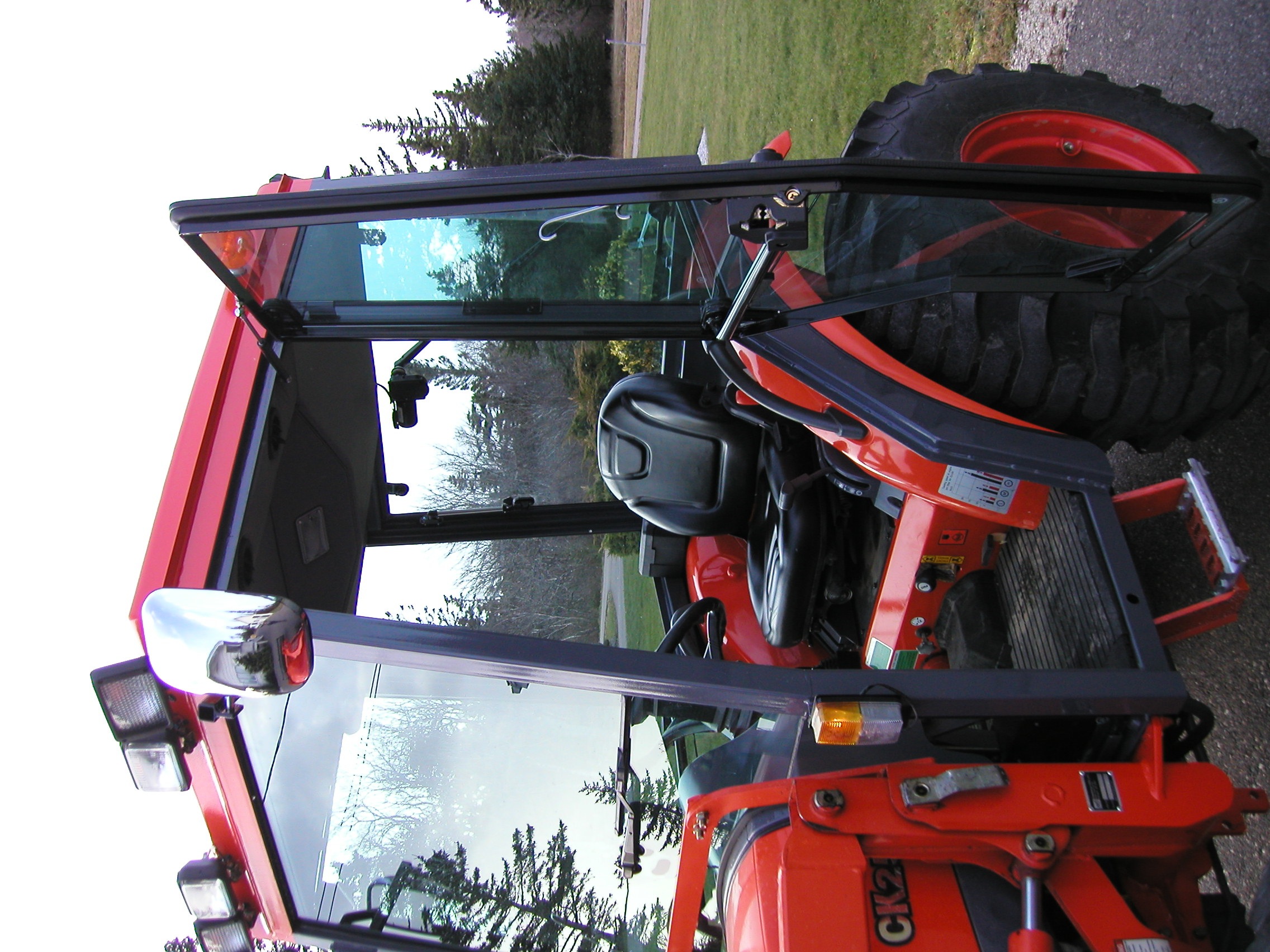

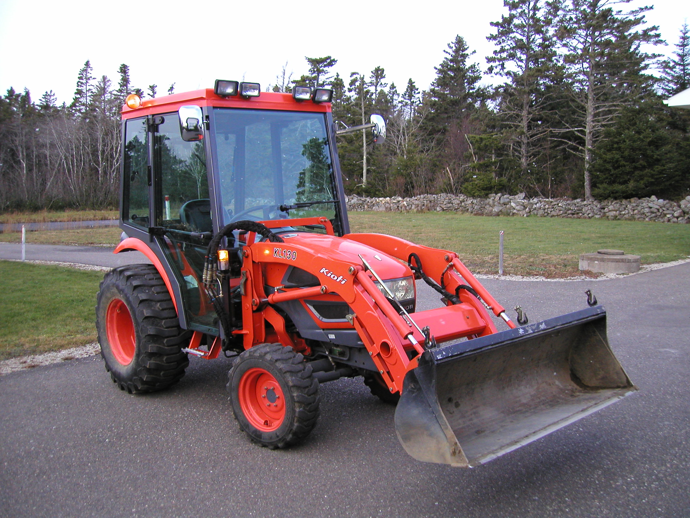

You guys have good ideas. I regret not buying the cab when I bought the tractor. Johndeere said I can't purchase the cab now because it is built with the tractor. I have been thinking about building one for a while and now that I have seen some of your projects I feel Inspired. I have a head start though. For some reason my tractor came with the windshield wiper switch. I just feel it is a shame for that switch to have nothing to do.
Just look at tractors at the dealers that have factory cabs installed. Draw up a plan. 2x2x1/8 square tubing, 1x1/8 flat bar welded to the side of the tubing to fasten the fixed glass to and a place for the door seals to seal against. Take patters of the openings and bring them to a local glass shop to order 1/4" tempered glass for all parts, just like OEM. Forget curved glass, can't be done for a one-off job. Save your patterns for if you break one in the future. Use automotive urethane (with black glass primer) on the glass or the glass may fall off the tractor in a week. After all is painted and dry install the glass. Just get into it. It can be done and its fun and rewarding.

XRJOHNDEERE,
I just finished my custom cab build on my Kubota L4200 and had custom tinted tempered glas cut, it was all flat and paid around $500 for it, I inquired about curved glass but like mentioned was not an option for a few pieces, Good luck on your cab, it is sooooooo nice already and I just installed the glass a week ago.
-Mike
Everyone is patiently waiting for photos of your completed cab!!!
Mike, get the camera clicking.:)

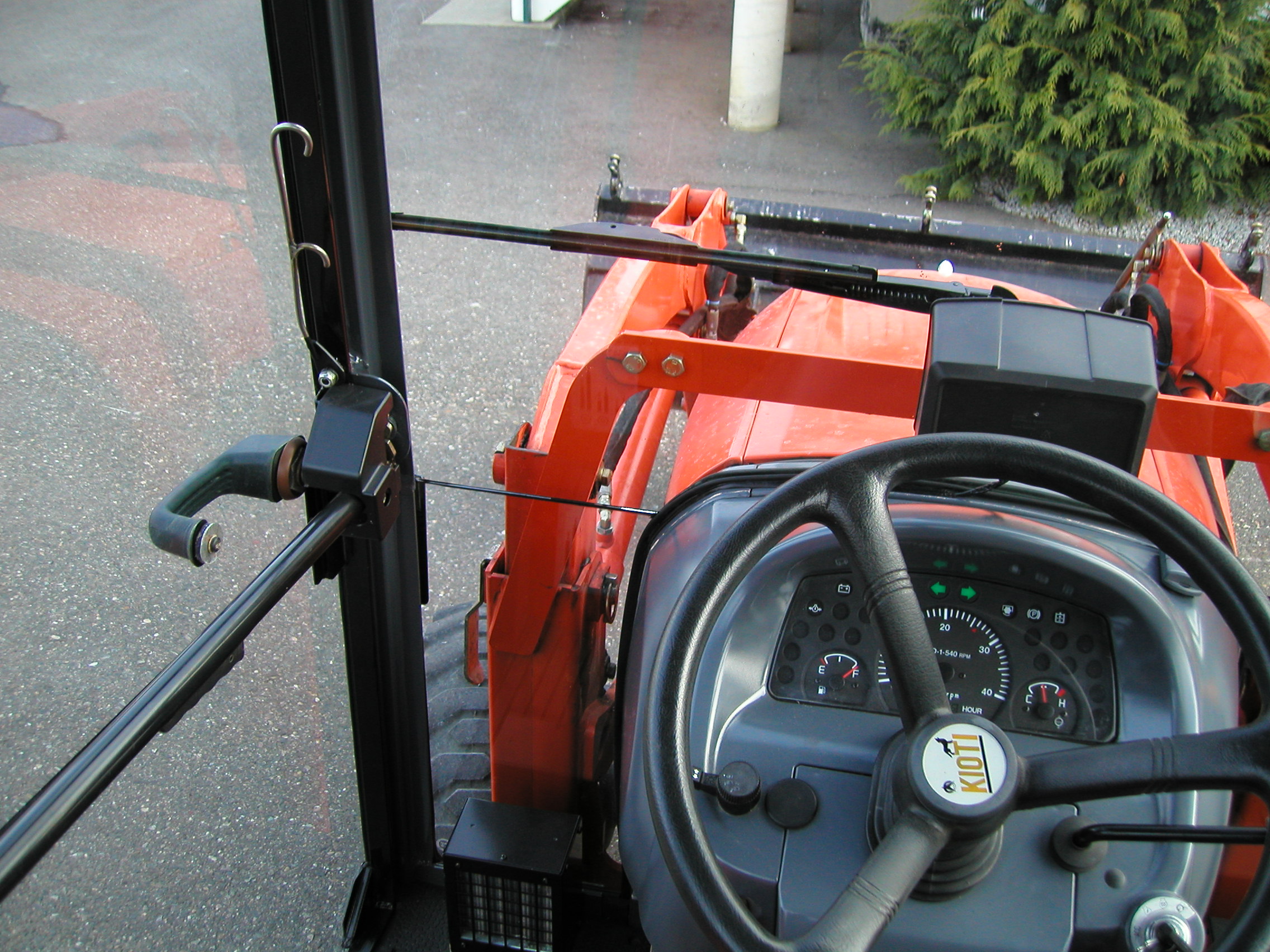

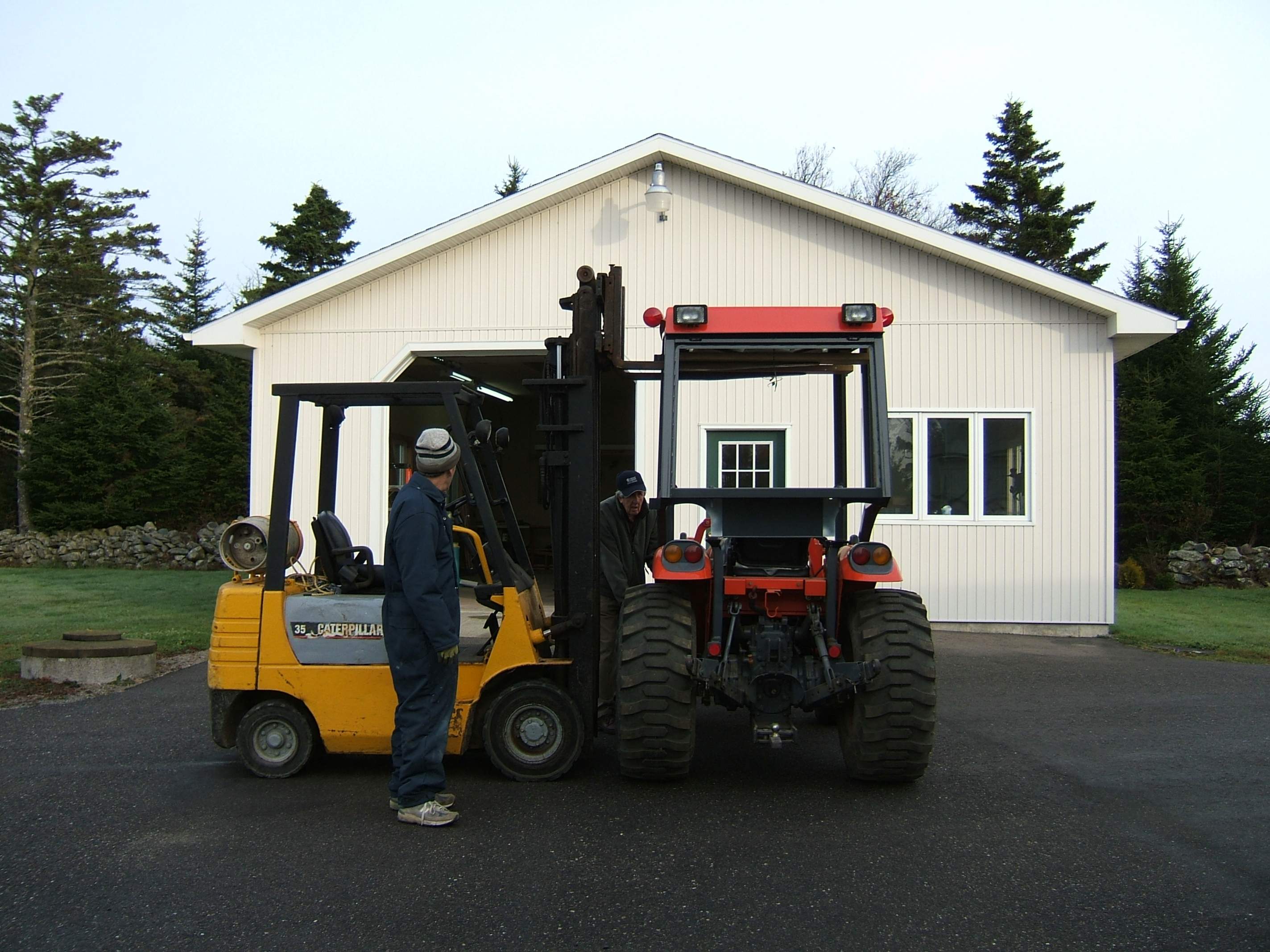

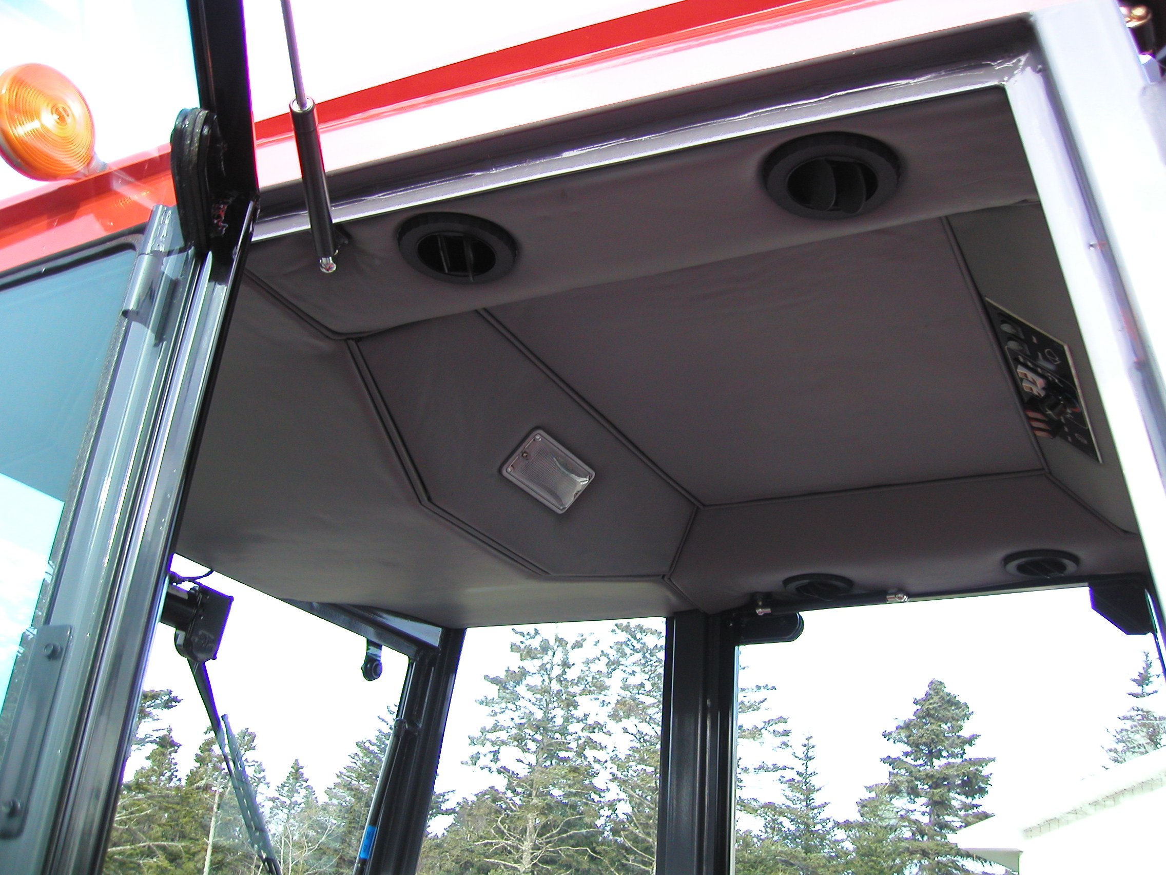

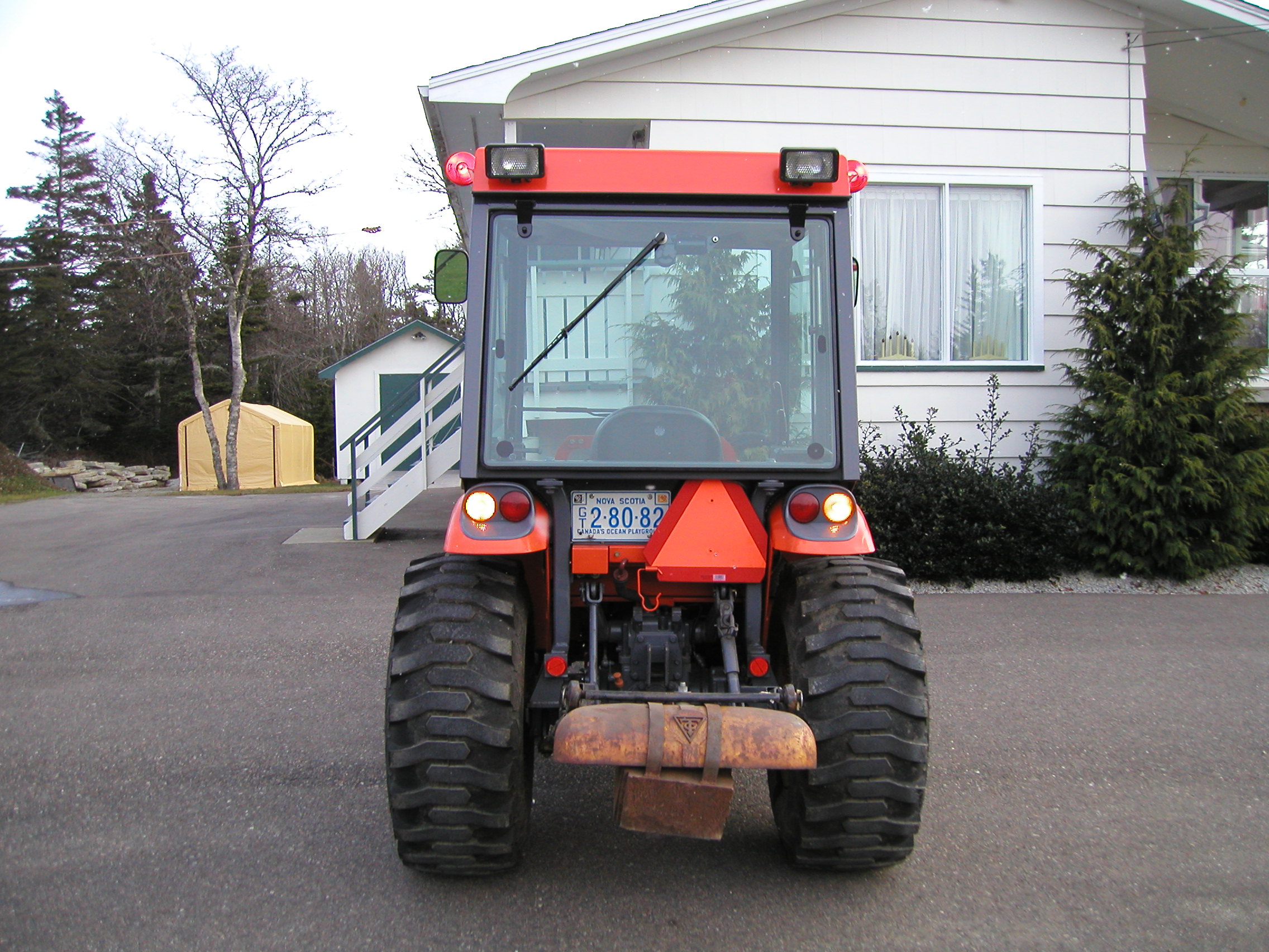

Deon that is a nice cab. I would like to see more detailed pics of it. Do you already have a thread with that? One question I have, it looks like you have plastic fenders like I do? Did you bolt that cab to the fenders and make them rigid? Also where did you get your door hinges, latches, etc.
   / Has anyone built a cab for jd 4520 #16
My fenders are steel. I placed a bead of urethane to seal the cab to the fender. Will need to cut the urethane if cab needs to come off. Cab is rubber mounted to plates I welded to the cut-off ROPS post and plates I welded to the loader frame. It is solid with no movements when using tractor on rough terrain. Made the hinges from cold role round stock and got the latches and roof skin from my old Sims cab that came with the tractor. Click on my profile to view previous post on this cab. I didn't take photos during the build which I regret now but here are a few more photos.

   / Has anyone built a cab for jd 4520 #17
One more pic that may help.
