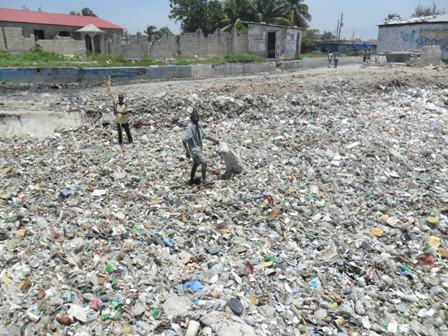

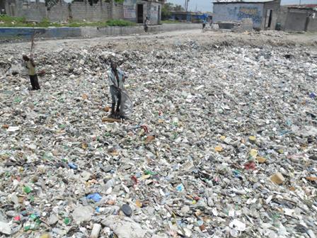

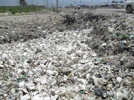

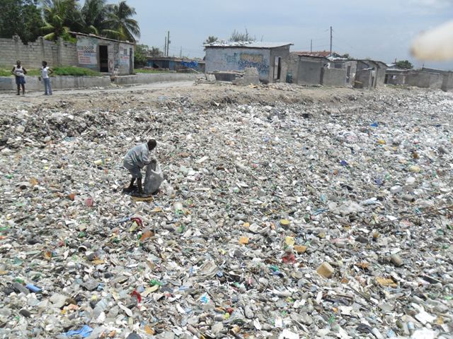

If you wonder why I'm here and what this is all about check out these photos carefully.
The photos with man in the middle of all the plastic trash?
You need to know some things about that. First you need to know that those pieces of foam he is standing on are acting like snowshoes. If he falls through the plastic trash he is in raw sewage. He's literally walking on water.
The second thing you need to know is he is recycling. Yup, he's cleaning up Haiti one plastic bottle at a time. You can see the difference his efforts are making, can't you?
You also need to know those pictures reflect your future because you won't have one if we don't clean this up. Most of that plastic you see is styrofoam products like food trays and cups. There's alot of film plastics in there too. These plastics break down into small pieces when exposed to sunlight very quickly. Ocean wave action increases this process of deterioration. Those very small pieces of plastic float in the ocean and our smallest ocean inhabatants ingest them and die. If we lose the smallest animals in the sea eventually the seas will be dead. So will the planet.
It would be nice if this one canal in PAP was the problem. It isn't. Most humans live along the coasts. Most of our worst living conditions are there also. Most of the trash on our planet finds its way to our oceans by way of seasonal flooding. Seasonal floods flush the roadways into the waterways and the water ways into the oceans. There is no natural way of processing all that plastic trash. It accumulates. This is a planet problem because every major city in the world contributes.

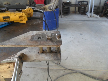

I'm usually a pretty good worst case scenario assumer. I failed miserably on this one. I brought a welding hood that I could lose, about twenty or so angle grinder cut off wheels, and some soap stone etc. I asked for a picture of their welding machine and wanted to cry. I really dislike lincoln tombstone welding machines. I brought some 1/8 and 3/32 6011 just in case.
When I got here I discovered I had three pair of vice grips for welding clamps, one of them coming from a wood working set. I have one c clamp, vice grip, three inch from the wood working kit. I can't weld when the generator is charging the batteries for the inverters. Grid power is spotty, appreciated, but spotty.

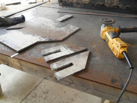

Then I got the good news. New metal is thin gauge and expensive. This I decided gave me an opportunity to make a statement. Anyone can make something when they have access to all of the right materials and tools, right? But if I could make the machines using what the Haitians would have as far as tools and equipment then maybe they would be more likely to do it.

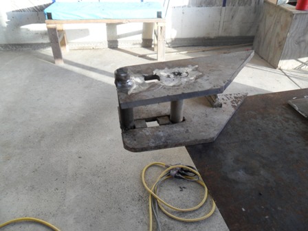

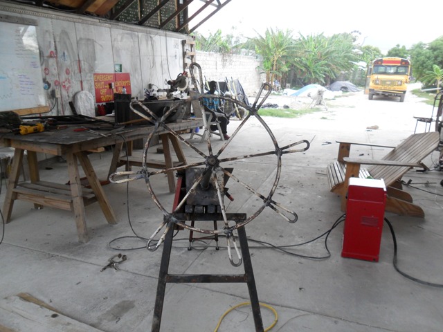

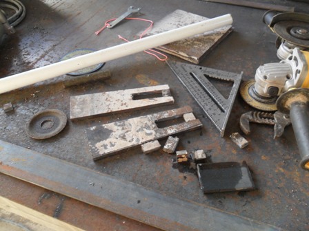

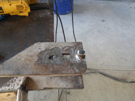

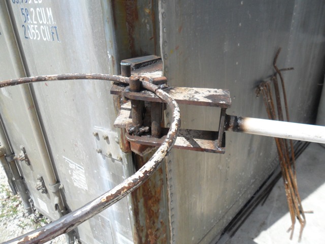

One of the tools I use the most is a simple bender. I needed one but there was a serious issue. I had a piece of three quarter inch rod, some three eighth plate but no drill bits bigger than a half inch, no torch, no files, etc and no more.
I have a skill saw blade for cutting steel that I brought with me. I cut three quarter inch slots and then welded back in plug so I had square 3/4" holes. They work.

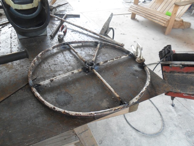

   / Harvey in Haiti
The bender paid for itself yesterday. I use a steering wheel, bigger is better to turn the acme threaded one inch rod to compress the plastic trash into blocks. I discovered quickly that I could probably make one a lot cheaper than finding one, save a ton of time too.
I have been taking apart steel scrap as I find it. One of the treasures was a window grill made from 3/8 and 1/2 inch round rod. I made a circle with the bender. Then I made loops and welded the loops to the circle.
whatchathink?

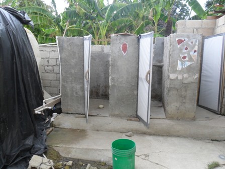

I forgot the toilets. The are compost toilets. You do your business in a bucket and cover it with rice hulls or sawdust. There are two of them here.
