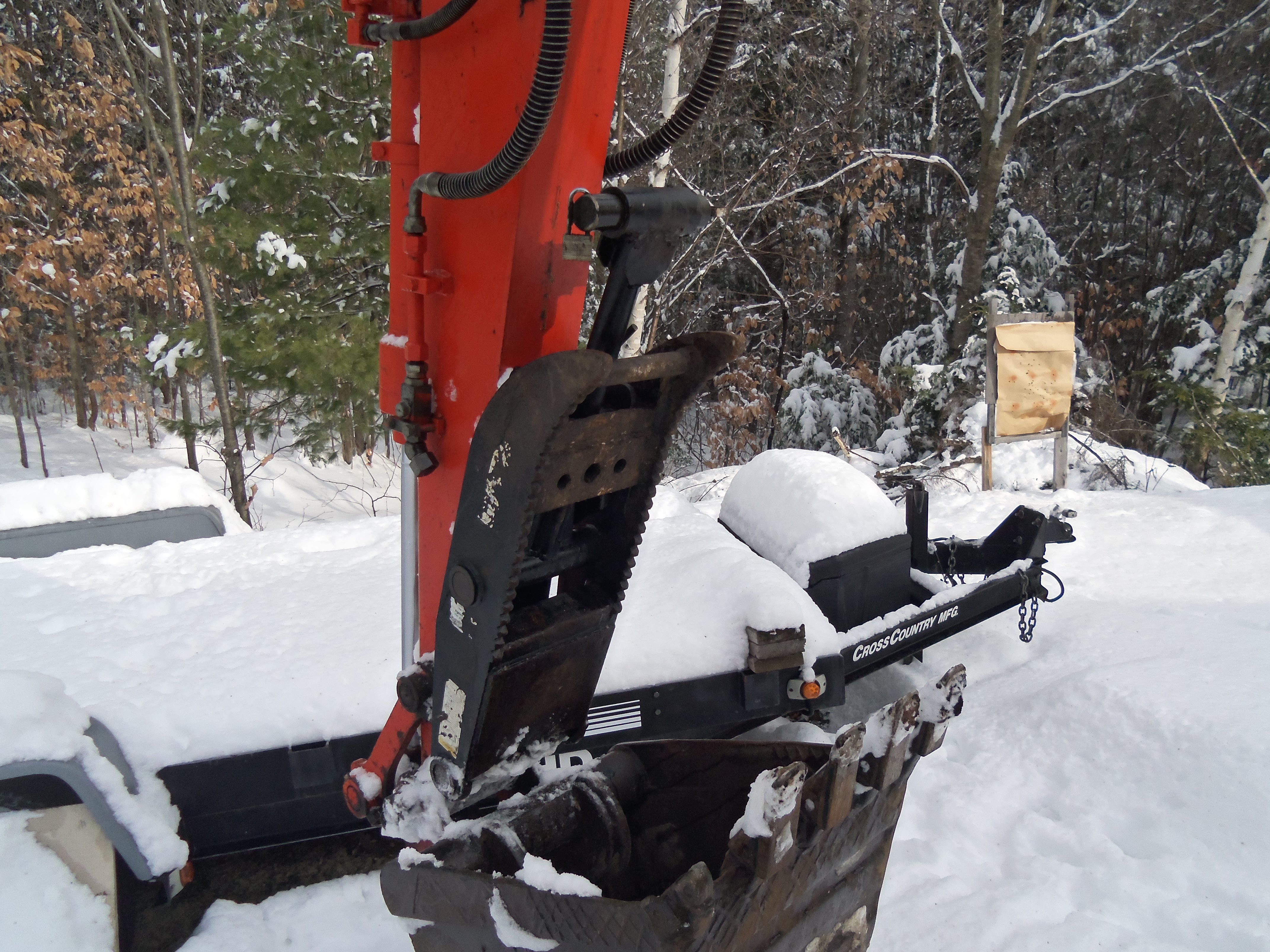

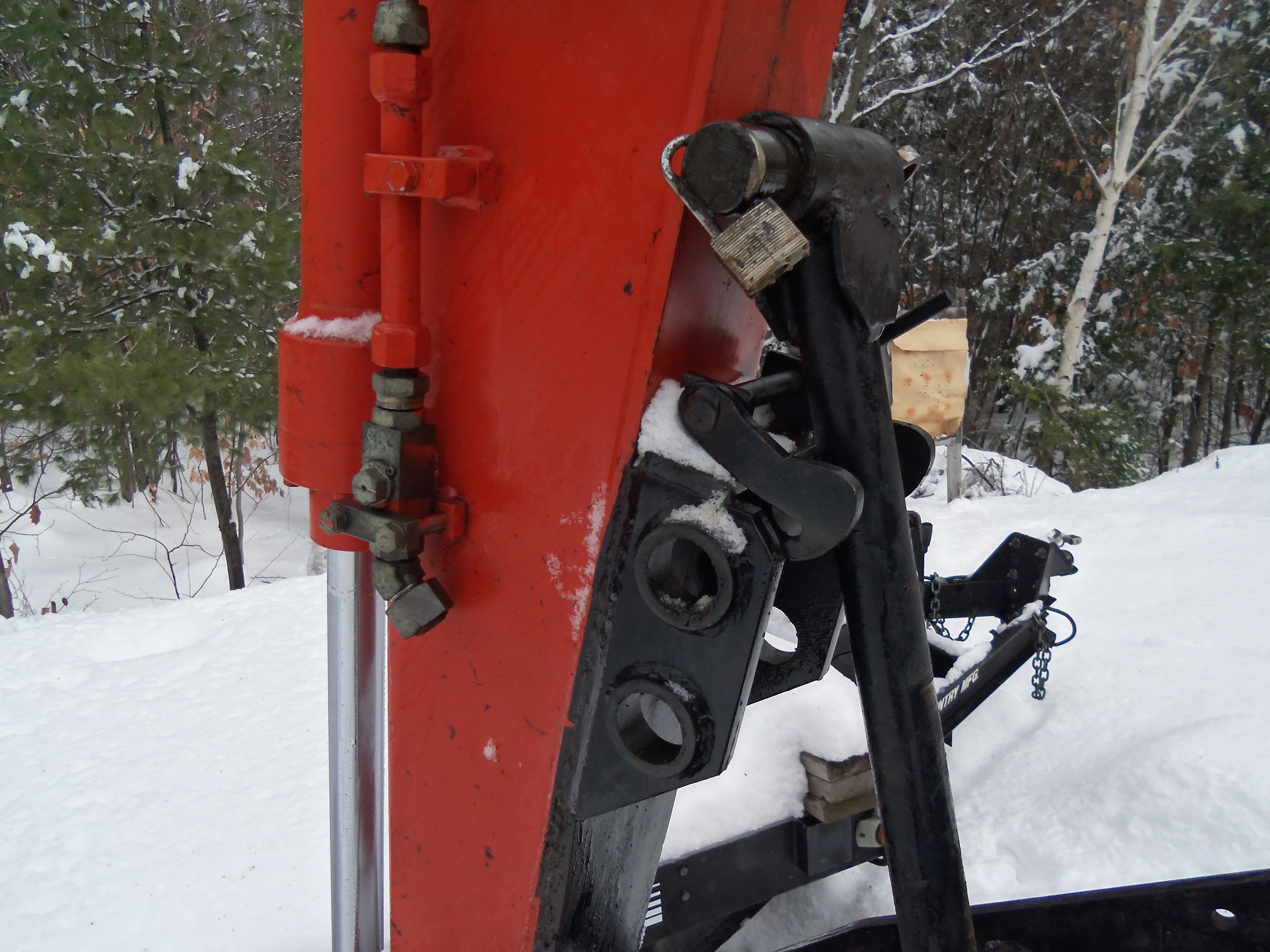

I would like to convert my mechanical thumb to a hydraulic thumb on my excavator (18klb) It presently has a solid arm with 2" pins. I will need to buy a piston and a bracket that I could weld to the thumb to retain the hydraulic cylinder end. Plus i will need some bushings to go from 2"od to 1" id for the other end of the cylinder. That is if my piston has a 1' PIN. Any suggestion as to who would sell what I need? Here are some pictures of my thumb.

I am actually looking to modify my fixed thumb to hydraulic. The excavator is plumbed so all I need is a piston and some steel plate to fabricate the mounts for the piston. I think I settled on a 3" bore,1.75" shaft with a welded cylinder and 1" pin cross tube type ends. I looked around online at other manufactures as to what piston sizes and how they fabricated the brackets. I have a stick welder and plan on using 7018 rods. My only question is preheating the thumb when I weld the brackets to it. I assume ar plate is standard? The steel thickness on the thumb is 3/4". Do i have to use ar plate for the cylinder mounting brackets or just cold rolled steel plate?

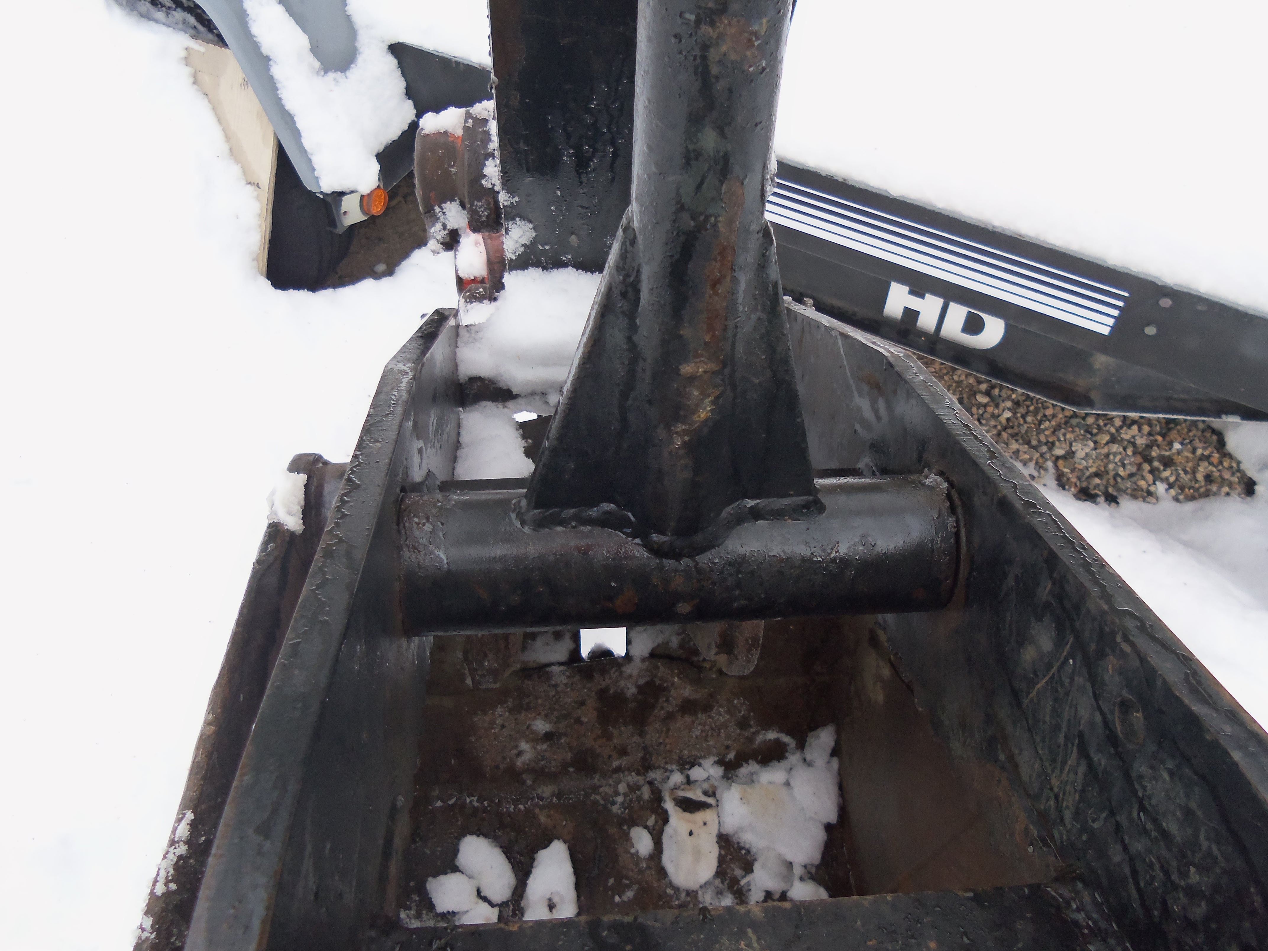

You see in my third picture above the plate runs the whole width of the dipper and it is 1/2" thick 7" wide. I took a round medium ******* file to the edge and it took the steel right off. I assume this is not hard plate and is regular steel like you stated. This would mean standard weld practices would apply?

I must be missing something, to me and I have a mechanical thumb. You need to find a cyl that is short enough when retracted to pull the thumb up and long enough when extended to have the thumb in place to use. I would think you retract the thumb and measure that distance and then measure the length of the brace you currently use to hold the thumb in working position. That should give you the retracted and extended lengths you need. Now if those numbers will not match a cylinder ok, change a mount. You need a cyl that has the capacity to hold what the bucket can push against it but not so strong you could damage the dipper or any part of the boom.

My mounts are too close to use existing mounts. I have to weld a new bracket on the stick above the existing mount plus a new mount onto the thumb cross bar. I figured the geometry today and have a cylinder picked out.

I thought when you check steel with a file and it bites it indicates non hardened or standard steel? I believe I am capable of completing this project. I will be using 7018 ac rod. By the way, great explanation.

Did you check the dipper? I'd expect a 20 metric ton machine to have a dipper of high carbon steel. A lighter machine might have steel of milder composition. In either case preheat is good. There is a point where preheat might be too much, but I believe in the 300F to 700F you won't go wrong. You can get crayons to measure heat, or an infrared gun is otherwise useful, convenient, and reasonably priced.
There is no risk you have intentionally hardened steel. Manufacturers want strong not hard. High tensile steel is more expensive, engineers would avoid it unless essential. Either mild hot rolled, or high carbon steel will cut easily with a file if not hardened. A spark test, (I can't read very well) would tell you.

A file will take the steel off. I will try and get the stick as flat as possible and then weld up with slightly lower amps to and see what happens.
/ Hardware for Thumb fabrication #16
Bury the rod tip all you can. Low volt, high amp is the formula to put your deposit deep in the weld crater where it won't sag. This requires the amperage be kept higher to avoid sticking.
Long arc, on the other hand, gives high voltage/low amperage. Much of the heat generated is wasted in the air. It places the deposit on the surface where it doesn't produce a crater, freezes more slowly, and is more likely to drip.
If it were me, I would not experiment with AC on something important. I'd borrow, rent DC, or hire someone.
