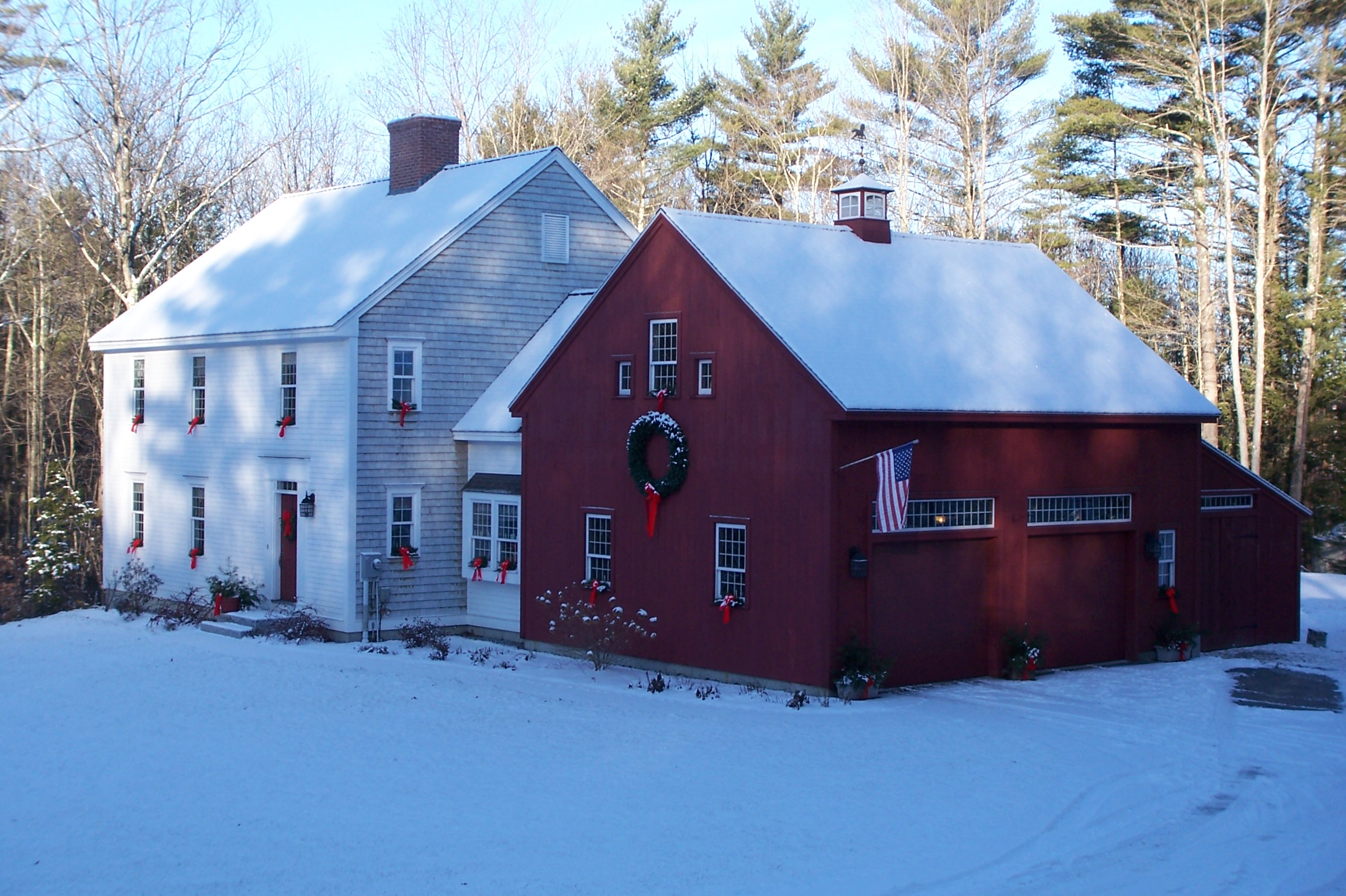

RaT, impressive and unique (at least for myself). I'd really wonder what the heat loss was on that place and what type of heating system that house had, being up in Maine? Usually what I find is they build the "unique" house first, and then worry later on how they're going to heat and cool it.

Actually, that was a solarium. Inside that were insulated doors, foamed walls etc. to go in the house. There were fans to take care of moving air in or out as needed. I was still there in October when it started getting a little chilly. The place stayed very warm. The walls had that foam that expands in the wall and then gets shaved off flush to the studs, the outside had another 1" of foam over the whole place. The roof rafters had 12" of foam. It was an interesting place looking out over Penobscot Bay. Not my type of home, but a great place and great people.

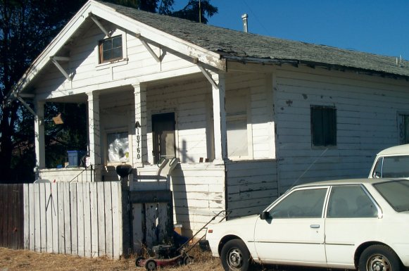

Sigarms
Here is a rental that I did a complete remodel on using Hardi Plank horizontal siding, all the work was done by me and my step-son.
Before and after pics.
