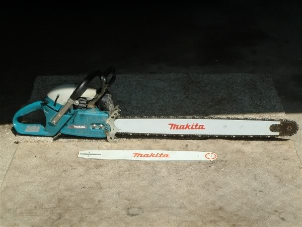

I always heard the later makita dolmars 65-79, they did something to the tank vent because of epa and caused them be prone to flooding.
My older one I owned never had that problem.
I knew guys that sold the newer off becaise it was such a pita for them.
/ "hard to start" #34
View attachment 5492708View attachment 5492709
What would be considered later? I have a 6401 and a 6421 (now a 7921) and haven't had any issues with flooding. I think the 6421 was the last iteration of the Dolmar/Makita series.
Sent from my SM-S921U using TractorByNet mobile app
Not a clue where it started. Do know it was toward the end of times for them. Would have to look it up in their service manuals.
/ "hard to start" #37
@TMGT quick search turned up was carb spring issue in some of them in runs.
From reading old post just a stiffer spring.
CP = Flooding issue has been an intermittent problem throughout the 64-73-79 series.
The fix, from the dealer, has often been to replace the oem spring in your carb with the one in the pic below. This usually takes care of it. I keep a few of these on hand for just this purpose. This is advice I’ve gotten from the oldest Dolmar dealer in the country, and they’ve never steered me wrong.
