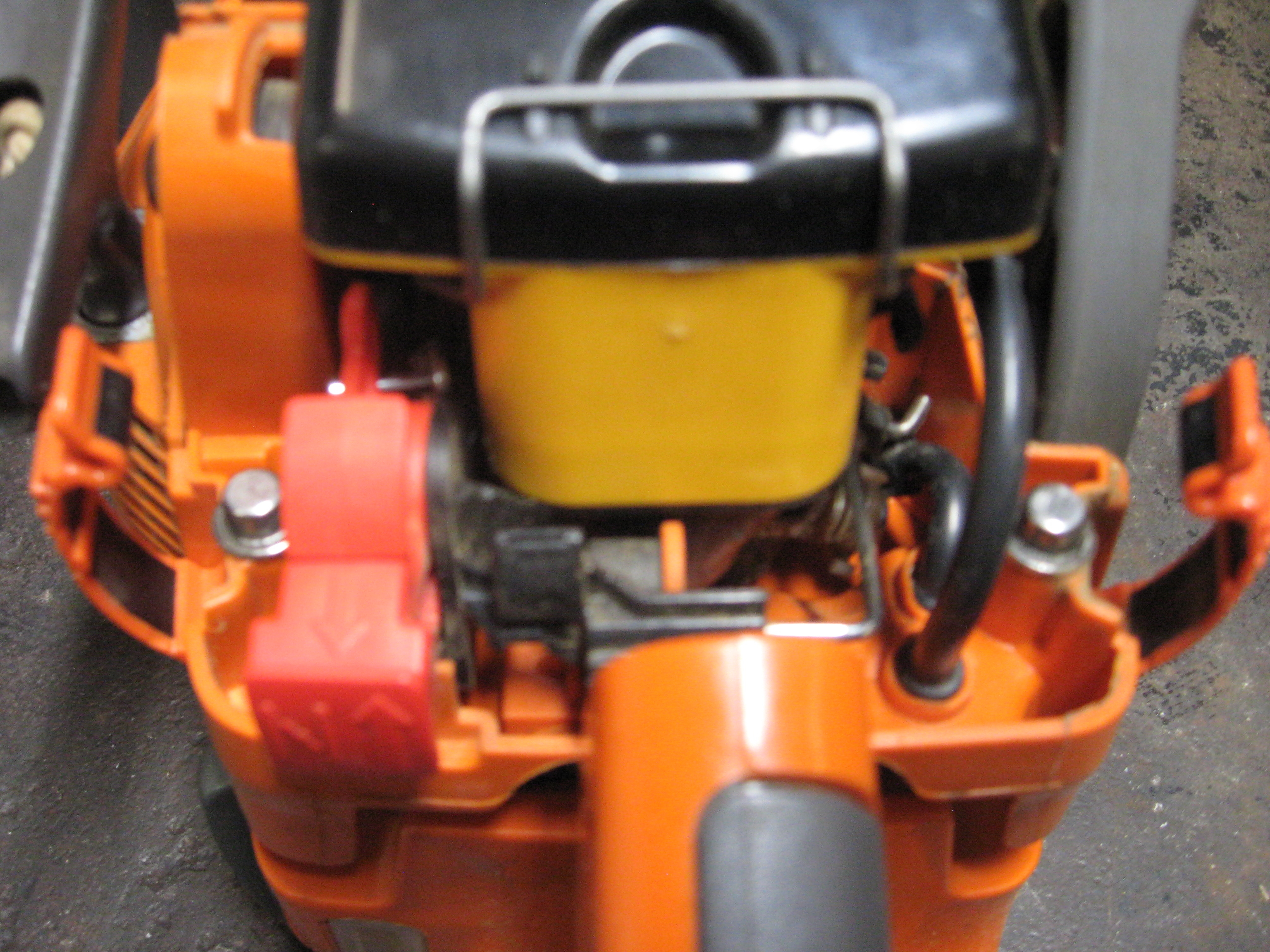

For me it usually takes less than 6 pulls on my MS250 and MS261, and more like 3 or 4. If it’s sat for several months maybe 10. I use ethanol free fuel also.
/ "hard to start" #14
Here's mine. Everything looks good in there to me and I can't see where the gas is coming from. Only when on its side.
/ "hard to start" #16
Turn on it's side like I showed above and look for tank vent I showed.
Everything looks good there too. Turned it on its side on the work bench and no leaky, but in the bush, it leaks when filling the tank.
/ "hard to start" #17
@Runner WAG = Where the tank vent goes into the tank over time can become loose. I had to use Sealall when installing my new tank vent into my last 359 so it wouldnt leak around it.
Could be that. The area of the tank lose it's shape.
With tank pressure of using builds up, if the tank vent going bad might cause what your saying.
Pop the line off and check it. If your tank vent has a line on it.
