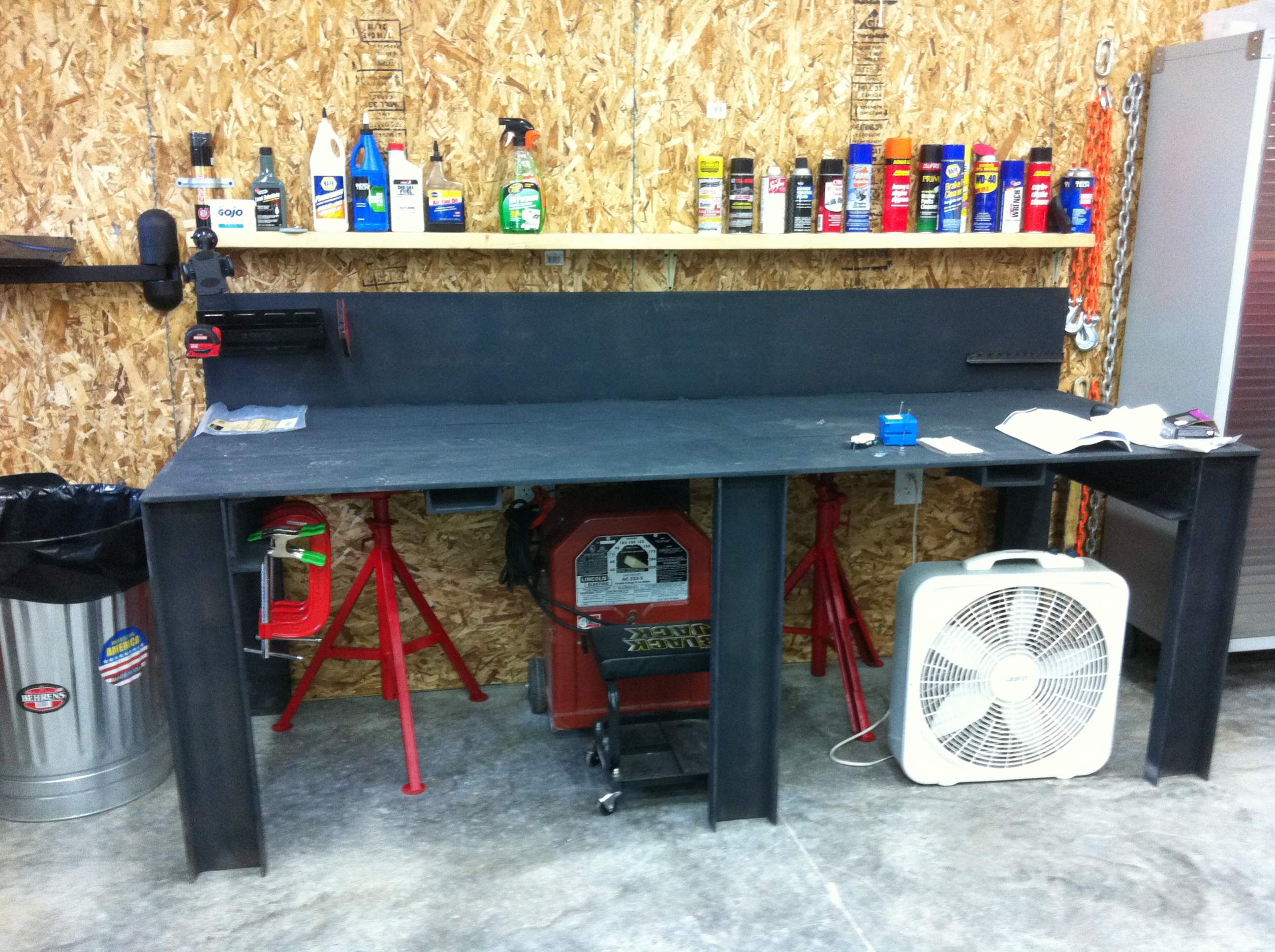

Has anyone used one of these and if so what did you think?
I was thinking of putting one on the corner of my work bench (it is 3x8' 1/2 steel and weights about 900+lbs) and use it to lift trannys, final drives and such up to work on. Stuff that is under 500lbs but too heavy for me to grab off the floor and lift up there. I am not concerned with the bench holding the weight, I would guess it can hold in the 1000's of lbs and figure it is heavy enough to not tip too easily under any normal amount of weight. Just wondering what everyone one thinks?
Here is a photo of each to help:

Using that lift in a truck is one thing. Lots of counterweight.
I could not see in the pic if your bench is anchored to the wall or floor. It doesn't look like it is. Mounting it to a freestanding bench and lifting 400-500 lb. is asking for trouble. That could cause that 900 lb. bench to tip over onto you. If the bench is anchored to the floor and / or wall then in my opinion that lift would work fine.
Be safe. Don't rely on shear bench weight since the leverage of a crane like that could easily tip the bench away from the wall. If you do get it and mount it to an unanchored bench, swing it out the pull down with your hand and I'll bet you will see how easy that 900 lb. bench starts to tip.

I was thinking the same thing and have 2- 6" lag bolts going into the 6x6 wall supports to help keep it from tipping. I guess i could add a bolt or two to the floor also?? Maybe a good idea!!
/ Harbor freight truck crane #4
If you bolt the legs, do it to the back legs, that's where you will get the strength.

I would consider mounting the crane to the rear center of the bench. That would help offset the overbalancing effect of mounting it on the side or front. In addition may give more options on where to place the load.

I already have an engine hoist and I find sometimes I have it "in use" and then want to put something on the bench so this would be a cheap system. Plus I am a bit lazy and don't want to have to roll the hoist over, drop the legs and lock it all together for a quick little 10 second lift ... What can I say :)
I built a heavy duty 4 wheel "furniture dolly" - weights about 100 lbs and is roughly rated for a ton and 1/2, so I often sit heavy stuff on that, roll it over to the bench and was thinking this would be an easy way to swing it up to work on it. Most stuff I put up there is under 250lbs (I love Farmall Cubs and most stuff is not too heavy) but I am getting to old to be trying to hoist it up there on my own (plus i'm too darn short to do it easily!!!)
