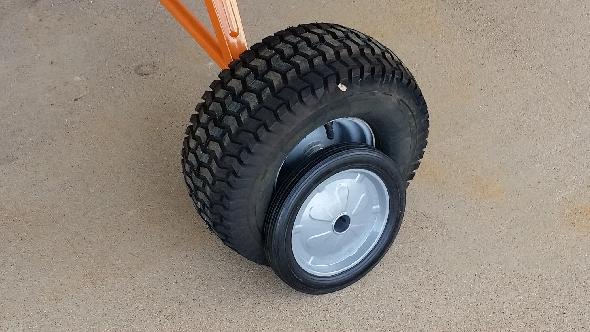

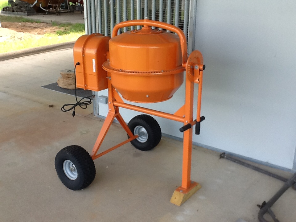

I just assembled the HF mixer. For once the instructions were good and no missing fasteners. I see a big potential problem area with the axle and wheel assembly. The wheels are junk. I determined the tube that is the axle will receive a piece of 1/2" schd 40 pipe. A 5/8 axle most after market wheels are made for is a tight fit . Plan to heat the pipe and drive 5/8 axle stubs about 4" then weld. Add pneumatic tires/wheels and it will a lot handier and hold up under the pressures of heavy concrete. I have quite a few projects for it plus a friend also needs. Save a bundle over rental coats.
Ron
My solution. Had a piece of 5/8" rod and wheels from a recycled fertilizer spreader. It's very easy to move now.
