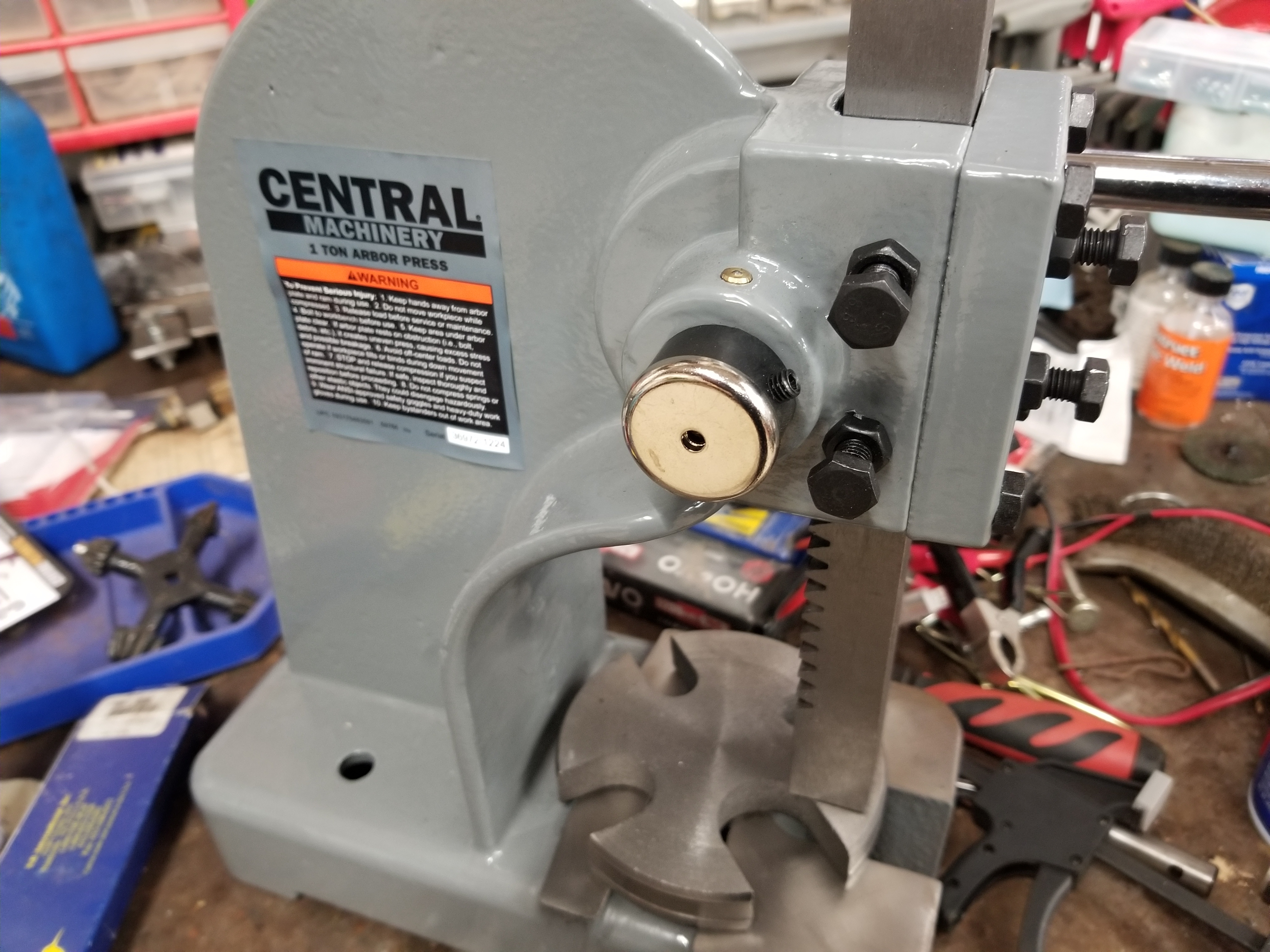

My dumb idea worked as good as I'd hoped... I had these magnets sitting around that are basically small magnet fishing magnets and they're the same diameter as the collar, loosened the set screw and put the magnet on and you can pull the magnet/collar off or pull the pinion shaft out but you have to be deliberate... the ratcheting method is neat and I might do that later but this was easy...
This may not be the place to ask, but does anyone use one of these presses to punch holes in metal? I'm not talking about sheet metal, but specifically, to punch holes in steel bed frames that are otherwise impossible to drill. Maybe 1/4" holes maximum of 1/8" thick steel.
If so, what die set do you use and how well does it work.
   / Harbor Freight Tools that don't suck #15,923
Steel bed frames are typically very hard steel. Most likely a high carbon steel and full of junk. I'd be willing to bet it would take 40-50 tons or more to punch a 1/4" hole in one (if your punch die survived). The frame and die would most likely shatter like glass. Drilling can be done with carbide drill bits, but the frames are brittle and may crack or break at the hole if stressed. It can also crack if welded. The stuff isn't particularly well suited to repurposing. The scrap yard is the best place for old bed frames.
