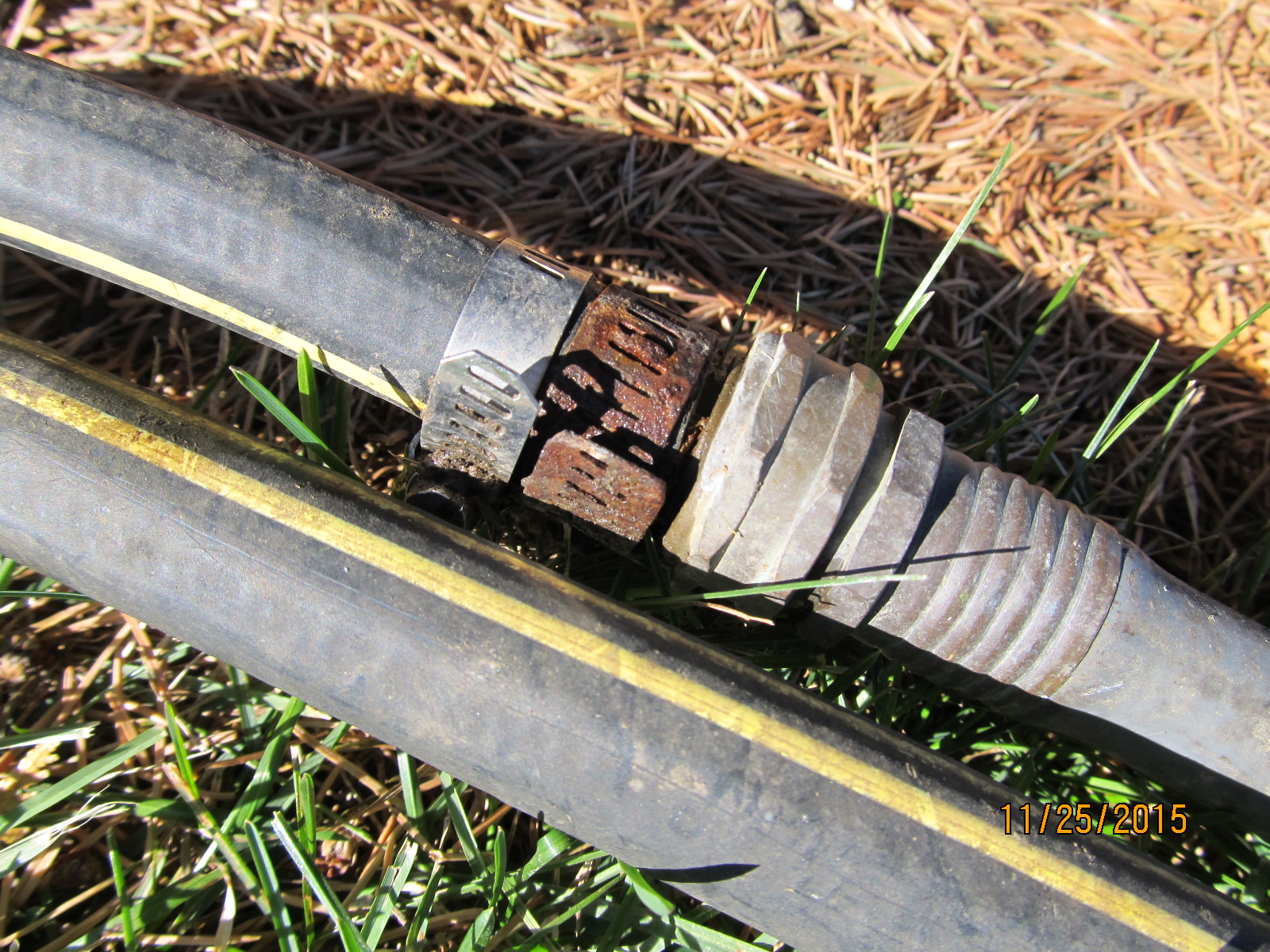

Be careful of the stainless steel hose clamps.
   / Harbor Freight Tools that don't suck #5,716
It may be our water but most clamp bodies last and the screws rust away over time.
My take is that the screws are not stainless due to fact that stainless is not hard enough to torque the clamp tight and maybe our water is slightly acidic.
   / Harbor Freight Tools that don't suck #5,717
Some so-called stainless steel hose clamps are like you say, stainless band and body, carbon steel screw. But all stainless clamps are available, you just have to pay attention when you purchase. Then, as evidenced by the pic, there are clamps that are all carbon steel.
I bought some of the HF clamps years ago. They were too soft to withstand enough torque to stop leaking most times I tried them. Ones that did seal, soon rusted. The rest went in the trash. A well earned "Do Suck".
