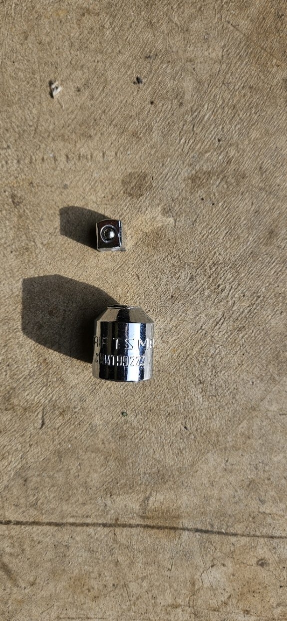

Newer Craftsman, finished the job with the HF one, no problem, just the ratchet head was useless

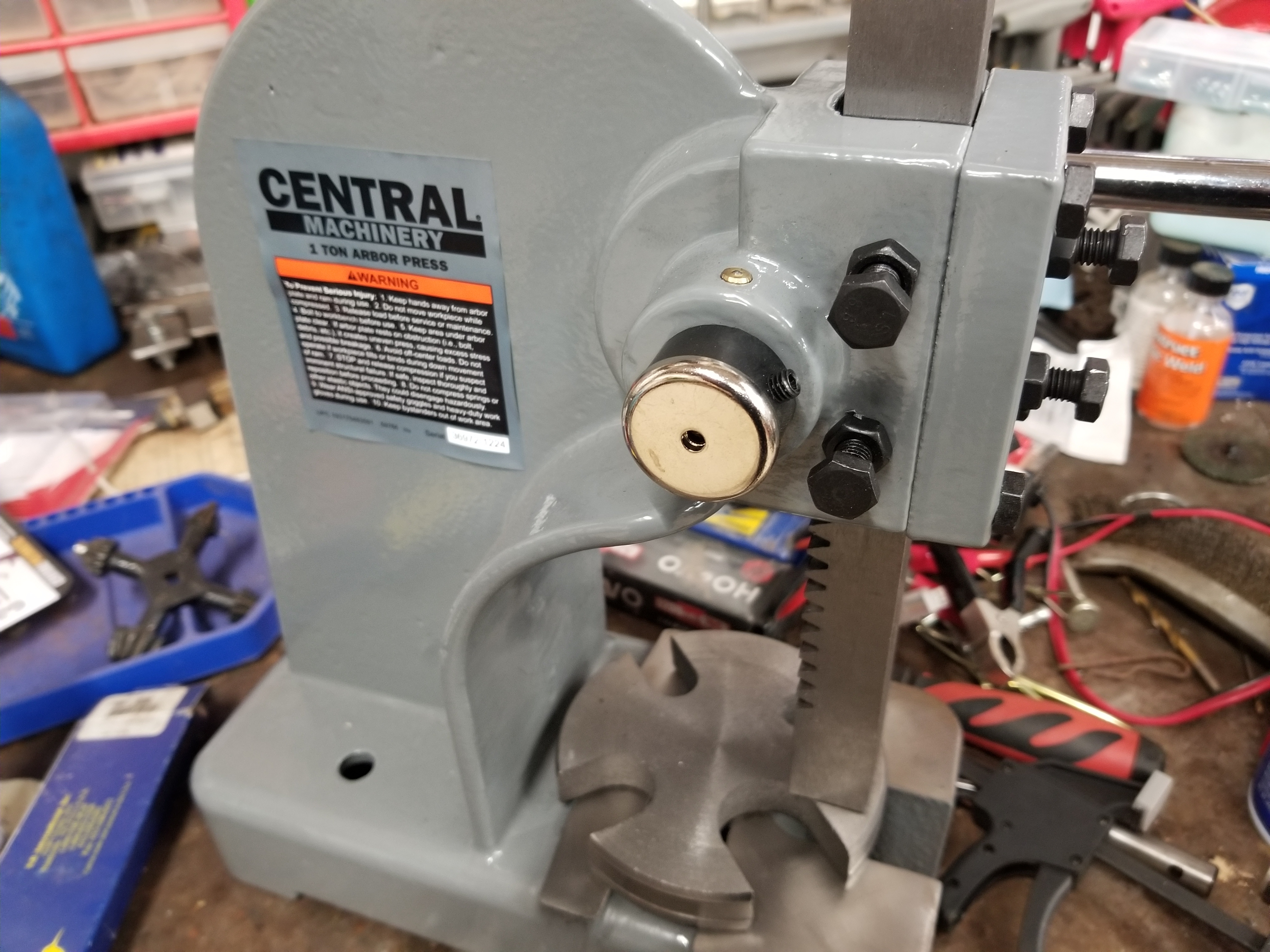

I talked myself into a HFT arbor press the other day and I don't think it's bad for the money. It only took me one use to realize I don't want to use the locking collar on the end of the pinion shaft, it would be way handier to index it for each use instead of having the handle vertical... looking at the reviews on their site it looks like when they increased the price they addressed some of the complaints, the rough lathe work on the rotating plate doesn't bother me one bit, it's cast iron, you'll get that... With the 15% coupon this weekend it was only like $68 so not shabby... most on Amazon and such are around $100...
A common mod on the cheap arbor presses is to remove 1 or 2 teeth at the very bottom of the shaft. That way you can rotate the handle without moving the rack when it's all the way up. So you can index the handle so it's at the optimal angle to lean on it where you need it.

One video on this subject is informative as well as entertaining happens to be by This Old Tony. Skip to about the 12:00 mark to bypass some needless comedic drivel.
That's interesting, I'll keep it in mind, I have a dumb idea for the stock lock collar involving a magnet... not sure why that guy removed the front plate to pull the rack instead of just pulling out the pinion shaft and lifting it out? whatever :). modifications are for later, I have much bigger fires to fight currently but they're good ideas I'll likely do sometime.

My dumb idea worked as good as I'd hoped... I had these magnets sitting around that are basically small magnet fishing magnets and they're the same diameter as the collar, loosened the set screw and put the magnet on and you can pull the magnet/collar off or pull the pinion shaft out but you have to be deliberate... the ratcheting method is neat and I might do that later but this was easy...
