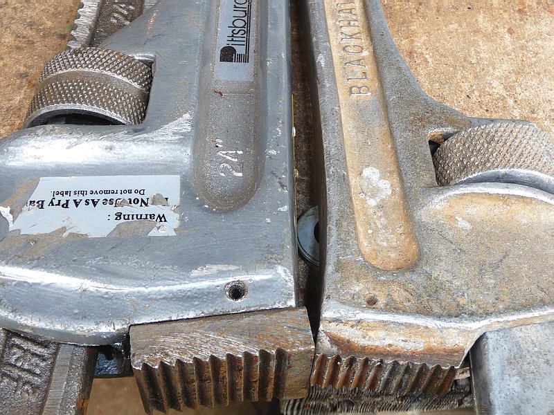

I like my HF aluminum 24" pipe wrenches but the teeth are starting to get mashed flat after my first project using them replacing several ancient water lines.
In contrast the Blackhawk 12" wrench I bought in 1966 - nearly 60 years ago - hasn't accumulated much more damage than that.
Don't use a cheater pipe to extend the handle of any aluminum wrench! I broke the last 3 inches off the handle of one doing that. I've read this is a firing offense in the world of professional plumbers.
p1660380rpipewrenchteeth-jpg.268106
