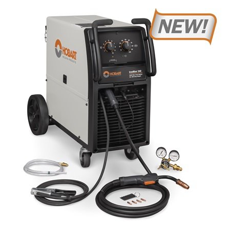

Thanks guys
Think i am going to wait untill Christmas to get myself a Hobart Ironman 240, it looks like Millermatic 252 without digital readout. IronMan%20240%20Package.jpeg
