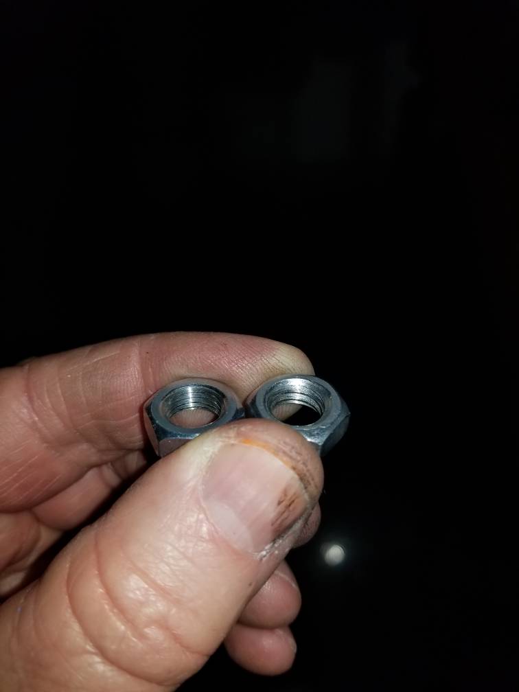

I started at the throttle at moved in the direction of pull. And hard attach point should be 4-6 inches away. I don't see anything obvious.
Started looking
   / Hand throttle for 2016 RTV X1140? I can't find one....Is it a unicorn? #92
Don’t know what to say. Cable has to be held stationtionary
#93
I'm more than a little perplexed. None of the pictures in the "directions" look like x1140. But that's not that unusual.
Maybe if I have time, I'll run it down to my dealer and see if a service guy can show me where it goes.
Thank you for looking.

I was going to put the jam nuts on the cable so I don't lose them.
Ha! 2 different thread pitches from the kit. I'm not doing good at all. lol 20180304_162909.jpg
