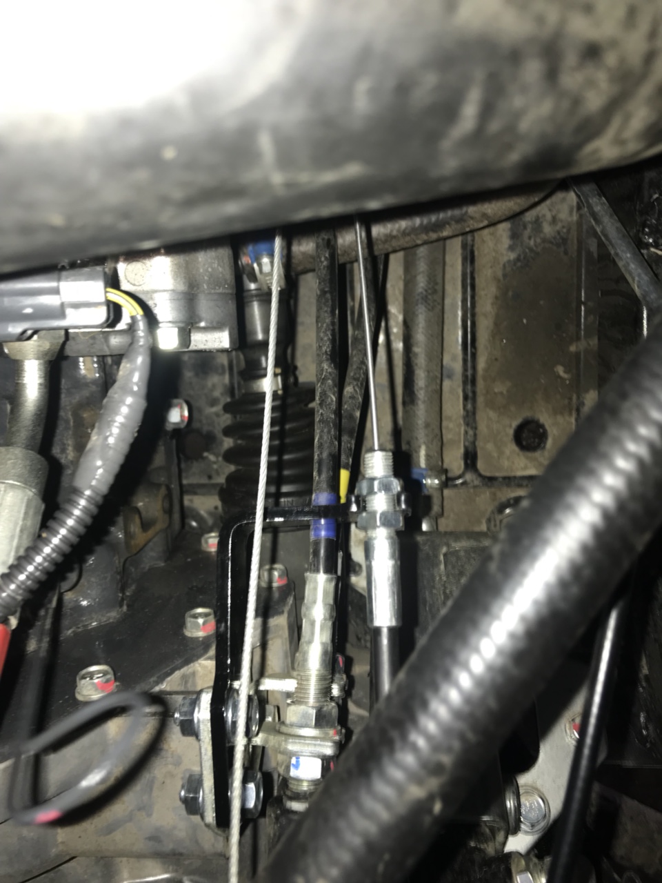

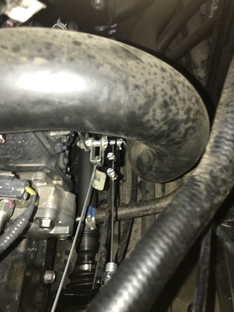

Here are pics of the pump end of the cable
This is the bracket you attach with 2 bolts that holds the throttle cable
View attachment 542068View attachment 542069
Steve, in the south end of your photo, what is your cable sheath attached to? I have my kit and I can't find where the sheath end is secured. The kit didn't come with a bracket to secure that end.
I made a plate to cover up the hole that was left after peeling back the sticker. I peeled the wrong end and it trashed my sticker.

Yes there is a bracket to secure the cable between the two nuts on the end of the cable.
It’s tough to see in the picture but it’s in there
   / Hand throttle for 2016 RTV X1140? I can't find one....Is it a unicorn? #79
Look at bottom center of pic and you can see the two bolts that hold the bracket to the transmission housingIMG_1914.JPG

Yeah, I can see part of one of the forks..
Hmm, my kit doesn't even list any sort of bracket.
