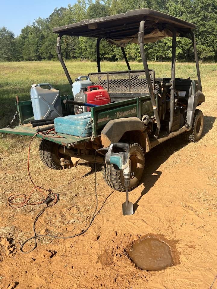

One of the super handy attachments for the SDS Max is a shovel. It doesn't matter how hard my red clay is, I can jack hammer through it with my SDS Max shove tip and create a hole big enough to hold a bucket full of water. I give it a day or two, or even come back the following week, and it's easy to drill with my auger. In the heat of Summer, it's the only way that I can keep moving forward with fencing, and get the holes drilled for my wood posts.
